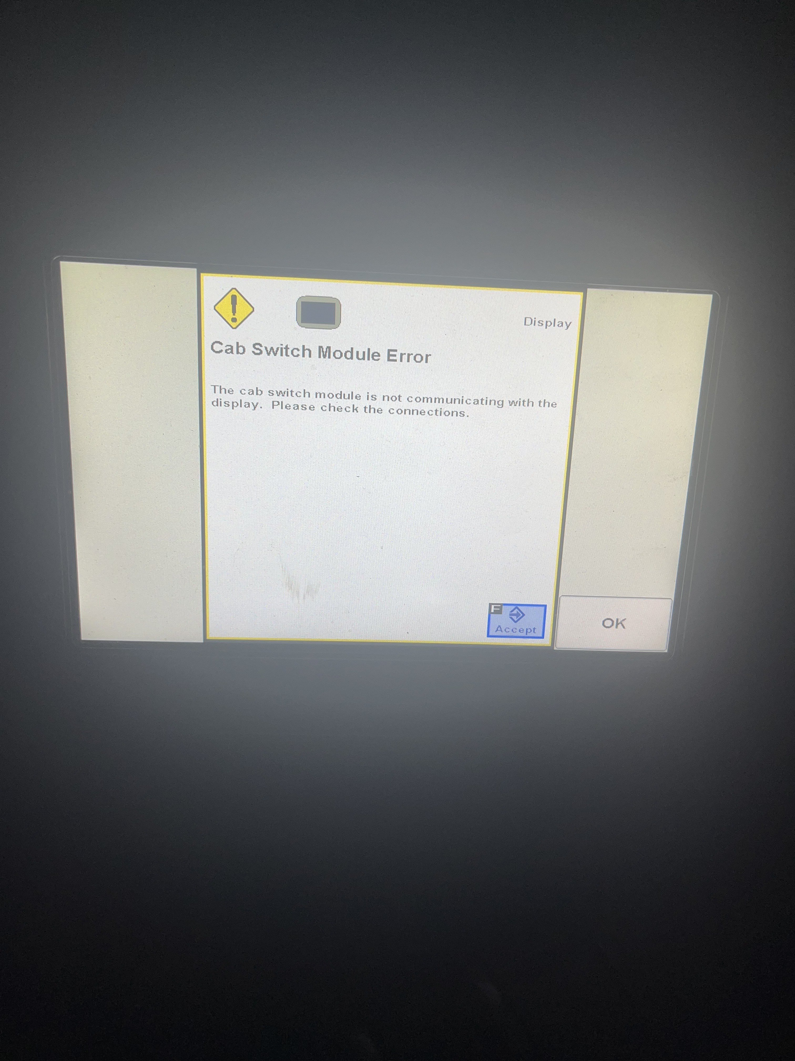

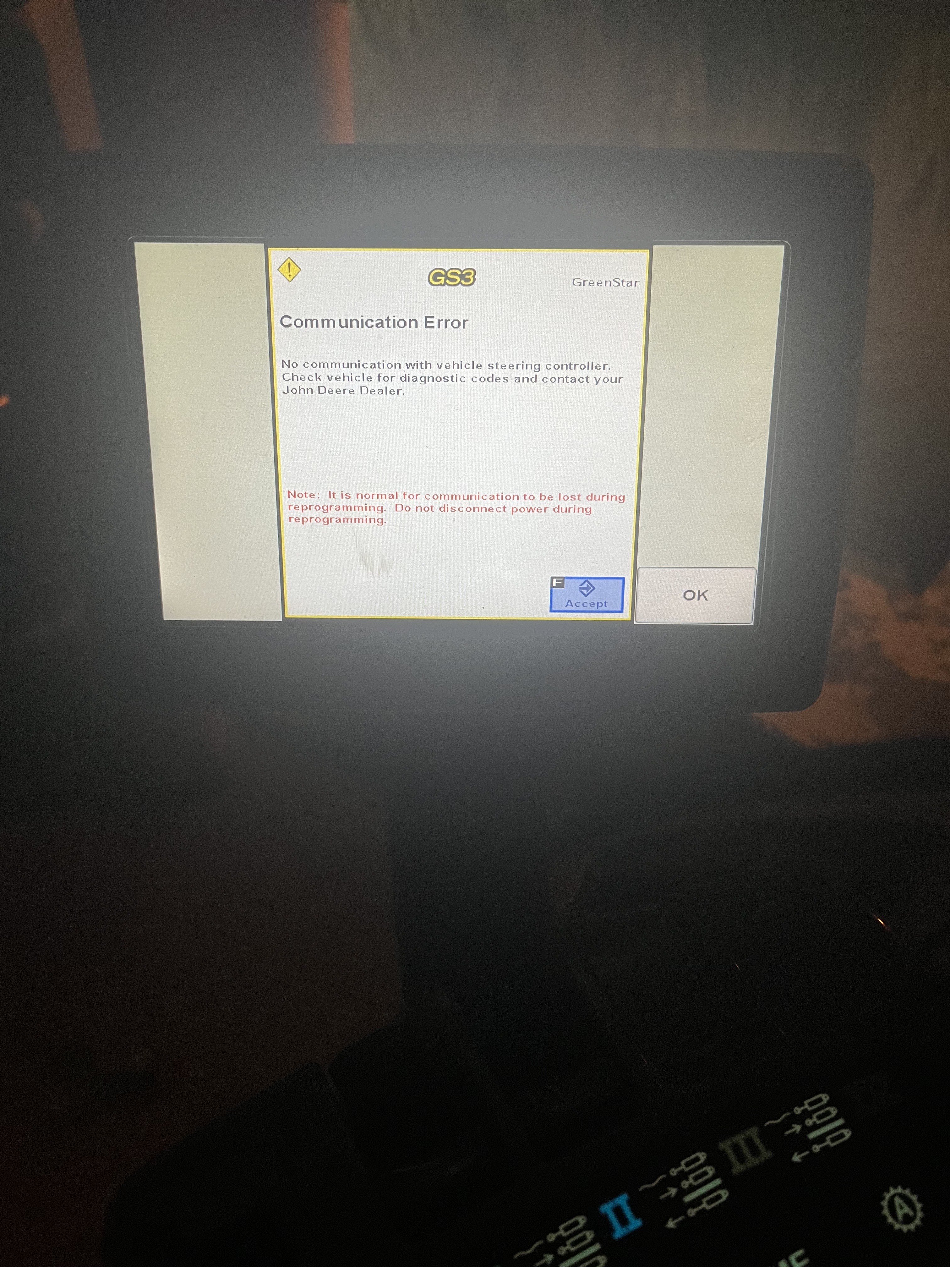

Having issues with our 9360r tractor, electrical problems. Randomly the monitor will beep at the operator saying either "cab switch module error" or "communication error". The machines electronics will then act randomly such as hazard lights turning on by themselves, corner post display turned off, arm switches don't work anymore, and the machine will stop and put itself in park both in the field and on the road. Sometimes all of these symptoms happen, and sometimes just a few. Doesn't seem to have much of a patter to it.
The machine will run fine for hours, even days but then randomly will begin to have this problem and will get worse and become useless. Then, it eventually starts to act fine after a few hours of shutting off the engine and letting the system reset.
There may be a connection between rough roads/fields and the issue becoming worse. We're not sure if it works a wire loose or something but it seems after driving over rough roads or in a rough field the issue will pop up and persist for hours to days. Attached are photos of what the display shows as well as a step by step story of how one of the operators described their experience when it went off on them. Would really appreciate some help if anyone has delt with this as well. If it helps we've already tried switching the arm rest controls between this 9360r and our 9460r hoping that the arm rest controls were the issue, but the problem still persists.

The fact that the issue gets better for a while when you turn cycle the power leads me to believe that the problem is a connection issue with a CAN terminator, or the terminator itself. Start with checking the resistance on the CAN involved with these controllers. There is a 120 ohm resistor at each end of the circuit, gives a total resistance of 60 ohms. The terminator serves to prevent the electrical messages from reflecting back at the end of the harness. If one is not connected/working you get a build up of signals confusing things. Hence why the power cycle helps.
Beyond that, the best thing to do is check for any related stored codes and see if you can sweet talk your friendly local JD service manager to do a DTAC search for those codes. The search might kick back a common cause.
All that said, network issues can be frustrating to find, and are not always caused by logical issues. I once had an 8x20 tractor with a pile of transmission codes, turned out the fuel transfer pump was the culprit. Drunk aunt Myrtle was talking trash on the party line!
