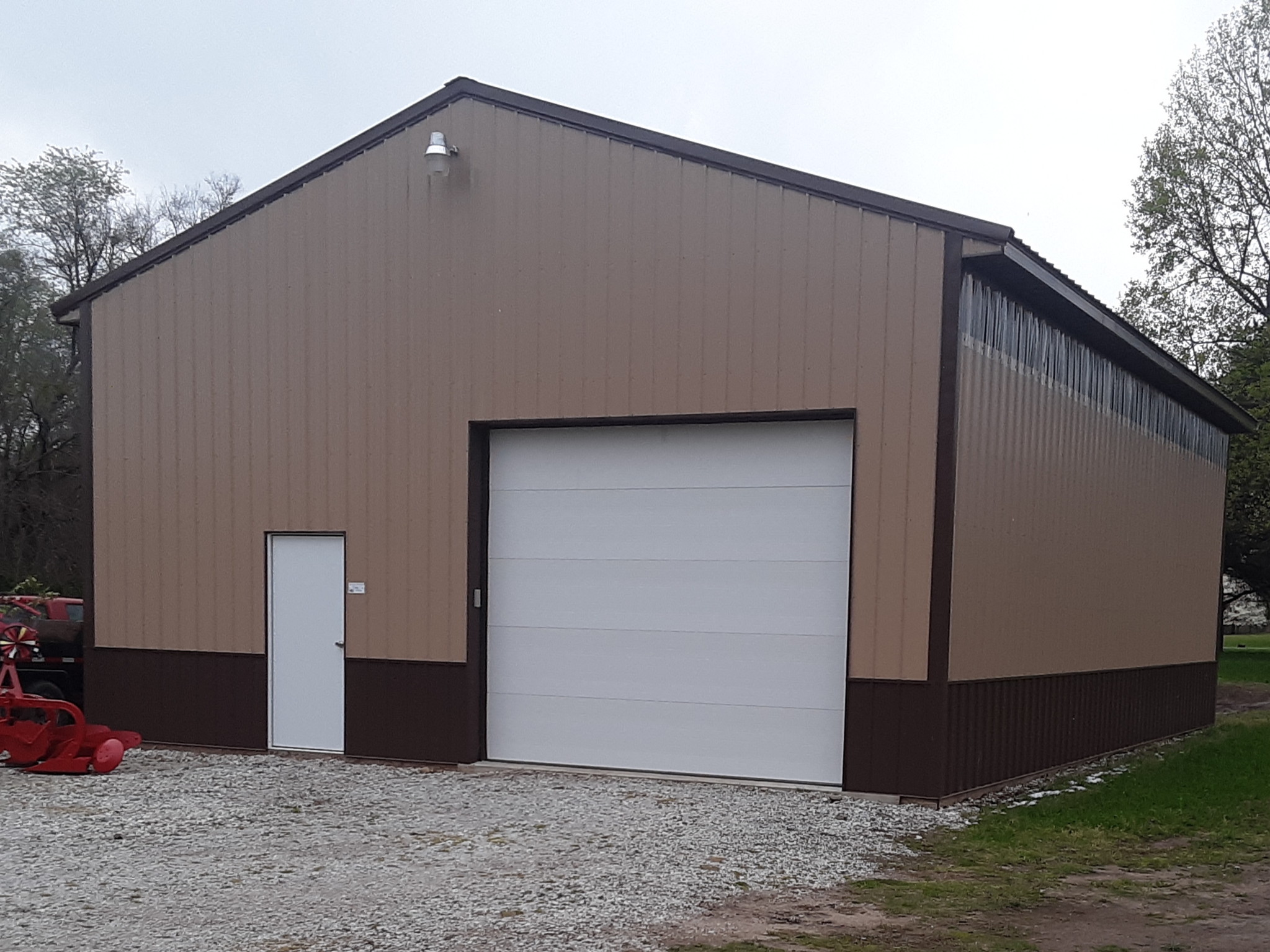

I did the ground prep and an Amish crew took 2 days to build a 30x40x10 pole barn.
I wanted vented eves and clear panel under the eves. View attachment 112356

Ray, that is one great pole barn, thanksWhichever pole barn DIY design you decide on, I highly recommend using a ridge-pole skylight. I have one on my 60'x40'x15' pole barn and I really like how much natural light it allows. This is with doors closed, no windows. I hired DC metals to build mine.
