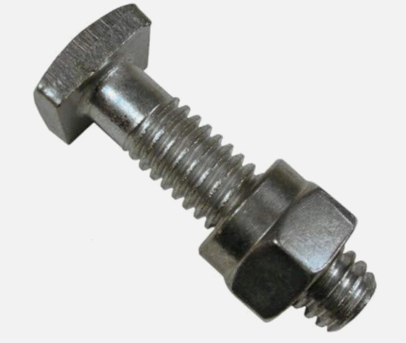

So a question on the cables...the original parts are no longer produced. Anything I need to know before making my own or have some made? Gauge, conductor type, etc.? I assume I can remove the old cables and start from there. It seems like the clamps are too big for the posts used on the 34/78 battery. Am I good to go with the Group 48 size and do these different sized batteries have different post sizes?
Frustration is that the nuts for these were near impossible to grab with a socket. I'm going to try to find better clamps with more easily accessible nuts...

I generally use box end wrenches on the nuts on battery cable clamps as there is not clearance enough for the heads of my ratchets to allow straight-on placement of sockets. Post type clamps are about all that way. Get clamps with actual battery nuts, those have a shouldered area to space the hex away from the clamp a bit.
1/0 cables will be fine for a MF 135 diesel engine.
If the old cables reach, they can be used as patterns to make the new cables by. Use crimp on or soldered on cable ends, not the clamp-on type battery post ends.

I add a flat under that nut to prevent it from wearing into the clamp.
