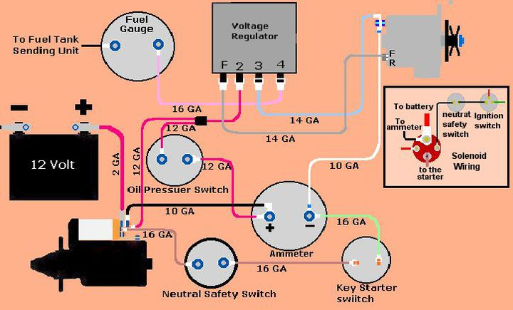

Im having a problem with my MF-175 diesel. I posted earlier about it not charging and was told to check the oil pressure switch. I discovered the wire going from the oil pressure gauge to the regulator was bare and touching the steering column. I replace the wire with new. I also notice the fuse under the dash was blown. I eliminated the fuse temporarily and connected the 2 wires. Now when I turn the ignition switch nothing happens. Nothing. I made sure both transmission levers are in neutral. I've also replaced the voltage regulator. Still nothing. I jumped the starter and it turns over but when on turn the ignition switch nothing happens. Shouldn't I hear something fron the the system to the oil pressure switch when the ignition is turned ? I've even disconnected the line at the oil pressure switch and nothing comes out when I turn the ignition switch. Im at a loss. Please help

Your MF 175 diesel did not come with an ignition switch. It should have a key type start switch which only is used to engage the starter. This circuit should be seen on the wiring diagram in your Operator's Manual. The oil pressure switch turns on the fuel gauge and charging, after oil pressure from the running engine closes the contacts in the oil pressure switch.
FIRST thing to check is do you have battery voltage at the key/start switch? One side of the switch should be battery live regardless of the wiring to and from the oil pressure switch. Since had wiring issues elsewhere and have disturbed things to some degree you may have affected power to th key switch.

It is a starter switch. It should have power all the time on one wire (the green one I believe) and the other wire carries power to the neutral safety switch to energize the starter when the switch is turned to start. Original or not means nothing, Test for power.
Have you looked at the wiring diagram so you can see where to test for power?

Yes I've tested for power and there's power all the was through the neural switch to the solenoid. But I don't know where the brown wire goes to. Maybe to the alternator or other side of the solenoid . I won't be able to check it til Monday
Brown, tan, gray? The problem with just saying a color to chase is that colors can fade over time, and you cannot be 100% certain the function of that color wire is the same as the one on the drawing. Colors were sometimes changed during production. Finding both ends of a wire is key.
If you have power through the start switch and neutral safety switch to the solenoid, it sounds like a battery cable, solenoid, or starter issue, if it will not crank. Be sure the tractor is in neutral and use a jumper wire to make contact between the battery cable post and the start terminal of the solenoid. If it cranks the starter, you may have a switch or connection that shows voltage but will not handle current enough to energize the solenoid.
Do you know what alternator your tractor has on it? Is it a Delco Remy with a separate external voltage regulator (10DN) or a newer one or three wire type Delco(10SI)?
Other than the battery cable post wires and motor connection, a diesel should only have the wire from the neutral start switch on the solenoid start terminal, the other small terminal should not have anything on it. That terminal is used on a gas engine to provide a resistor bypass for the ignition system during starting.

I've made changes to the wiring to match the wiring diagram. The tractor now turn over and starts. The battery is not charging. There is humming coming for the voltage regulator for about 5 seconds after the tractor is shut off. The voltage regulator has already been changed.
