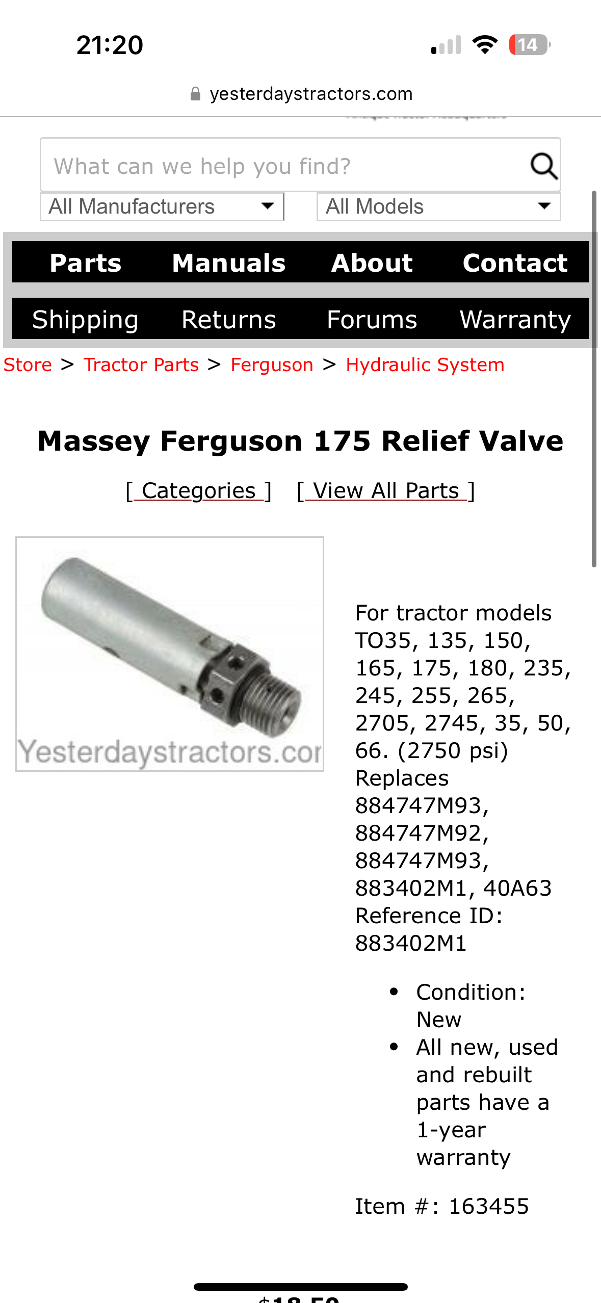

The pressure control valve line is where the bolt is welded in place, I suspect the adjustable pressure control valve has been removed. There are TWO standpipes available, a PLAIN one for tractors WITHOUT the pressure control option, and another with the small block/line that feeds the pressure control valve.I ordered a new standpipe, is there a line that connects to it? Didn’t see one free floating in there.
That will work IF a safety pressure relief valve is ADDED to the hydraulic pump since the adjustable pressure valve is not being used.Would it be bad if I just a put a plain standpipe being the valve is possibly removed? Just need the hitch to go up and down.
That should work.As of right now this is the only pressure relief valve I’ve seen. It’s located on the pump above the strainer.

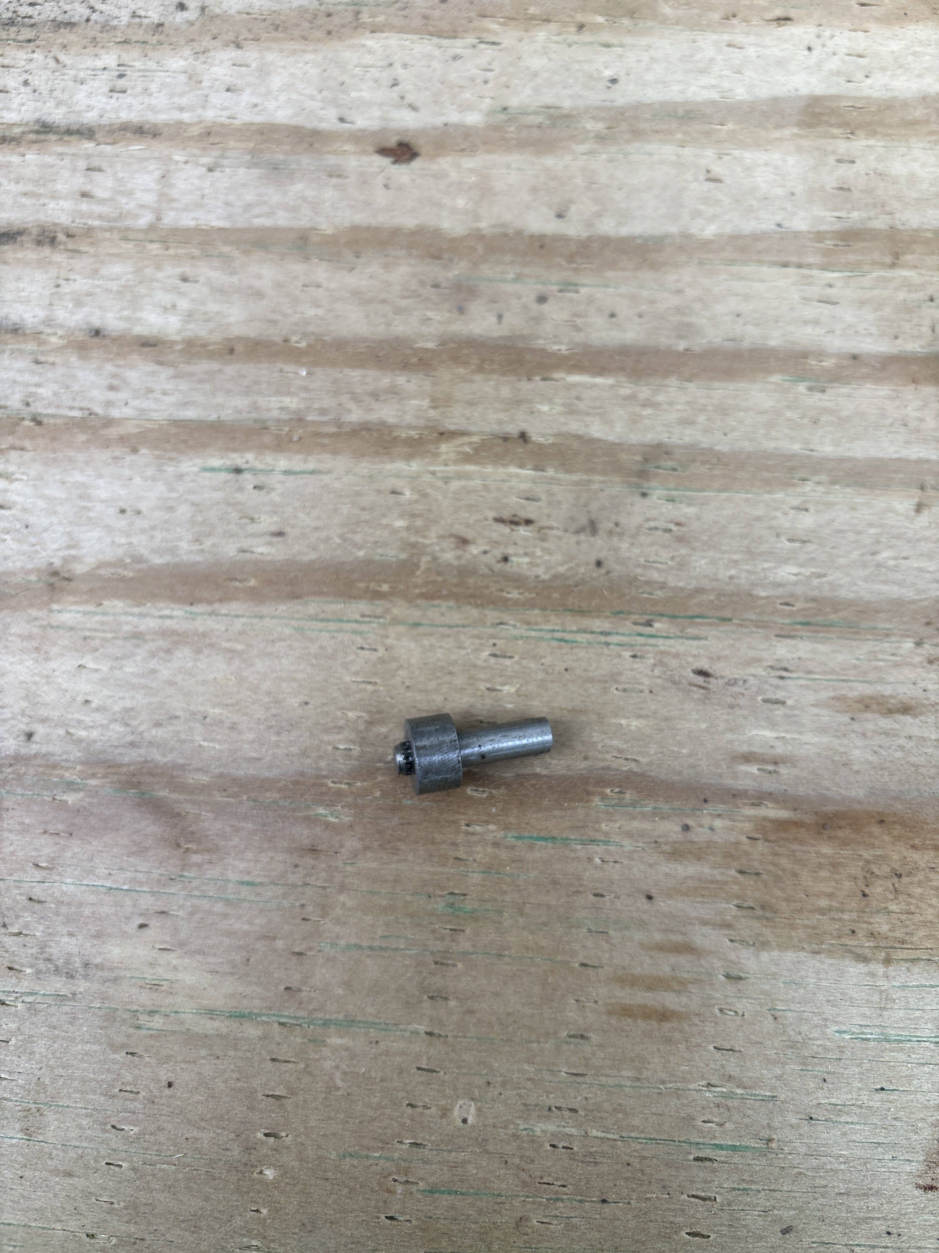

Hello Farmboy, welcome to YT! I am not a Massey guy so I can’t help you. That looks suspiciously like the end of a hydraulic spool valve. I’m not sure if Dieseltech was just focused on that standpipe/pressure relief situation and said nothing about this. I would certainly like to be assured of what this is before you put it back together. I tried a quick glance through the online catalog but no luck. I will link it incase your not aware of it. Maybe try a post on the Massey Ferguson forum in the Manufacturers section.Metal piece that look like it sheared off.
