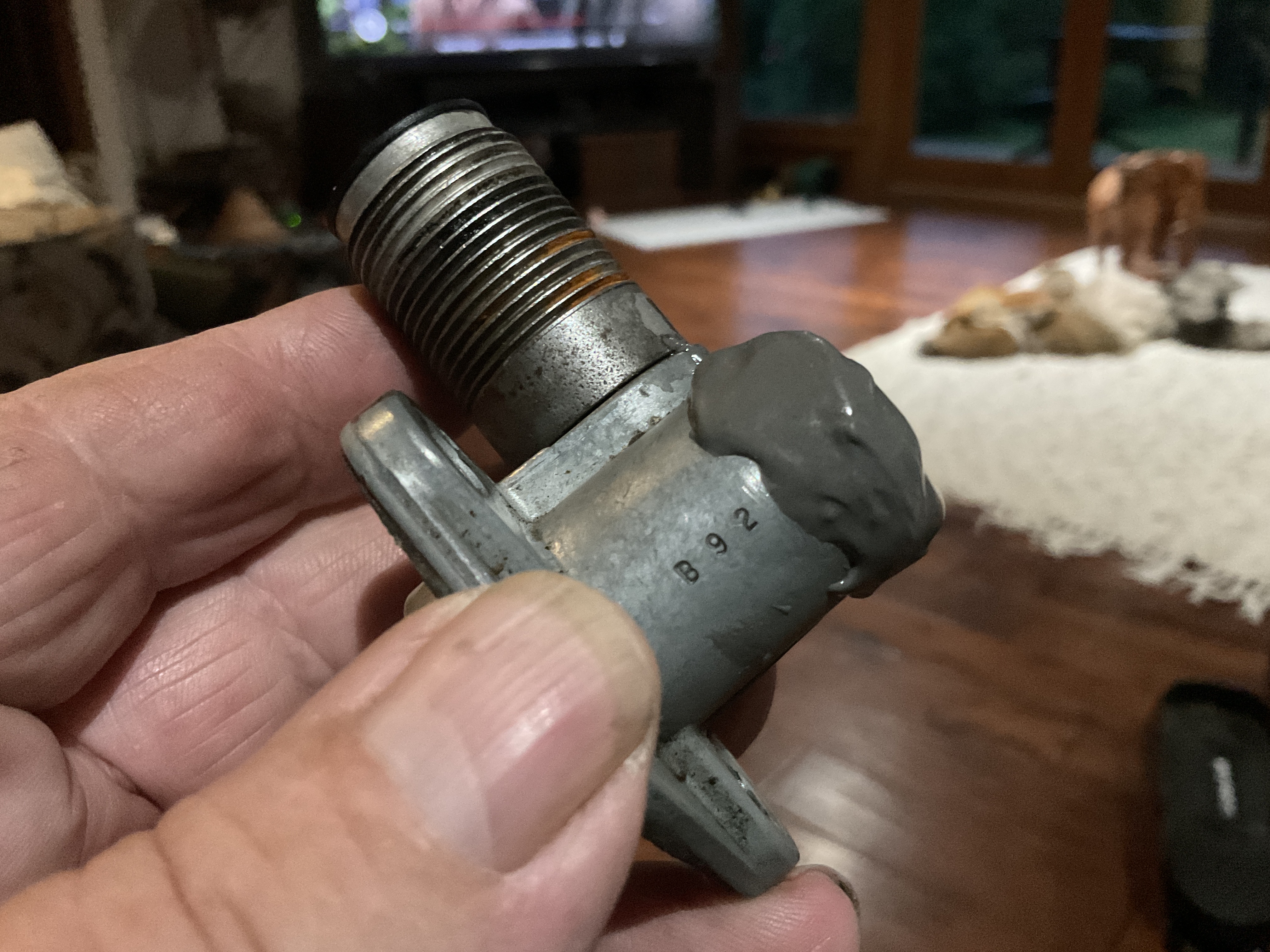

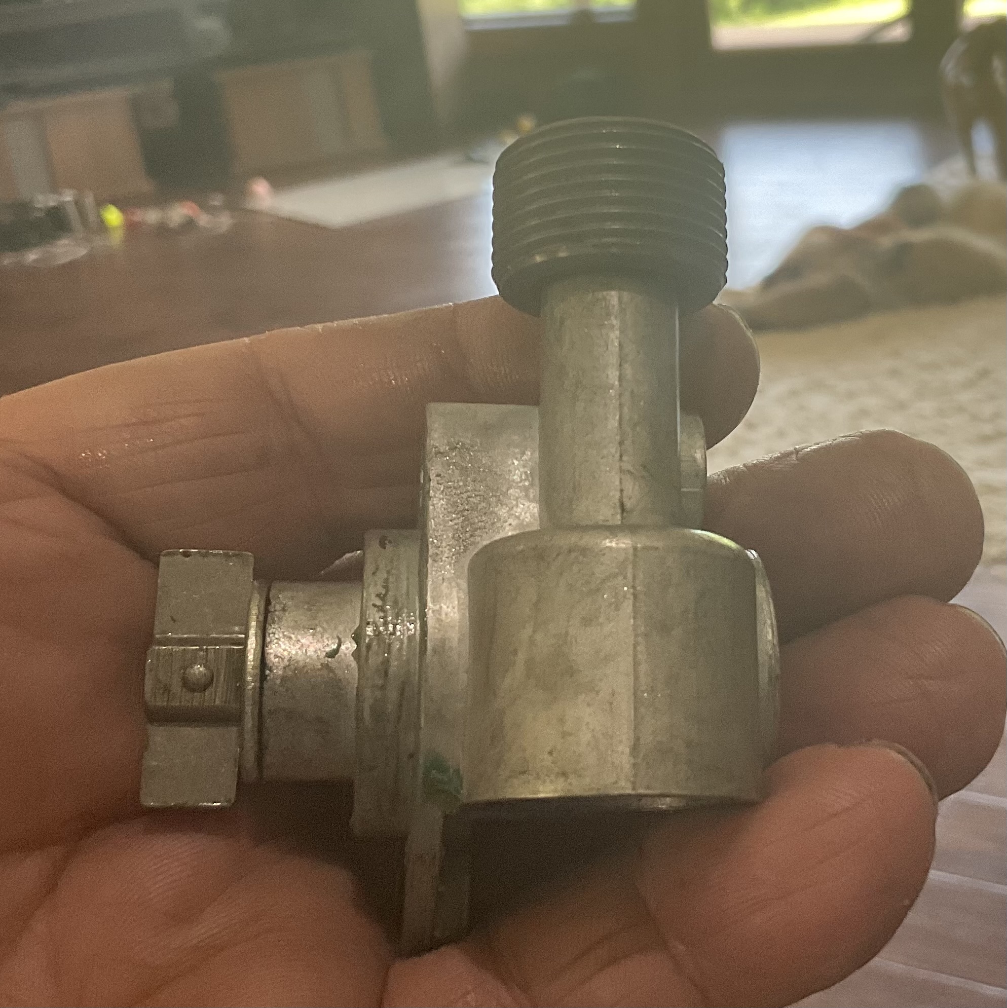

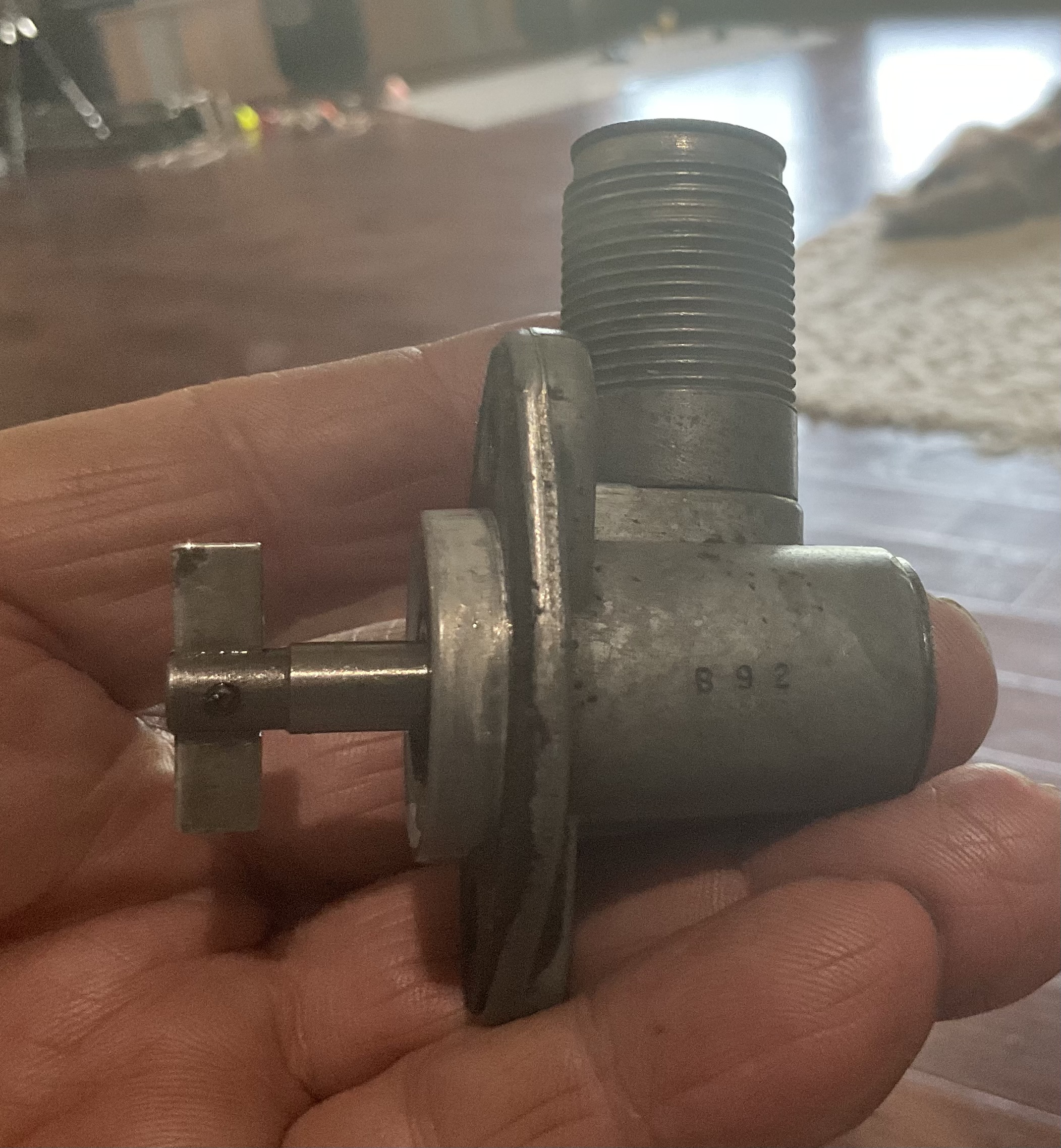

Massey 255. I bought a new tach drive 535126m93 to replace 535126m92. It is supposed to fit directly. It will not quite go all the way in. Looks like it hits that washer behind the paddle driver. No way to get the washer off without destroying things. Everybody in the world claims this will work. Anyone else have this problem?
it is an aftermarket. I went ahead and fixed my old one. I should’ve done that in the first place. The cap kept backing out and letting the paddle come out of the end of the camshaft. I roughed it up with sandpaper and JB welded a cap on it so it cannot back out anymoreimage.jpg
