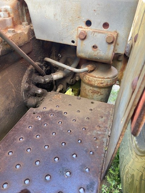

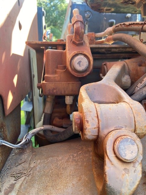

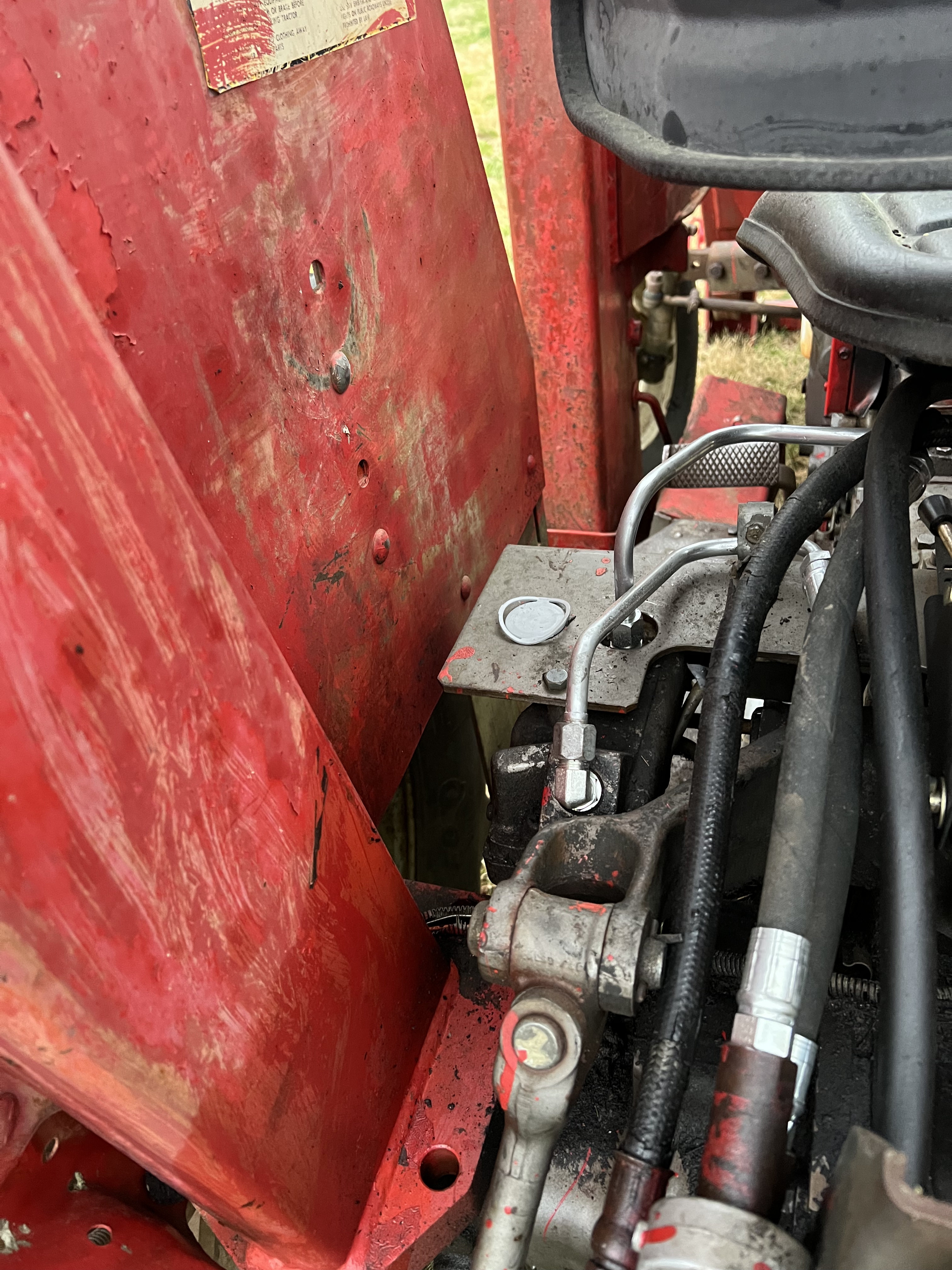

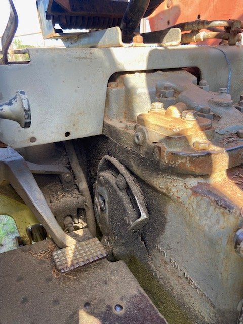

Thanks for hanging in there with me - pictures attached
It appears that the hyd hoses from the loader move back through the hyd controls and then directly back to the "pump" on the left side of the drivers seat (near the PTO lever). I see nothing on the right side of the seat near the dipstick.

Yes, the cover is directly at the bottom of the housing , the oil must be drained prior to removing the cover, or you will have a mess.
There is no pump left of the seat. There is a single spool control valve, mounted under the plate below the seat, which is operated by the handle next to the seat on the right side. The other item in your picture, located further down behind the footrest, is the hydraulic filter for the auxiliary hydraulic system. The standard and auxiliary hydraulic pumps are both internal of the tractor, inside the differential housing. Those tubes attached to the cover, that has the PTO lever, are carrying fluid associated with the auxiliary hydraulic system. More pictures of the plumbing from the valve by the seat to the loader up front, may help us see how it was plumbed. Is there a control valve on the loader?

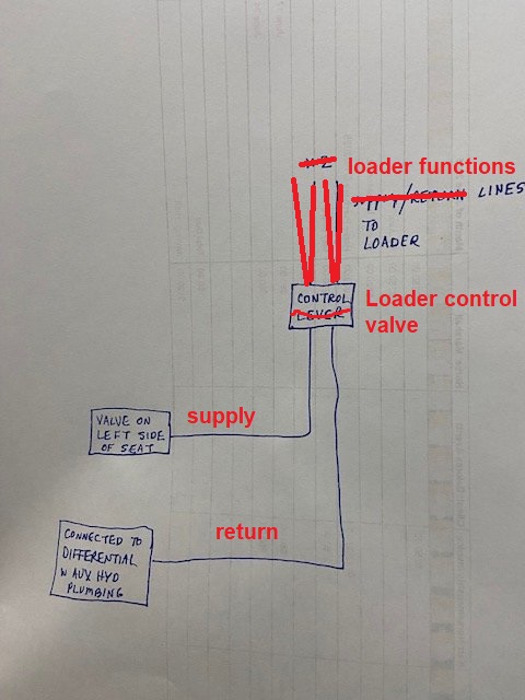

Thank you for taking time to mark up these photos - see very simple diagram of the hydraulic setup and a picture of where the hoses are connected that supply hydraulics to the loader. I will have a service manual in hand this afternoon and may be able to speak to this issue with more specificity. I did check and I do have the cover with 3 bolts under the diff.

I do not see an answer to: "Is there a control valve on the loader?" I am guessing there is. I am also guessing the auxiliary valve must be locked in the detent position to supply the loader control valve. If the lever on the right side of the seat is moved to the centered position of the aux valve the loader would not work, if this is right.
In your drawing, if the control lever is intended to be the one at the right of the seat it is the control component of the aux valve, it is not in the hose routing.
I should have been more specific when labeling the "control lever" in the drawing - this is intended to depict the control level (raise/tilt) for the loader. A picture of this device is below. Does this answer the question on whether there is a "control valve"? There is no other device between
the loader control valve and the tractor, just hoses.

So, it has a control valve with control levers for the loader functions.
The supply and return lines are on the auxiliary valve and pump side of the loader control valve. The loader functions are where you show supply/return lines to the loader.
Terminology is going to be important in helping you.
More like this.

This your picture.
I believe the lever inside the blue rectangle is connected to the remote valve on the other side of the seat. As Jim said, the hydraulic flow is through that valve to the 2 spool valve on the loader upright. The valve under the seat must be locked in one of the detent positions. If it returns to the neutral position, there will NOT be any flow to or through the valve on the loader. This has nothing to do with the 3 point hitch. That works off from a different pump. Te position and draft levers for the 3ph should near the lever in the picture.

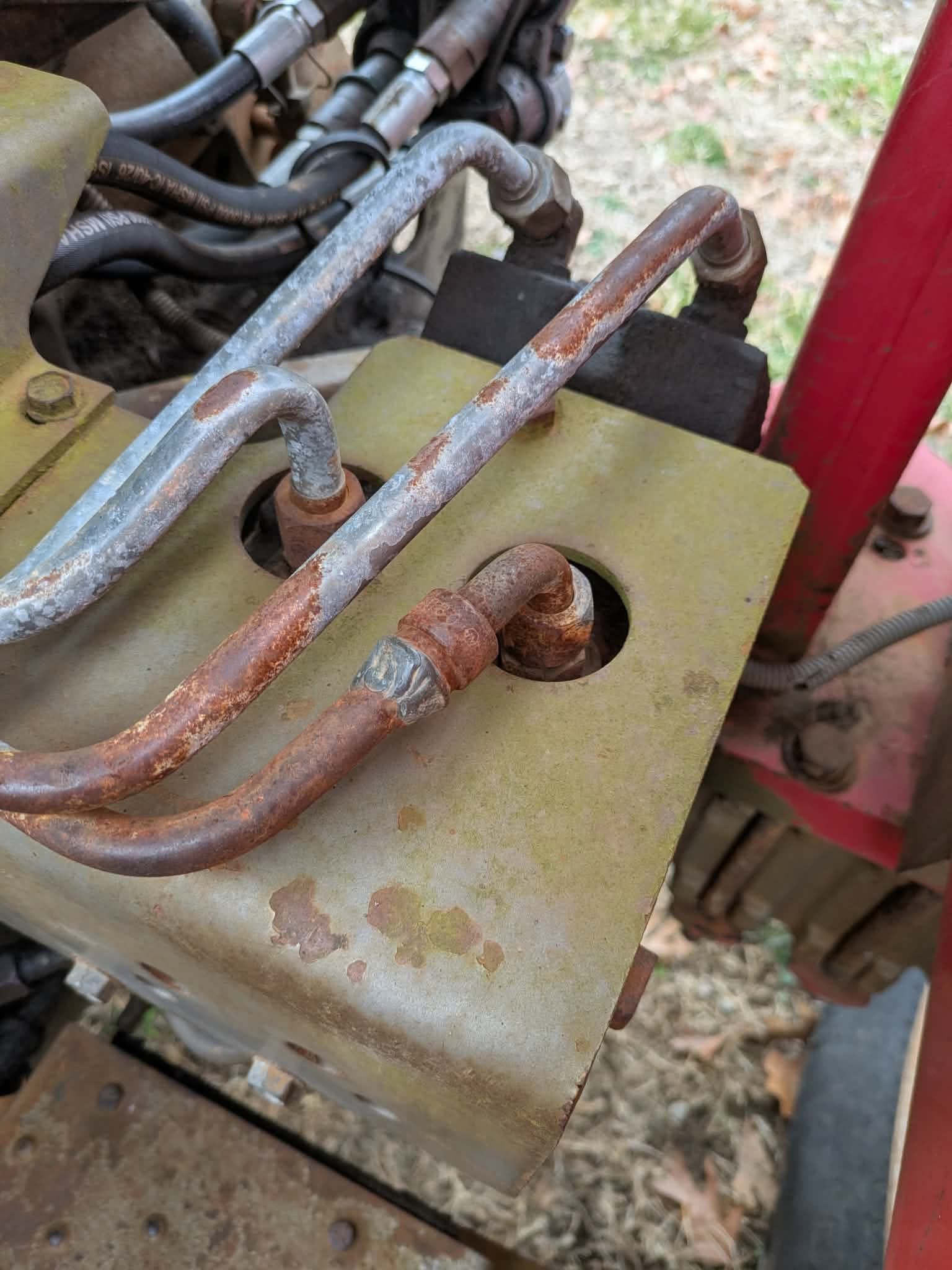

Hey everyone,
I’ve got a 265 with the single hookup valve like the one pictured below, and I’d like to convert it to a dual hookup valve such as the other picture attached. Right now my loader occupies the only hookup, and I’d really like to have a free set of rear hookups for other attachments.
Has anyone done this?
Is it doable to convert to dual, even with the loader taking the existing port?
And does anyone know the part number for the dual hookup valve?

I don't think you can convert the single spool valve to 2 spool valve. You can replace the single spool valve with a 2 spool valve if you can find one.

Hello Kevin, welcome to YT! From what I see in the online AGCO parts catalog, you will need the serial number of your tractor to acquire the correct PNs. There are early and late versions of that tractor.
