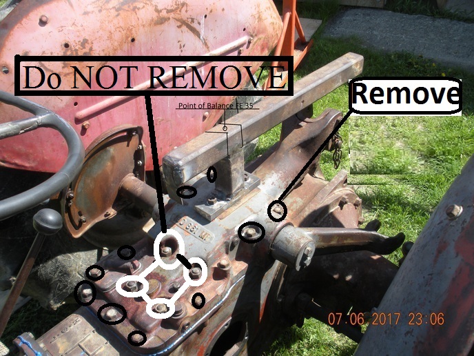

Cover removal from my 1963 MF 35. Owned since new..Replaced
pump..

Jim.me I totally understand what you are saying about the serial number. But I’m also reading the thin cover is 7/8 thick in the front and the thick cover is 1 1/8” thick. My health has been bad and I haven’t been able to do anything to the tractor. But I did make it out to measure that thickness. Mine is 7/8”. Have you heard of this before? Also do you know if a 165 or a 175 cover will work on mine? Upon looking at new top covers their listings include both those tractor’s. But I don’t trust the new covers they advertise coming from overseas. I’d prefer to use a used one. Especially if I already may have one. At which point I’d just go ahead and put the higher pressure pump in with no worries. I really appreciate everyone’s help!
I do not have any knowledge of the cover thickness. There is no mention of such in the description of the two covers shown in the MF 35 parts book online. There is a serial number break for the two covers. Serial number 232850 and up used cover 190861M2. Prior to serial number 232850 the part number used was 184392M92. Prior to serial number 232850 is well beyond the change to the 2500 psi system the manual mentions at serial number 169555. The manual tells of the 2500 psi cylinder being changed to a larger diameter, but you need to have the cover up to tell that. Cover 190861M2 shows as used on the 165 and gives a 7/8" front dimension for identification. As so far no one has answered your question on cover thickness, you might try calling one of the PartsASAP yards and see what they have for used covers that are for the 2500 psi system.
If you don't have a loader, or added weight to the front of your tractor, there's no reason you can't upgrade the pump to the higher psi. The old pump (when it was new) would lift the front of the tractor off the ground. At that point, you're not going anywhere. Hence, with the new (higher psi) pump, you're still only going to lift until the front of the tractor raises. If the top cover supports that with the old pump, it will support that with the new pump. If you add weight to the front end, all bets are off. I've upgraded my pump with the old top cover and have had zero issues, but I do not have a loader, or added weight to the front end.
