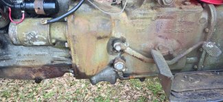

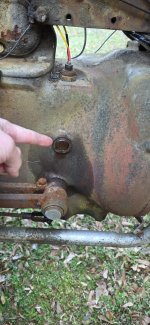

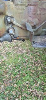

Hey guys, new here. I've inherited my grandfather's MF50 and have been working on getting it in working order. I've got the engine running great. I've noticed it was leaking from the spots in the pictures. What do I need to fix these leaks?

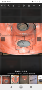

My original MF service manual indicates the MF 50/ MF35/TO35/MF 65 etc,etc, have basically the same designed Transmission.
Pics are of a 6 speed (3 with H/L) and NO multi-power. DUAL CLUTCH LIVE PTO
There should be NO oil in the bell housing cavity of your Transmission.
YES... you may have oil leaking into the cavity if the Rear engine oil seal is bad and or if the OIL seals on the transmission input shaft are bad.
I installed new bushings INSTALLING NEW BUSHINGS had nothing to do with OIL LEAKS
IF there are oil leak indicator holes as per pictures.....ensure they are NOT plugged,
OIL level in ENGINE ???
OIL level in common sump... DIFF....Transmission...HYDRAULIC ?
