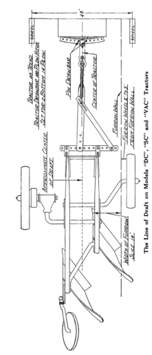

I have a MF 245 tractor and a MF 62 plow. I can't get the plow tip far enough to the right.... so the plow doesn't flip all the sod over - it flips a foot-wide piece and leaves about 6 or 8 inches of sod right side up and buries that with the part it flips. That's not the way its supposed to be.
I have loosened the U-bolts and nudged the plow as far to the right as I can on the cross-bar. I thought about spinning the cross-bar, but I don't see that giving me the distance I need.
You'll see I have the plow chained over - the tractor uses stabilizing bars and the plow has short pins which won't fit the bars. As far as I can get it, the lift arms are pretty well centred on the tractor, which is as it should be, I suppose.
And you'll also see that the top-link is kicked way over already - it is binding, as far as I can tell, so it won't let the whole plow swing further over towards the right.
On a 2 bottom plow I have, the first plow-tip is not centred between the triangle for the top link, as it is on this plow. Rather the plow tip is at the edge of that triangle, setting it much closer to the right wheel.
Any suggestions? The MF 245 is not a particularly large tractor. Only 45 HP. The outside to outside spread of the rear tires is only 6 feet.

It is not the plow that is the problem ,it is the tractor you need the right tire set in more to fit the plow. At 36 inch rows or your 6 feet you would need an 18 inch bottom or more to work well. You I believe be set so the tire is against the land side of the furrow when the plow bottom is running right in line with the front tip just inside the land of the next furrow. there will be more folks than can explain it better than I since I have never had to set an anchor plow before. Always plowed with trailer plows and they have some forgiveness to the setting there for them.
As said,your problem is that your tires are set too wide for that plow.Narrow your wheels. My 8N with one bottom has the wheel tread set at 48,center to center. Your tractor will be similar. You can get by with
just moveing the right side wheels.However,your tractor may only be able to set to 56 or 60 c/c.
The plow lower arm shaft needs turned 180 degrees too. The RIGHT pin/arm should be lower and the LEFT pin arm should be higher so plow can be set level with the right
rear wheel in the furrow.
Somehow you got to get that plow to only take a 14 inch cut. As mentioned the lower arm is 180 degrees off. By turning that correct you will be tipping the share point closer to the
furrow but I don't think it will be enough. That will also get the top link better in line. Do that first then move tractor wheel in so you are taking 14 inches. 45 hp. Should handle 2
to 3 bottom mounted plow with that loader weight on it.

Moving the right wheel: Sadly, it is already set as far in as it will go. There are only 2" between the wheel and the fender. The left wheel is further out, but that is irrelevant in this case.
Centre to centre width: the right wheel centre is about 28 inches from the centreline of the tractor... thus 56" is the minimum tire centre to centre distance. I remember plowing 30 years ago with an 8N, too... and it worked just right with a one bottom plow.
Two bottom plow: I happen to have one, and I am coming to the conclusion that a MF 245 is set up to operate a 2 or 3 bottom plow, not a one bottom plow. I wonder if you all agree with that?

I hope you got your solenoid issue sorted out:-) I've plowed more acres than I care to remember with a 245 and two bottom plow, never a problem, 2 14's all the time. The right wheel was set so that if your put your hand on the right clam shell fender it would get hit by the tire lug if you extended your fingers. I see you have the square style fender so maybe not able to get in that close though you should be able to. A pic of the right wheel may show something not entirely obvious, for example you may need to move the wheel clamp. I think a two bottom would work better, I never liked a one bottom plow. I've plowed sod without coulters, not the best deal but it can work.

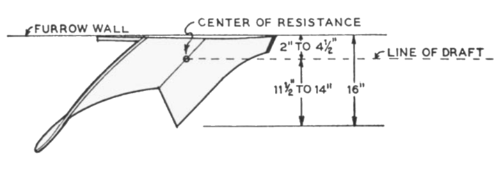

Single bottom plow: It looks like the single bottom plow has a 16" bottom. Pic attached. Is that right?
2 bottom plow: I was looking at it and see that the bottoms are narrow. Pics attached. Does this mean I am not going to be able to use this plow either? (this plow was given to me) (the one bottom plow is my neighbour's)
Disc plow: I was also given a disc plow. It's heavy, but still I imagine it's not so good for sod. Am I right about that? pic attached.
Thanks again
Eric
Pics order: 2 furrow plow with narrow bottoms, disc plow, 16" bottom of single furrow plow.

A part of the total range of track width adjustment is reversing the wheels and swapping the wheel/rims side to side so that direction is maintained.

What is the distance between the inside edge of the back tire and allso the distance
center to center of tire. They look like too wide a tire to ever work with any plow.
And the 2 bottom looks like an old Ferguson plow that you set the cross bar acording
to book and frame size and then only twist that bar to get final adjustments in place.
And that plow frame was not made for those narrow Scotch bottoms to work on it. They
are as I understand only a 10 inch furrow cut bottom and that plow is made for
depending on size of some parts a 12 inch or 14inch bottom.
