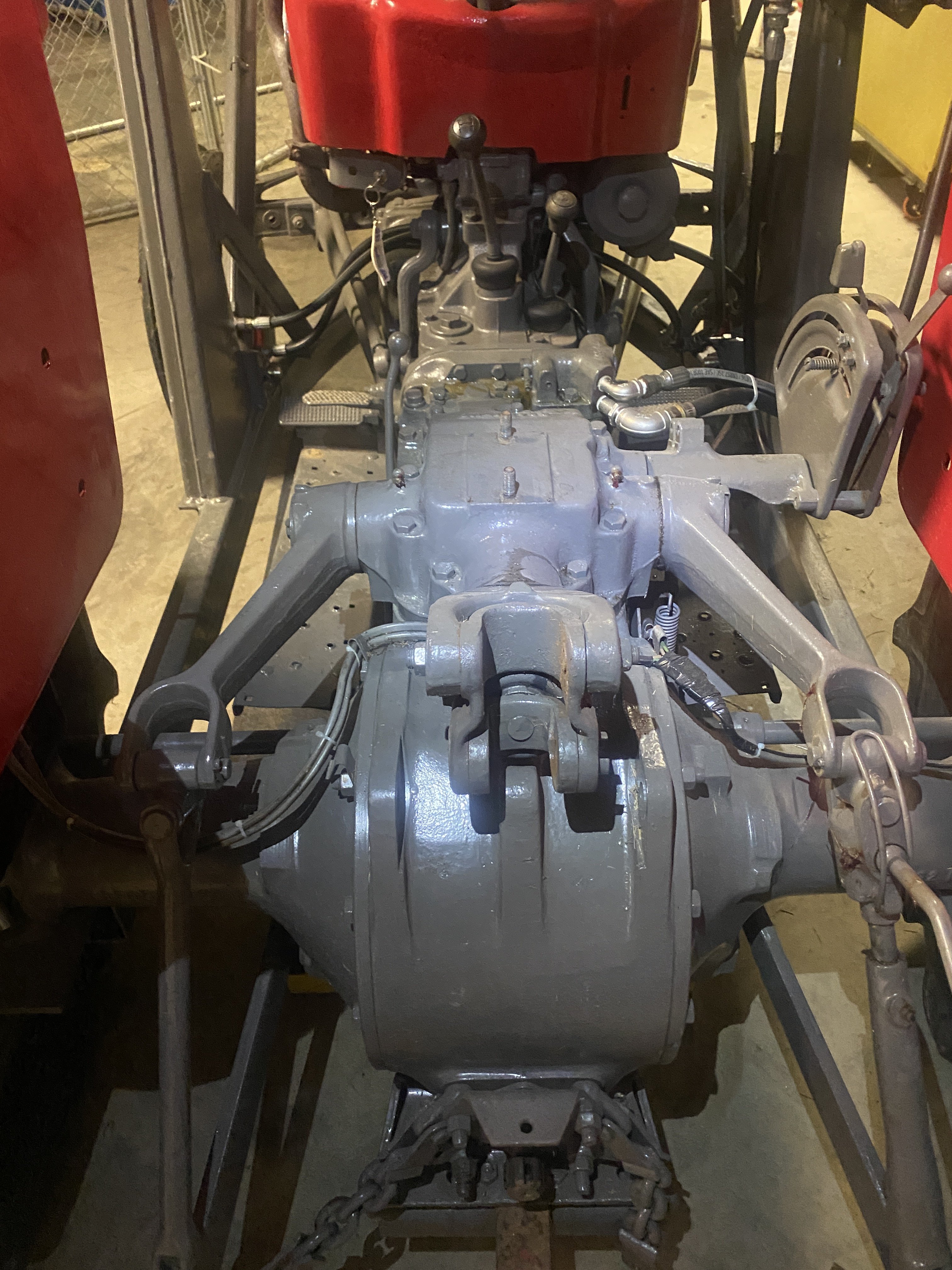

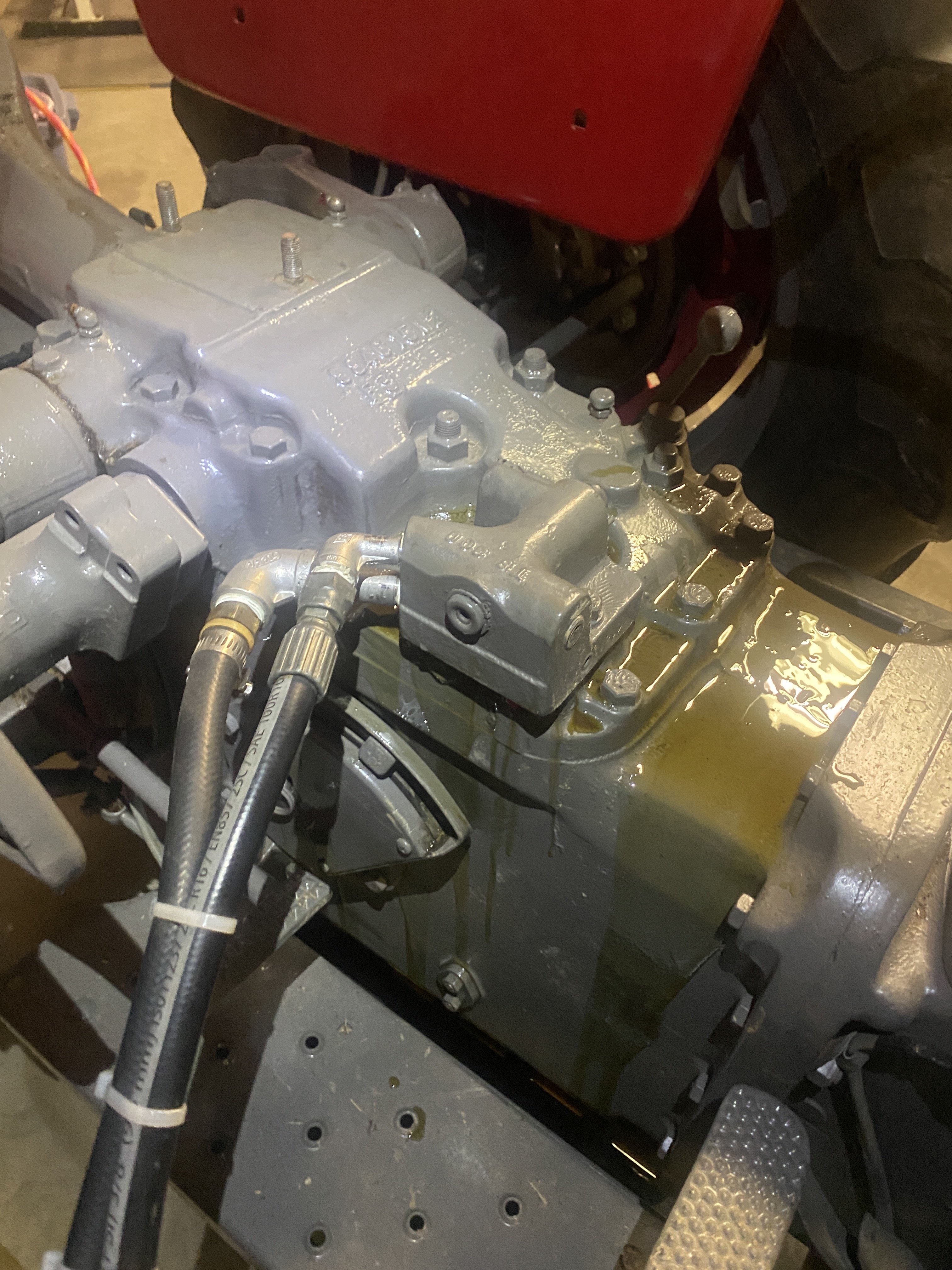

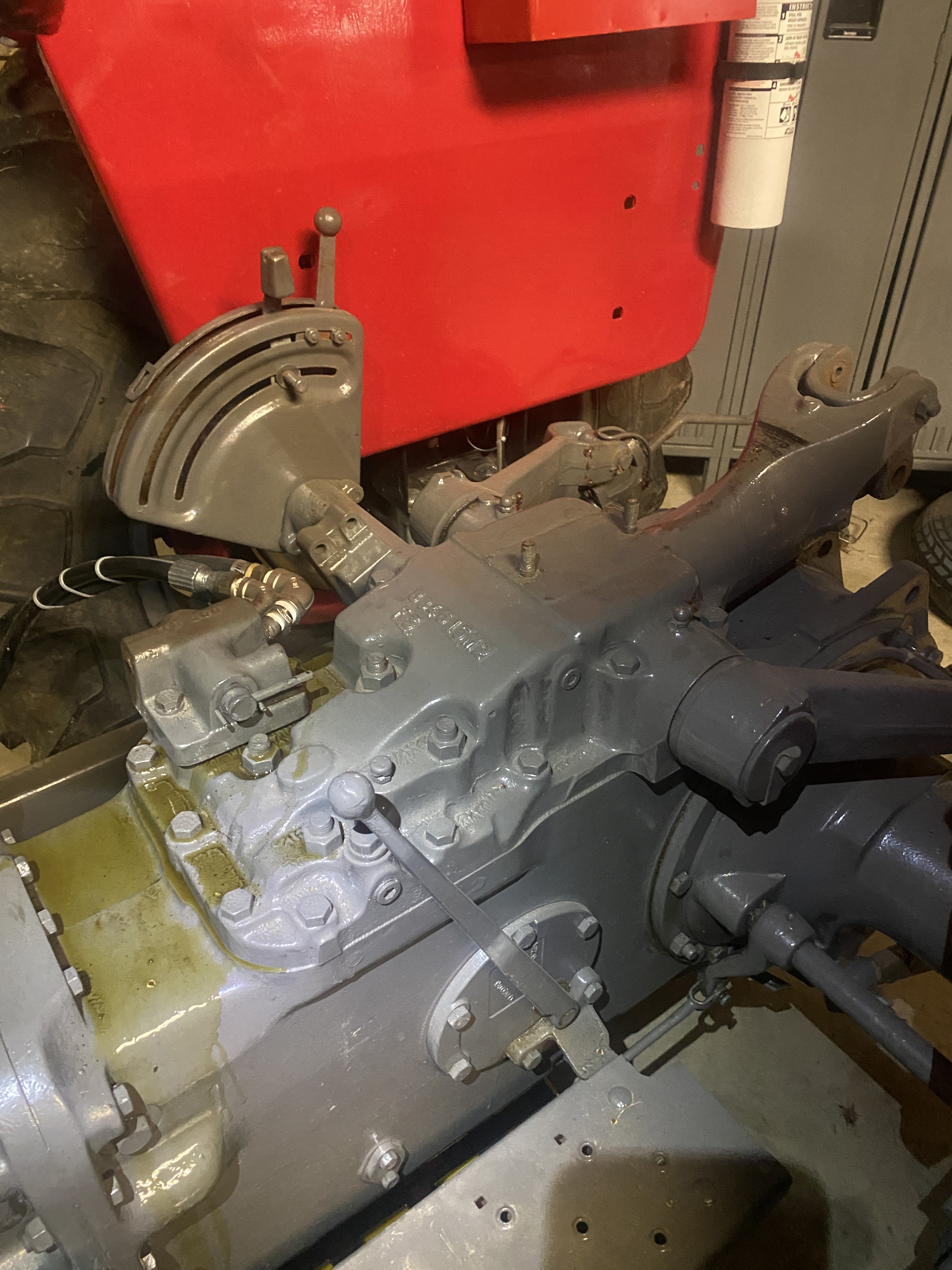

I have a 1973 gas 135 with a Kelly loader. Hadn’t used it in months. Jumped on it over the weekend and noticed the loader was moving very slow. I finished the small task I had and went to put it away. At that point the loader wouldn’t raise at all and when switching the valve to the 3 point lift, it also wouldn’t move. I noticed the oil level was just over Low so I added some and no change. I let it sit overnight then pulled the valve on the top cover to see if possibly the tube had come undone. When I pulled the valve, oil came out the top and went everywhere. O ring looked good so reassembled. Started tractor and the loader would move again but was slow.
Ideas? I’ve never had the top cover off or messed with the hydraulics.

Possibly junk in relief valve holding it partially open? When was the transmission oil last changed? If never, there can be water in the bottom of the case causing problems.
I changed it a couple years ago, but just a drain and refill. I am just seeing now that there is a filter inside. The tractor is only used a handful of times per year. Where would I find the relief valve?
