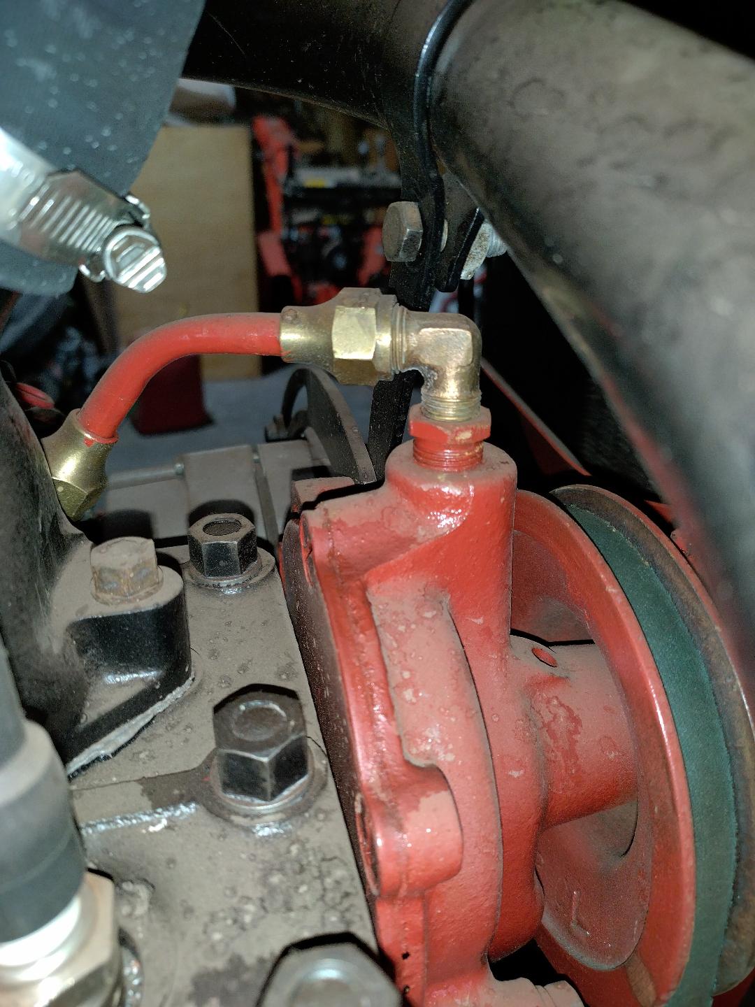

One question, the Lundeen cab has a heater. I just need to hook the water lines to the engine cooling system. Anyone have any ideas how to do that?

Look for an outlet port near the top of the water pump. Return can go just about anywhere into the block - wherever you find a suitable port. This assumes you have a flow control valve on the heater, in the cab. steve

I don't have a 44 to go by, but here's a pic of the top of the water pump on my MH 101. I think the line running between the water pump and the thermostat housing is probably just a bypass where the heater hoses would hook up. MHNut has several 44's in his lineup, so he would be the guy to ask about the right place to hook it up. steve

I don't think there is space to put an outlet on the water pump on a 4 cylinder 44....you may have to install a sleeve with a port in it in the upper rad hose or in the thermostat housing. There is a drain port on the lower rear of the block that can be used as well.

Hi John. I do not see any easy way to get a good source of warm anti freeze to your cab. On my row crop 44 there is a drain cock on the lower rad hose pipe and also a drain in the middle of the block. But on my other 44s there isn’t two drain fittings. Plus I’m not sure you would get enough positive flow of coolant to circulate properly. You are going to have to manufacture some sort of a fitting in the top rad hose and drain back to the block or something some where. That has been mentioned already I believe. Let us know what you come up with.

I will try to McGiver something. I'm thinking tapping in at the upper radiator hose, and returning at a drain petcock or adapting something at a drain plug.

Just FYI, heater cores are generally supplied by a fitting on the head. The water pump pushes coolant through the block up into the head. The thermostat generally in the coolant outlet of the head to the radiator is a “valve” controlling that flow or pressure. Any fitting in the head or actually the block drain are “pressurized” by the water pump. Many are fooled by the heater hose connected to the water pump which is in many cases actually the return hose from the heater circuit. This was true of many cars/trucks with small block Chevies and was misinterpreted by many. The hose connected to the pump was the return and the hose connected to the water port in the intake manifold upstream of the thermostat was the supply.
