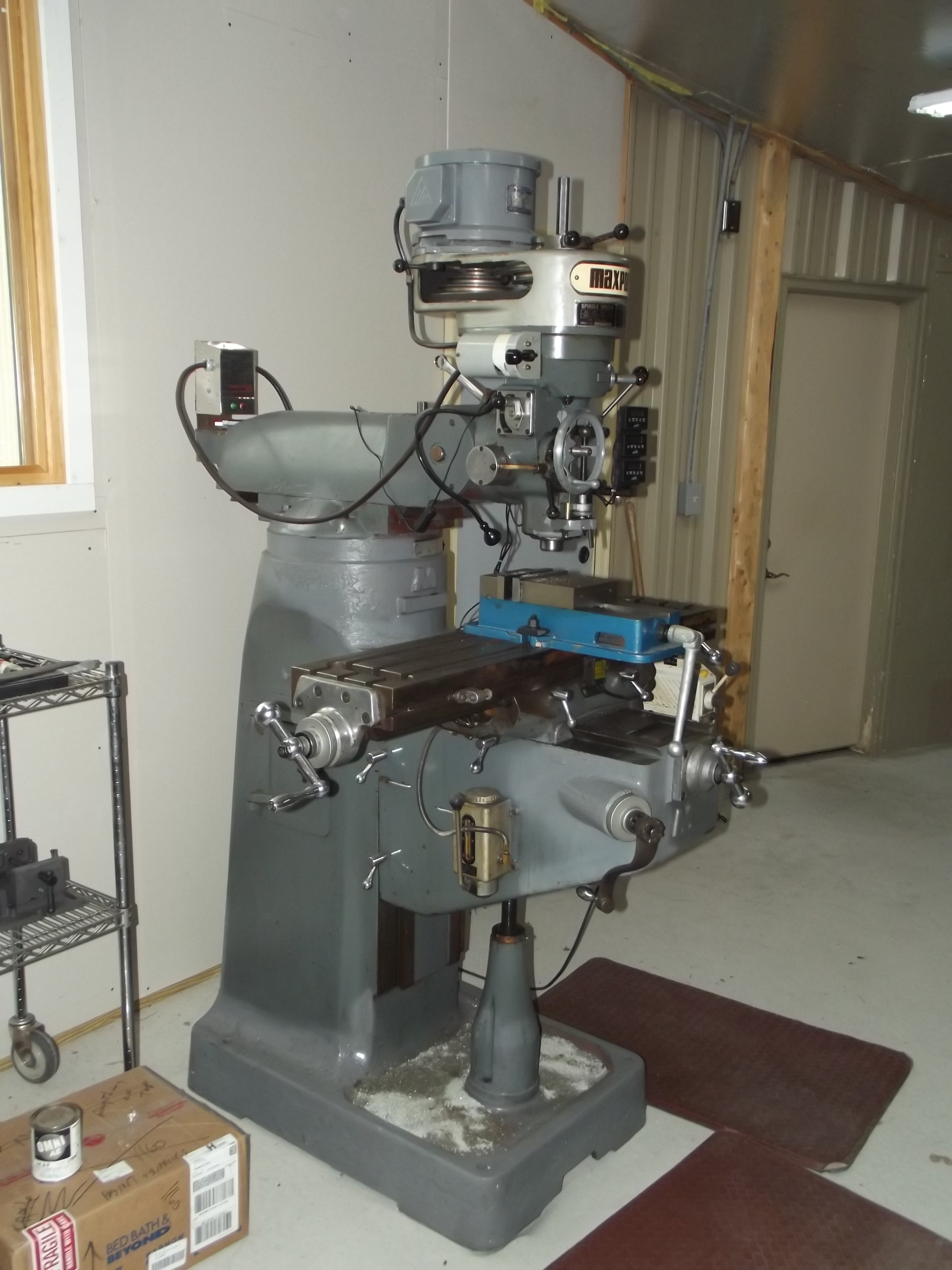

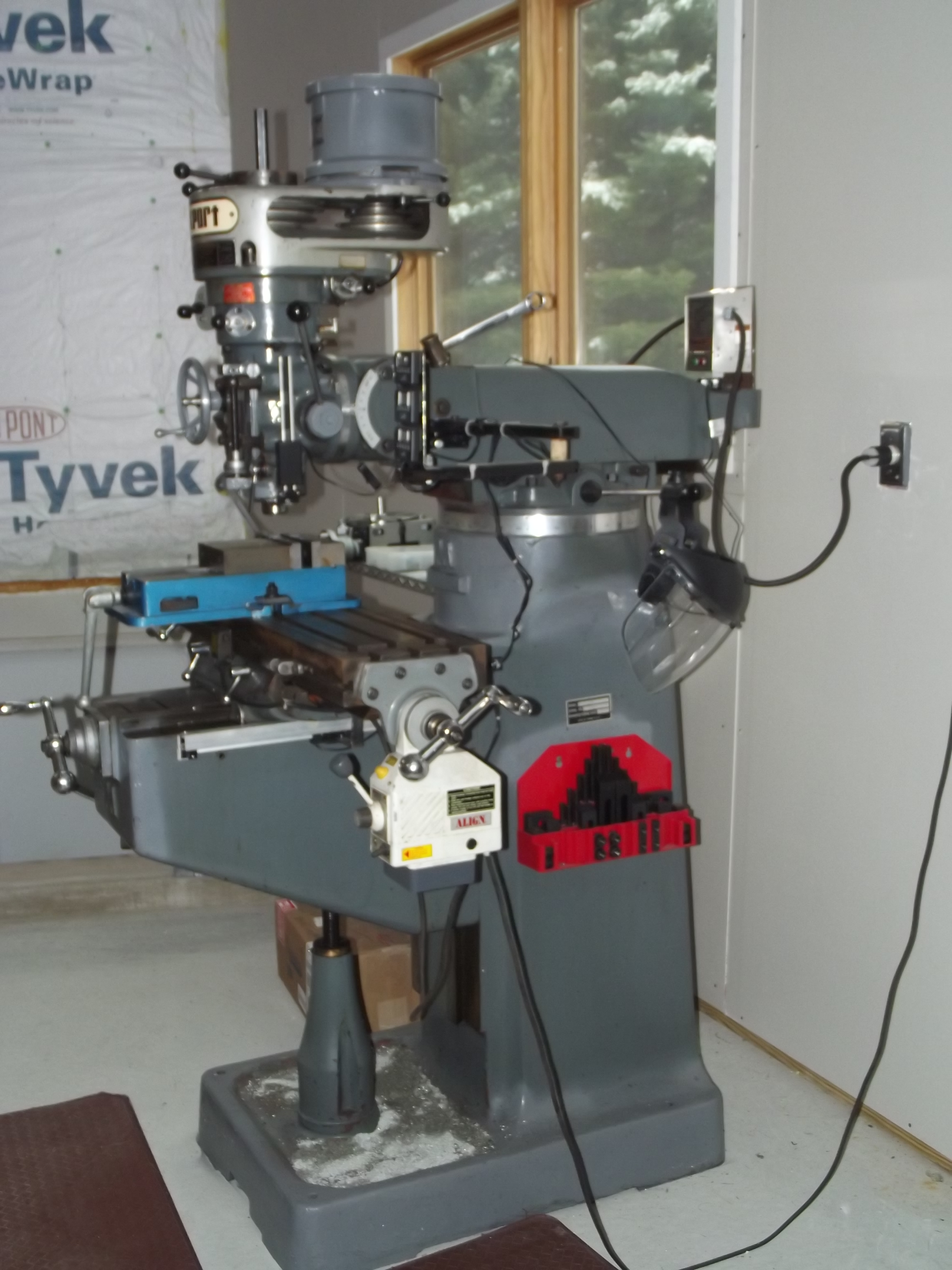

You'll want a Bridgeport or Bridgeport clone. Search for local machinery auctions or even Craig's list. The issue is weight and subsequently how to get one home (they typically weigh around one ton and don't bother with a bench top type). Almost all are 3 phase 440volt and you'll need to rewire it (instructions usually inside motor cover panel) to 220v and get a single phase starter converter (inexpensive). Understand you will lose 1/3rd of your horsepower in the process. Only other thing is to make sure it takes R8 collets (most common and least expensive as such). I got a Maxport (Taiwan clone of a Bridgeport 2J) at an auction for $1010 in the door. It had twice the horsepower of a 2J, had a power X axis drive (needed a new armature), refurbished ways, Meehanite cast frame (stiffer) and most parts interchangeable with Bridgeport. Adding digital XYZ readouts was easy and cheap (about $120).
There are endless online 'how to operate' videos for mills or even instructional DVDs so no worry there. Understand you'll become addicted and keep buying endless bits, clamps, attachments, etc.

JF is spot on, table top mills are next to useless except for hobby models. Horizontals are dirt cheap but very limited in application. You want a Bridgeport or clone and want variable speed, not a step pulley. 9x49 table. Then you will have a versitile mill capabile of most home/hobby/farm jobs. There is nothing wrong with an imported Bridgeport clone except what may have been done to it before you buy it. I bought a new Jet in 1997 and it has cost me zero for repairs.
Check backlash in lead screws , check wear in the table. Check in side quill for damage . Damage on collets if they are offering . If vise is offered if table is perforated with drill holes In surfaces of table.
Variable speed is ok, however it should definitely not be a factor in mill selection. Since you will in all probability be using a VFD to provide the 3 phase drive to the motor that gets you variable speed anyway.
I have a nice mid '70s Bridgeport with step pulley head and I rarely change belt settings as the VFD provides plenty of speed range. On the rare occasion I do change belt setting, typically for high speed with very small end mills, the belt change takes about 15 seconds.
The condition of the spindle bearings, ways and leadscrews should be your primary concerns in used mill selection. A *modern* DRO already installed is a plus, while an old obsolete DRO is pretty much worthless. Central lube is a plus. Included tooling is a *huge* plus as tooling costs will far exceed the cost of the mill.
