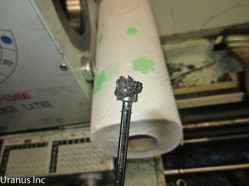

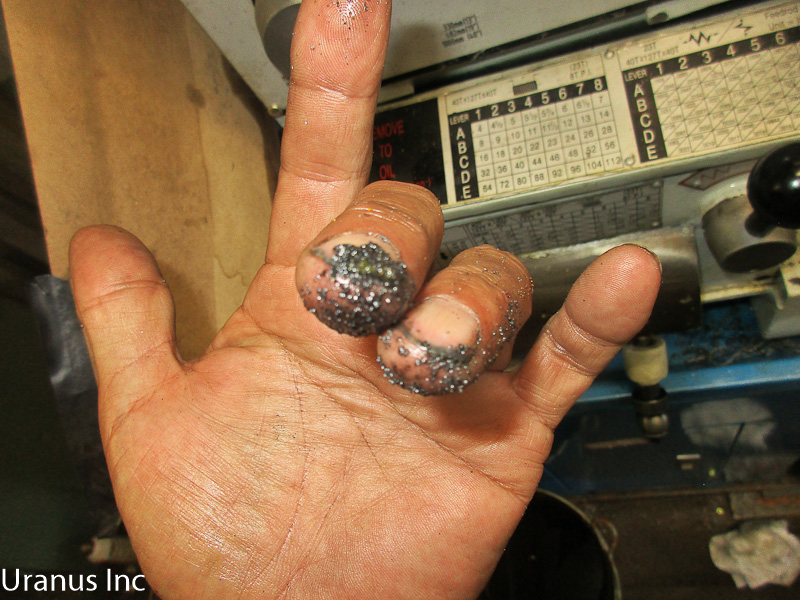

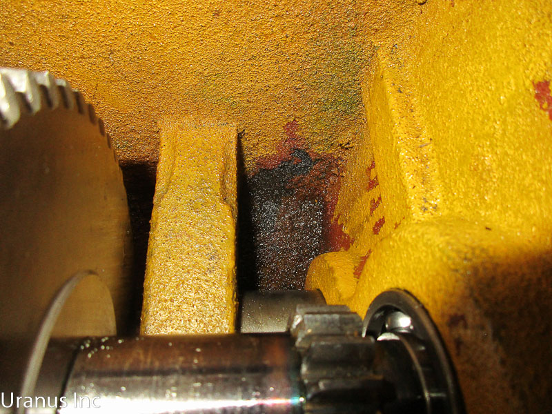

One note..................bmaverick is slightly wrong. Grizzly machine tools are entirely made in China. There are no, IIRC, USA made manual lathes available today..with the exception of used ones.
None of the Chinese lathes are ready to run out of the box. I've read a ton of stories about work that needed to be done on them. Foremost is cleaning the sump in the headstock.
Mine was no different than a host of others. On top of which........the spindle bearings had been installed/adjusted improperly..........and had to be replaced. The vendor covered the cost of the parts. P5 bearings aren't cheap. After the work I put in, it's been a very good lathe. I'd expect no different from any of the different brands........they're all basically the same machine with different nameplates. Always keep this in mind. "Brand names" mean nothing.
