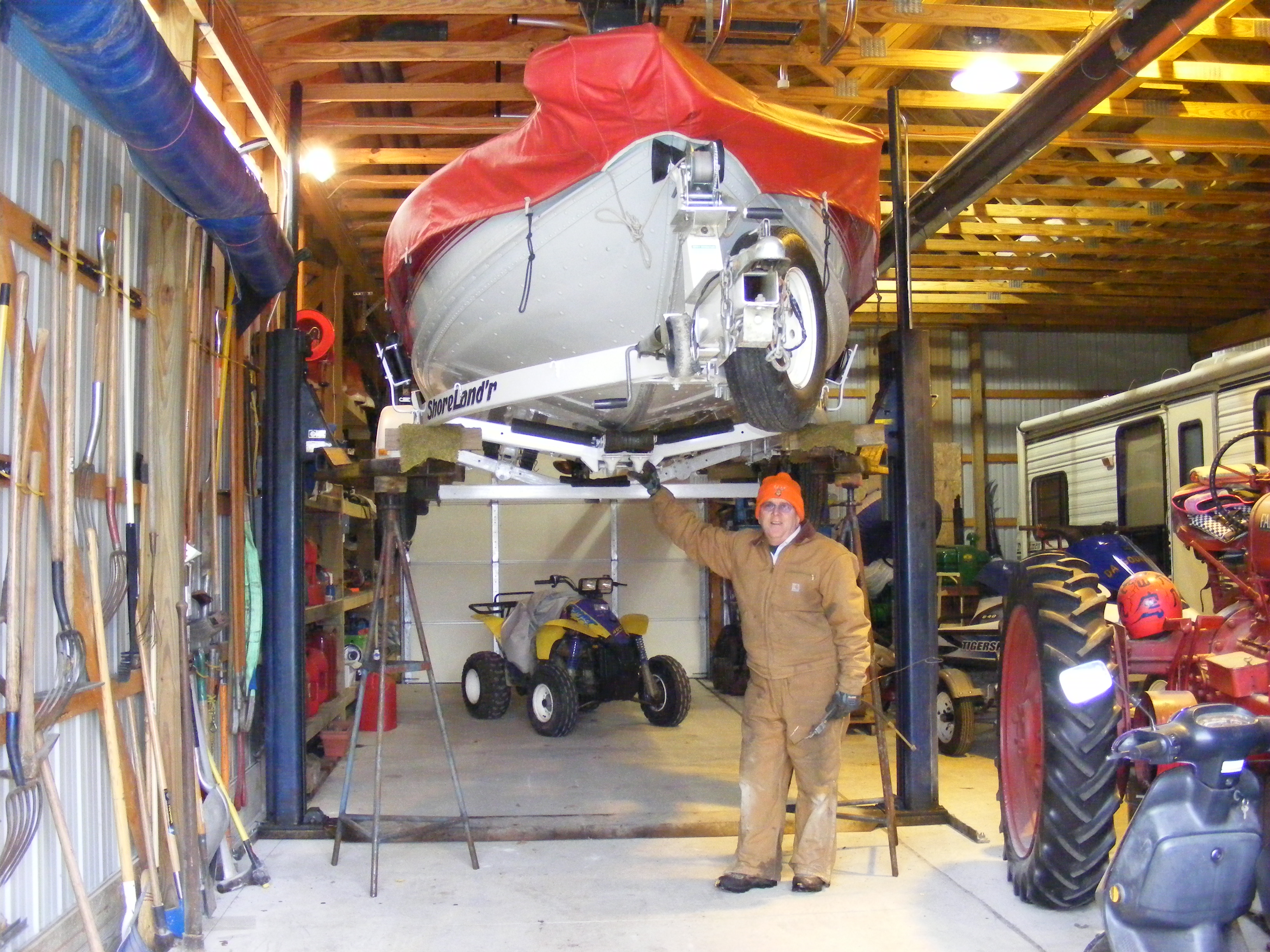

If all your going to do is heat and you have natural gas, look at a radiant tube heater. I have 2. One in an insulated 24x40x9 shop/barn and one in a 30x48x12 uninsulated pole barn. I keep the shop at 45 and raise to 60 when inside (occasional not full time use). I only heat the big barn when working on something inside. I'm on a budget for my gas, and heating (forced air + water and dryer) for my 1,200 sqft house (full basement) and both barns has cost me $65 a month the last couple of years. I find the radiant tube very cheap and it works great. Heater is upper right. They were designed for high bays.Has anyone put minsplit in their shop. My shop is 1280 sq feet with 14’ ceilings. Would a min split work to heat? Cost per month? It does have ceiling fans.
