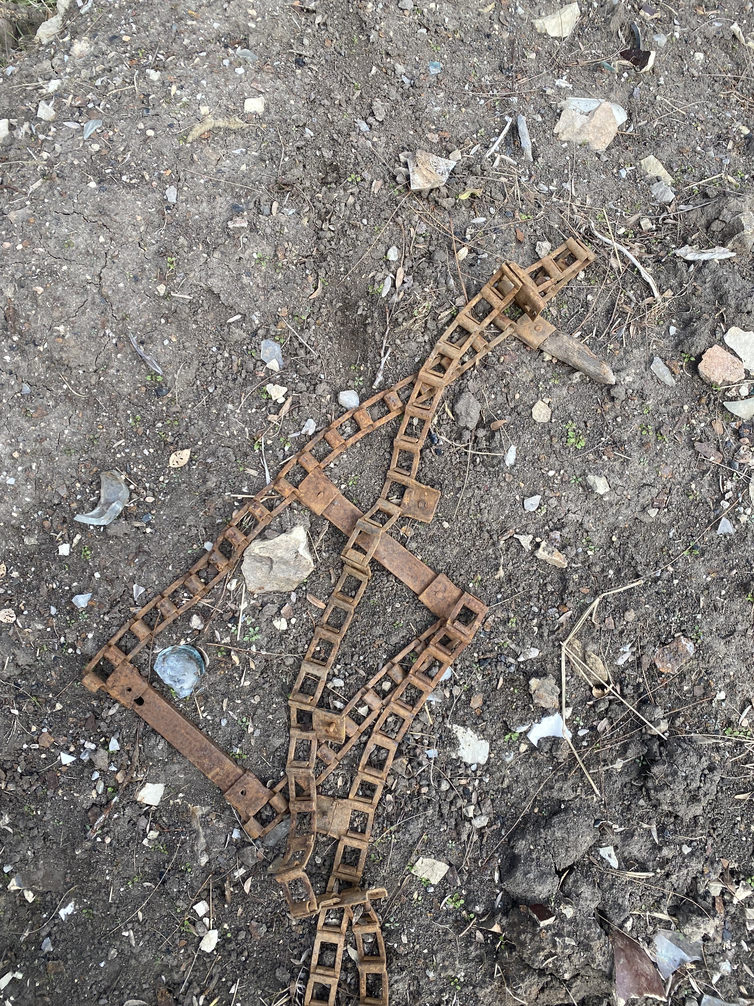

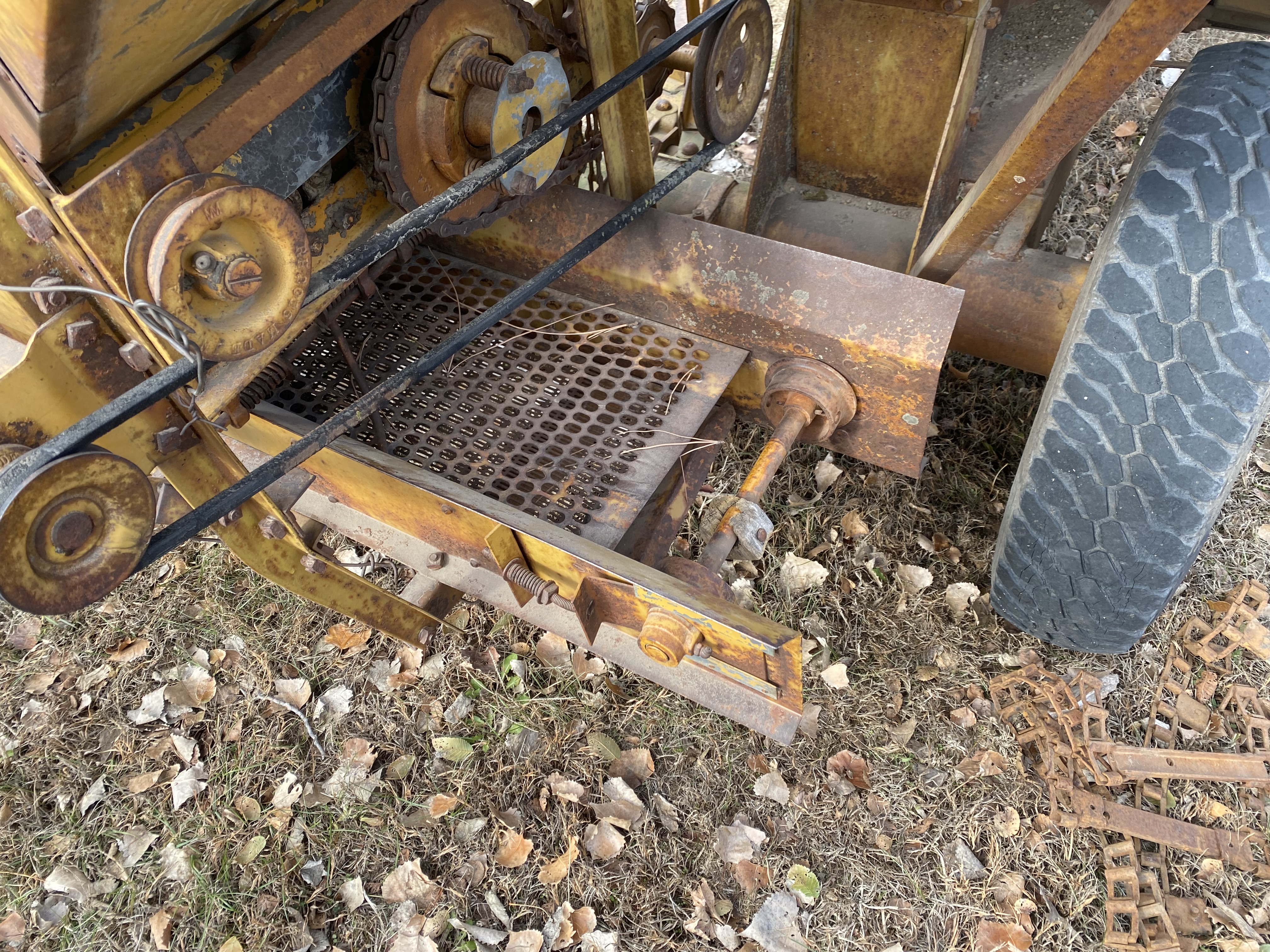

I just bought a Minneapolis Moline SH corn picker. I was wondering if anyone had a chain like the one in the picture?

As Mark said, you'll likely need to make it yourself. What you need though is detachable chain, not T-bar. Shoup has a selection.
Maybe this place.
