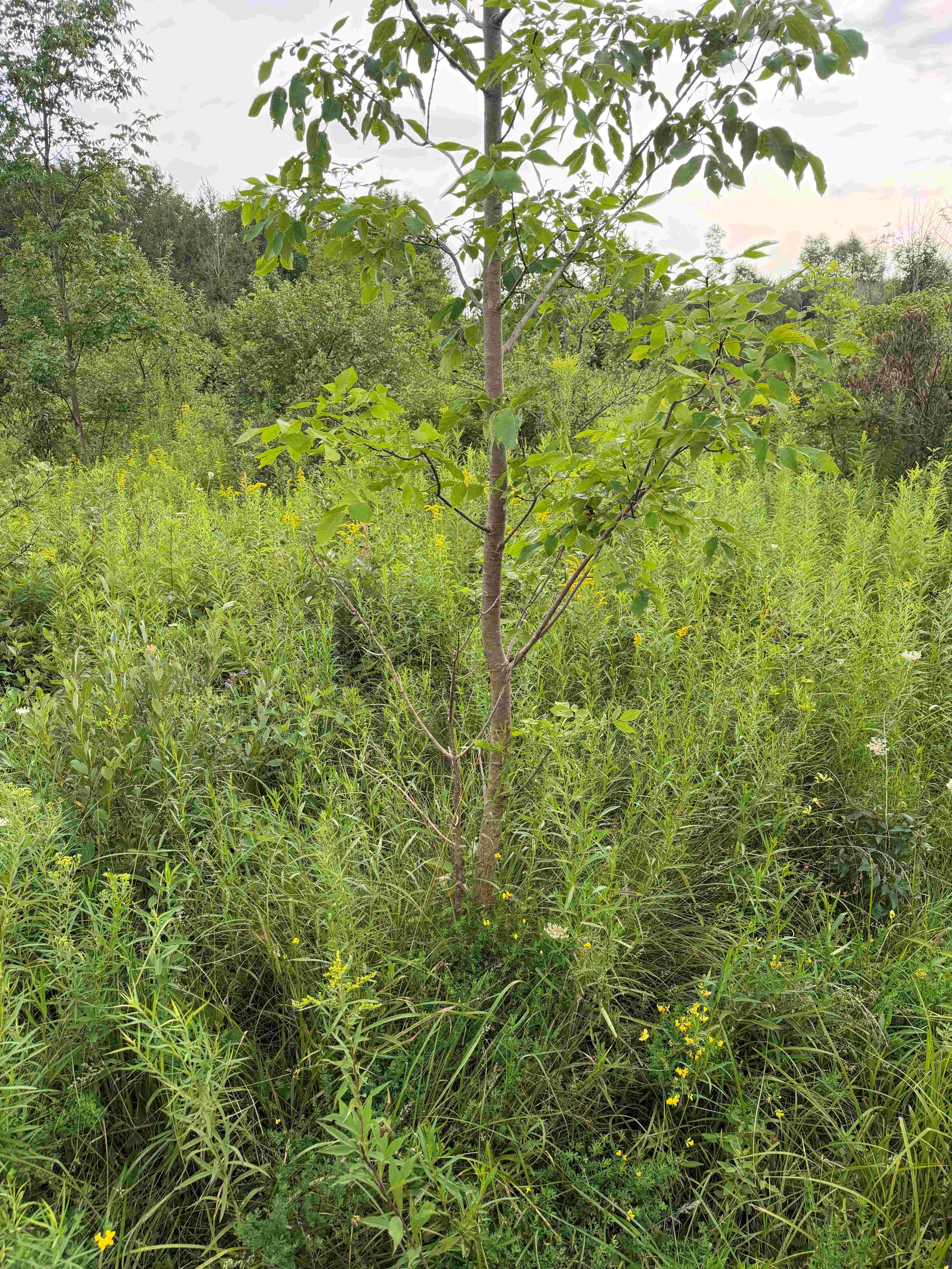

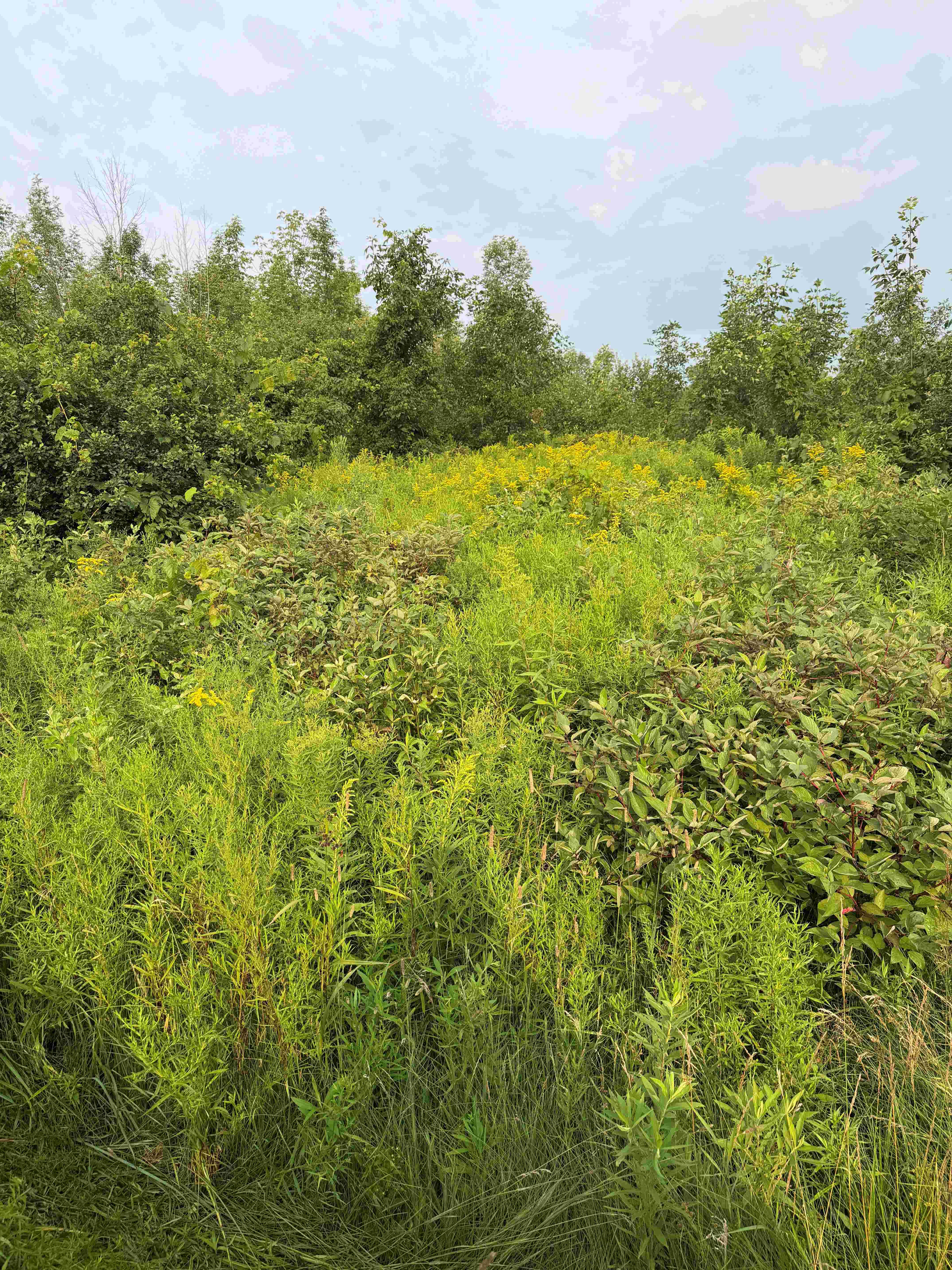

I read one of the other posts about mower shear pins and was a bit surprised. I've never heard of Grade 2 bolts nor Grade 10 for that matter. Anyway, I have a five foot wide bush hog that I've been using 3/8"x3" Grade 5 bolts in as the shear pin. I doubt the deck would even spin up with a Grade 2, lol. The problem is that I break bolts constantly, maybe four or five per hour. Now I'm not hitting rocks or otherwise stalling the blades from an impact as such. One of two things will break the bolt: heavy grass/weeds or a small sapling (3/4-1.5 inch dia.). The little saplings, what usually happens is I hear the bang as the mower cuts the tree off and the bolt breaks at the same time. The blades are still spinning after the bolt breaks, but it's irrelevant at that point.
The heavy grass/brush is the most annoying, at least with the little trees I can see them coming and raise the deck a bit. Yesterday I broke a two Grade 5's in twenty minutes, with the deck 9-14 inches off the ground mowing 4 foot high grass and whatnot, no dogwood or anything. I've tried Grade 8's in the past and they aren't much better, they are a little tougher, but they still snap on the little saplings and they are a d@mn sight more expensive.

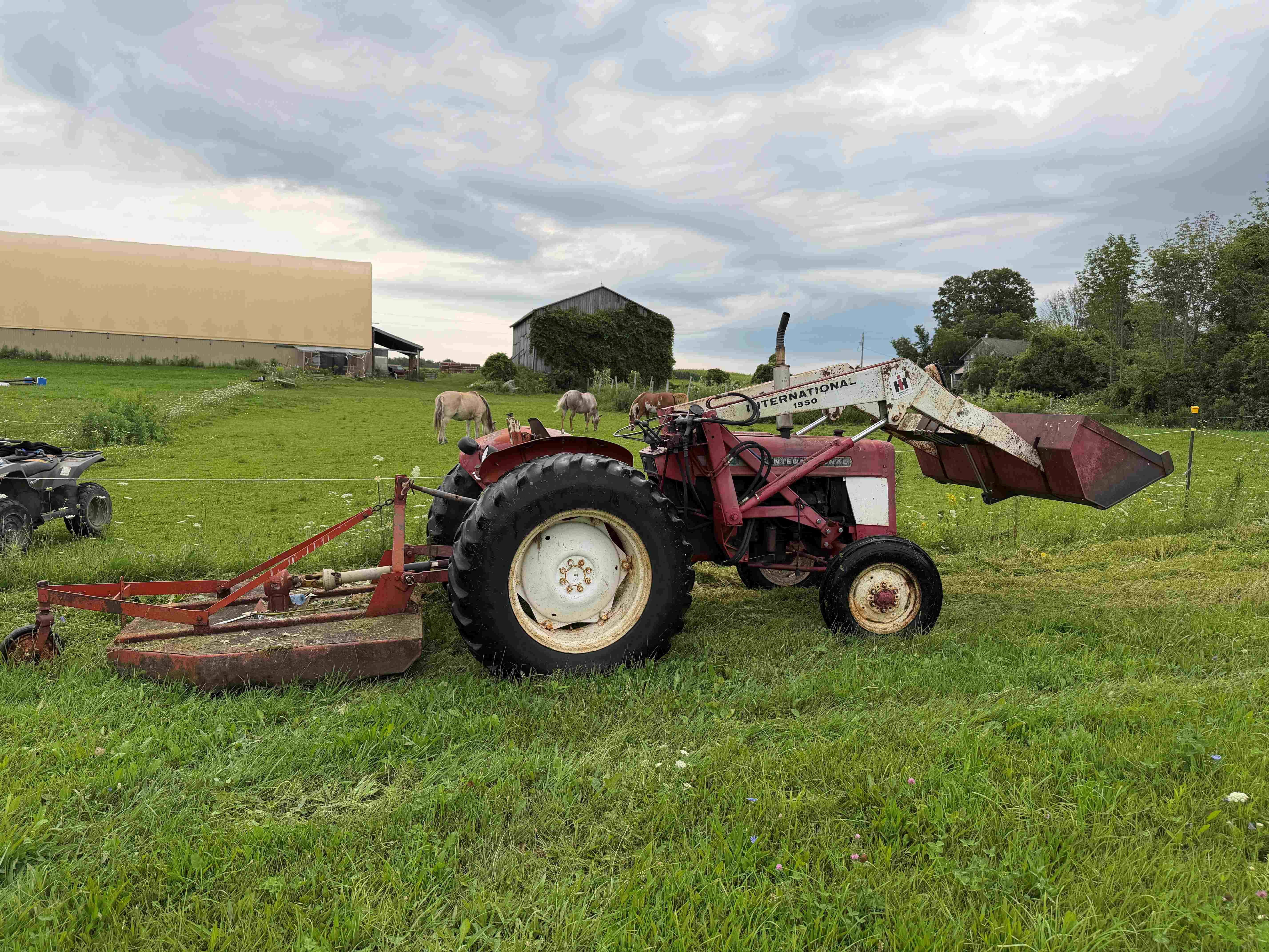

I'm using a 1970 (I think) IH 444 diesel to run the deck. I'm not too worried about stripping the gears out of, if it dies, it dies. I generally mow in 2 low, revs at near max. I can't tell you what that is, because the tach has been broken since I bought the tractor 27 years ago. 1 low is just too slow, and 3 low is too much for the heavy stuff, but it's fine for normal mowing. If I'm working near the treeline and the bush is all dogwoods and crap, then I'll shift to 1-Low, the tractor has to work pretty hard in that stuff.

Well I tried some new bolts, and 1/2" will fit, the threaded part is snug, whereas the blank section slides easily enough. So tomorrow I'll take the deck for a spin and see how it does with the new bolt. The Grade 8 1/2" bolts arrive tomorrow as well, so if I snap the the Grade 5 I can try again with the 8. No, I don't have a manual for the mower, it has no markings or stamps anywhere on it, not even on the gearbox. I think I paid $50 for it twenty years ago at an auction. I'm not too worried about busting gears, the square baler will stall the engine outright when it suddenly jams choking on too much hay. The slip clutch on it only stops the PTO from forcing the baler to spin, it doesn't stop the baler from forcing the engine which is spinning at almost max rpm to go to zero rpm in a split second. So if the baler hasn't killed the tractor in these past twenty odd years, I'm not too worried about the mower killing it; I do a lot more baling than mowing. I don't mind the little trees snapping the bolts so much, but I will not put up with thick grass making them shear, that's just nonsense. Hopefully you guys are right and the 1/2" bolt will make all the difference. I'll find out tomorrow.
The other thought I just had is maybe replace the gearbox with something else. It occurred to me that if I could get the blades spinning at say 1500 rpm or better, then nothing short of a small tree should be able to stall the deck. The rivets holding the blades on look like 3/4", and the blades are 3/4" too looks like, so they ought to be able to take a lot of force. Something to think about anyway.
