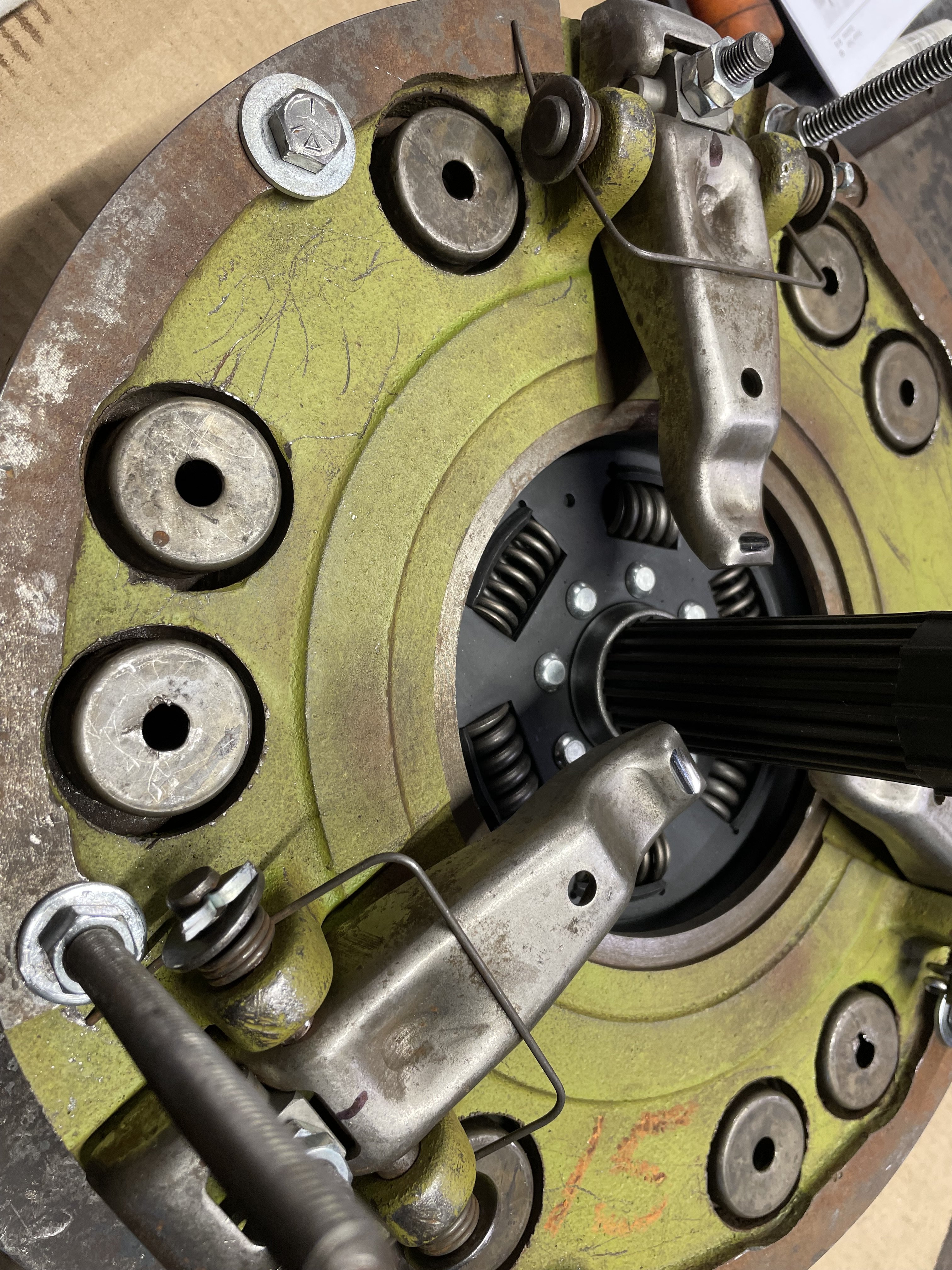

5, the BIG question: from what i can tell these did not come with live PTO but I cannot tell if its a single stage clutch pedal or dual stage per the owners manual the seller had. The lever on the left side of the transmission moves and engages the PTO (spins) with or without using the clutch. it hangs a bit in the middle of the travel when engaging but with a little effort goes into gear. not rough at all and no grinding of the PTO gear. PTO does NOT stop with the clutch fully depressed. CLutch seemed ok driving wise. if it is a clutch issue that would require splitting the tractor my friend will probably pass on it. otherwise he may make an offer.

With a two stage clutch there is a step increase in pedal force in the last 2 or three inches of clutch pedal travel. You can feel the PTO stage in your foot as you depress the clutch pedal.
I presume its safe to presume that since the clutch does NOT stop the PTO shaft that it would be the dual stage clutch set up?

Not in my book. I would say it has the independent PTO option. The PTO can be started and stopped with the lever, without having to depress the clutch pedal, correct? It's IPTO then.
Never heard of a Deere with a 2-stage clutch.

On the contrary, MANY Deere utilities have 2-stage clutches.
The parts catalog shows a simple clutch and a non-live PTO option, a "continuous running" two-stage clutch setup, and an independent PTO option with a multiple disc PTO clutch rearward of the main/flywheel clutch.
There's variations if it has a reverser, and the power shift versions used a hydraulically-operated multiple disc clutch.
this one is definitely not independent as it does not have the lever between the gear shifters.
My logic is the "single stage clutch" if acting up wouldn't operate for moving the tractor around which seems to be ok. therefore must be the dual/2-stage clutch set up. => hence the question to confirm our suspicions. the seller doesn't have any equipment to try it with to see if its just stuck due to not being used. they seller is a bit of a used car salesman (literally and figuratively) and said it was on a brush hog last year but has not brush hog. he also said its a 1975 and its a 1967 per the Serial Number.

I don't understand. It starts and stops with the lever, no grinding. To me that sounds like an independent PTO.

The single and dual/two stage pressure plates look different. Look in the clutch inspection hole (I told you about this in your post on the JD Forum) and see which it has. The single stage pressure plate looks like a regular single disc pressure plate you might see in a pickup truck. The two-stage pressure plate is flatter, heavier, and the fingers have exposed horizontal pivot pins you can see and are held in with cotter pins. If you can't tell post the best picture you can get of what is in there. With nothing hooked to the PTO shaft my 2020 PTO can be engaged without grinding, especially when cold. May tractors will engage without grinding with nothing hooked to the PTO. The operator's manual tells that the pedal can be adjusted on the dual/two stage clutch such that it doesn't operate the second stage if the PTO is not being used, if one chooses.
John Deere calls the dual/two stage clutch a 'continuous running or driven PTO". The single stage one is called 'Transmission Driven PTO".
You are correct the independent PTO would have the hydraulic control lever for the hydraulic clutch pack mounted between the shift levers.

Here is a picture of the cover plate of a two stage clutch for a 2020.

I have a 1969 2020 diesel that has the 2 stage clutch. The first part of the clutch pedal stops tractor movement while the second part stops the pto, the second part pushes a bit harder than the first step.
