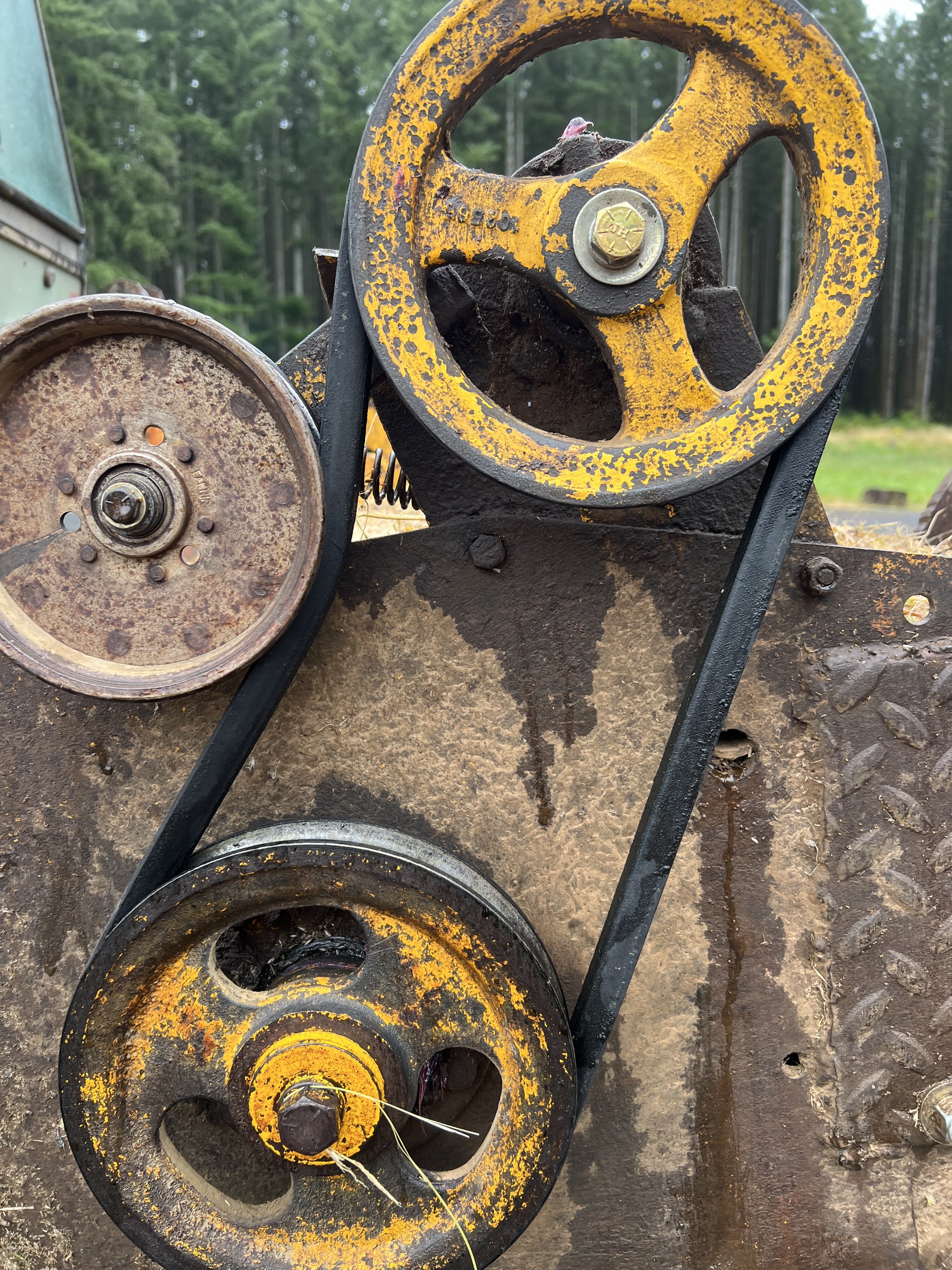

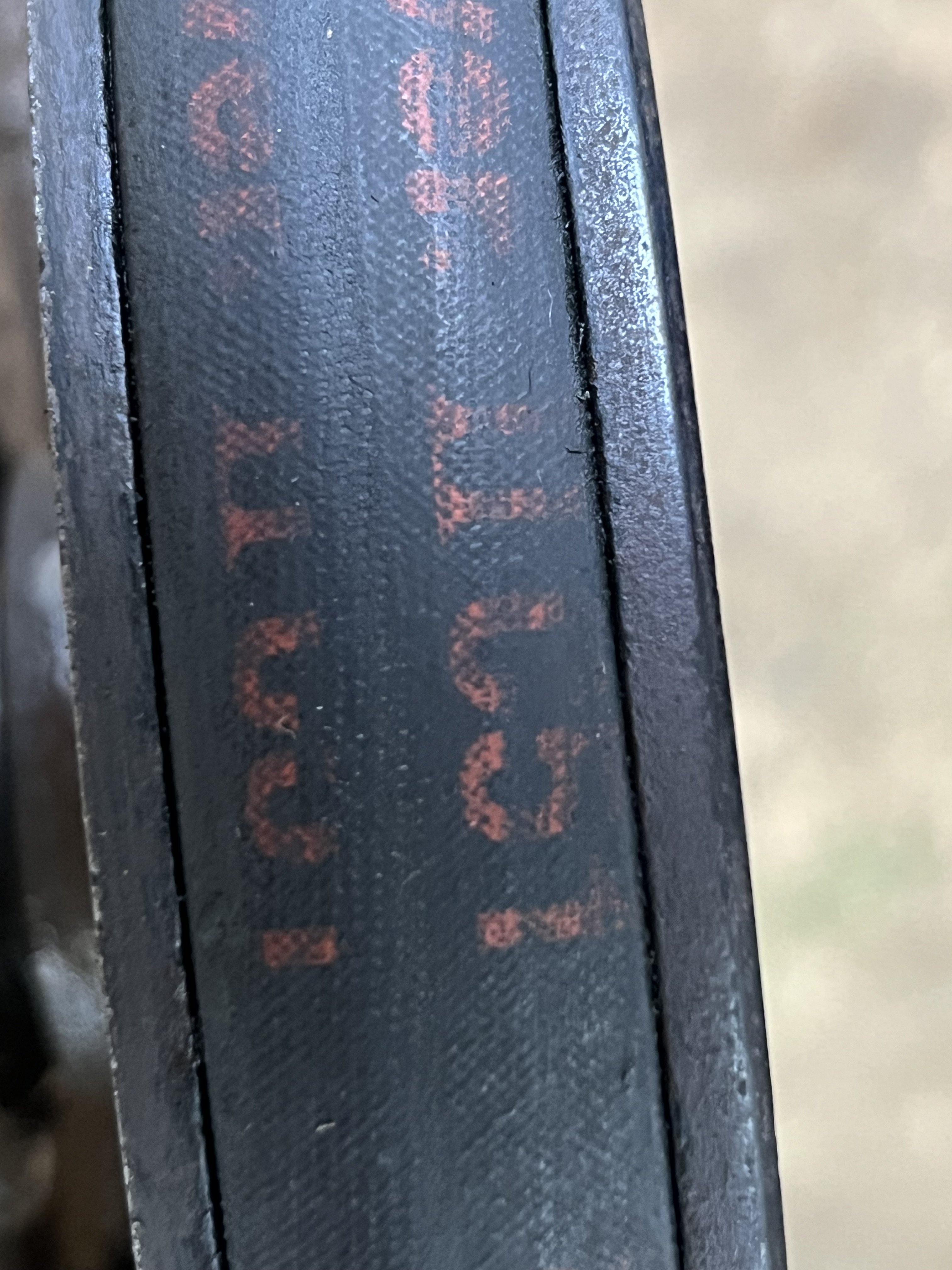

new help, I have a mott flail mower, I believe 7'6" cut, need to find the part number of the belt, it's about a 60" belt, pretty heavy belt, there is not mott model number to be found

You have the old belt there, take it to a belt place. They measure the back around for the length, you could also. Then figure out the series by its width, consider it likely is worn a bit narrow.

Just take the old belt in to a good parts supply for trucks or other bigger equipment and they can fix you right up. New belt or order a new one for you. Big belts are not going to be cheap .

I agree. Take the old belt with you and match up a new belt.
DO NOT let them get you all turned around, and convince you that the belt has "stretched." It's pure baloney. Belts stretch a fraction of an inch at most, but these belt places will try to convince you that you need a 2" shorter belt. That is pretty much a guarantee that you will be making another trip to get the longer belt. Get the belt that matches up the best with your old belt.

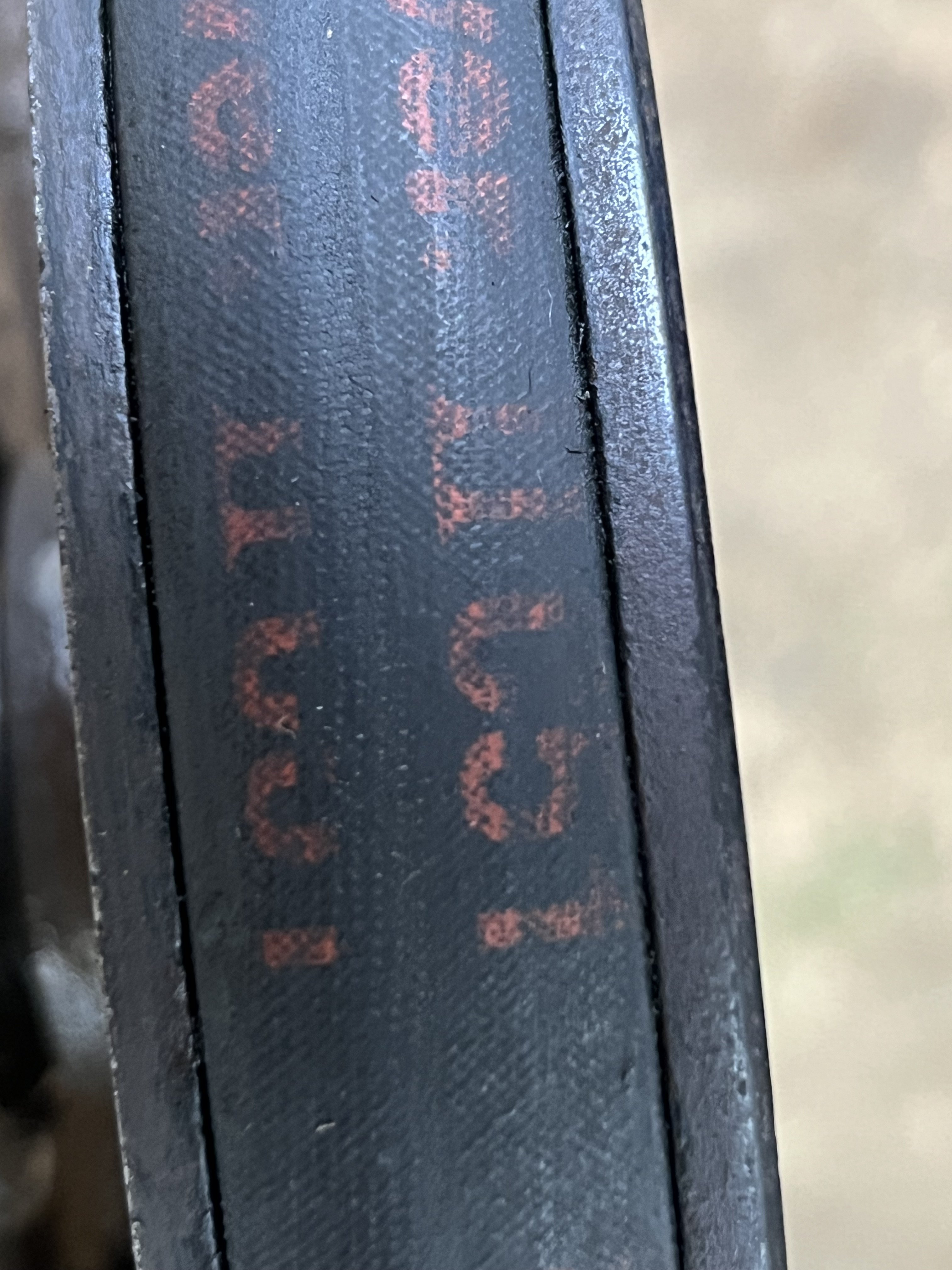

This belt is clearly a Gates Hi-Power II Belt (we can see ''...wer II'' followed by ''C51'', so this belt is a : Gates Hi-Power II C51
C section V-belt means 7/8" Top Width and 17/32" Height
C51 means 55.0" Belt Outside Circumference (because 51 means the inside diameter, and for some strange reason, they decided they would use the ID for the C type belt identification! Anyways, Mott mowers came in different pulley combinations using 8,0'', 8,5'' and 8,75'' diameters.
The newer models (62, 74 and 88) used a 8,5'' and 8,75'' pulleys with belt #100706, this one a C54 with diameter of 58,0''
The older models (60 and 72 models) had two same 8,0'' pulleys and used belt #102631 which is a C50 with diameter of 54,0''.
There were also options like higher speed and reversed rotation that used other rare pulley combos, with a special 7,5'' driven pulley, and all those variants used one of five belts between 54'' and 58'' (C50-C54).
So by looking at the first picture at the beginning of this post, it's obviously an old Mott 72 model, just by its 3pt A-frame and also the U-shaped roller guard we can see at the bottom of the image. So that belt would normally be a 54'' belt C50. BUT... This mower has something different, an option so rare that this is the second time I actually see one like this! This is a ''REVERSED ROTATION'' mower! We can see here that the shaft pulleys and belt are on the right side of the mower instead of the left, so the flipped gearbox's driving shaft is now turning backwards. I would be curious to watch how such a mower performs! But I'm not sure about being bombarded by some high speed flying debris burping out front by the mower's blades! Like I just said, these older models (60 and 72) can be identified by their thick, straight 3 pt frame arms, compared to the Y-shaped ones on the recent models. The old models also have those thick cast iron roller shaft nut guards on each side, and this also means that the mower has the discontinued threaded tie-rod roller shaft system, with all the obsolete parts and bearings that aren't available anymore...
