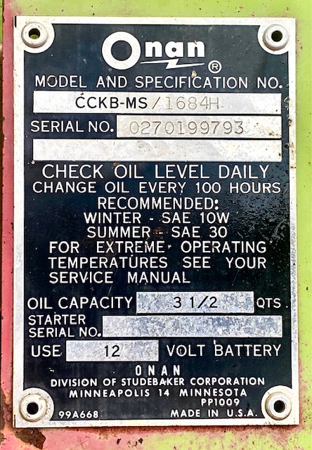

I purchased a Mott Hammer Mower today that has an Onan engine on it. Engine will need quite a bit of work to get it running once more.
Can anyone tell me more about this engine from the plate, please. Specifically the horsepower and compression.

Just web search Onan CCKB, you will get hits with the info you want. The MS appears to mean electric start. The numbers should be factory optional equipment.
A quick look at some info looks like it is 20 hp with a 7 to 1 compression ratio.

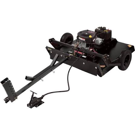

I have all the parts and would like to repair the motor as I feel this unit will require the power of a 20hp engine if it is to cut the fields I need it to cut at my property in Vermont. I do, however, own a Swisher rough-cut mower and it works fairly well on flat ground.
(Image off the web)
However, it will not travel over terrain that has dips without getting stuck. The reason I wanted to locate a narrow-base Mott mower. The Mott also seems to leave a smoother, more mulched path of material behind whereas the Swisher leaves a knocked down mess you still need to go back over.
