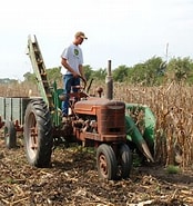

Here's a really good one!
Although ear corn is not as heavy as shelled corn, I would be wary of taking that picker with an overhead bin onto a steep contour rowed hillside.
