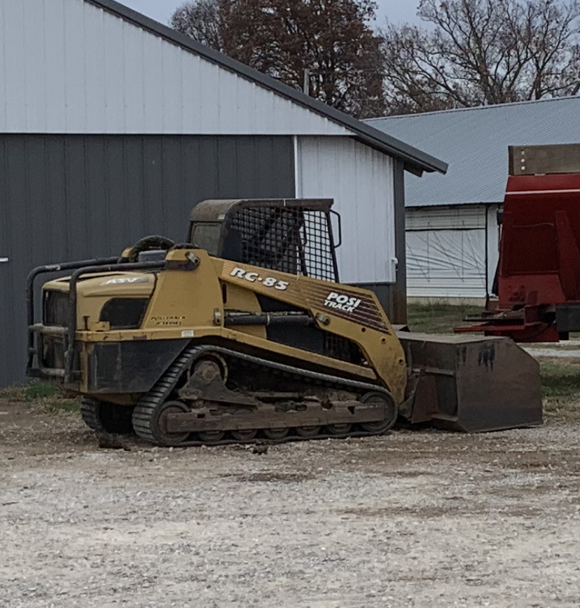

A bit different as mine has tracks an weighs nearly 10,000 lbs
Had a drive motor lock up once, had to remove the track tension adjuster and drive table guide stops, then pull it forward to slide the drive table forward releasing track tension. Once the drive table is far enough forward it can be pined to a bracket on the frame and swung out once the track is lifted off the sprocket
Once this is done one each side the tracks will free roll so the machine can be towed, but on a grade it will free roll until something stops it
