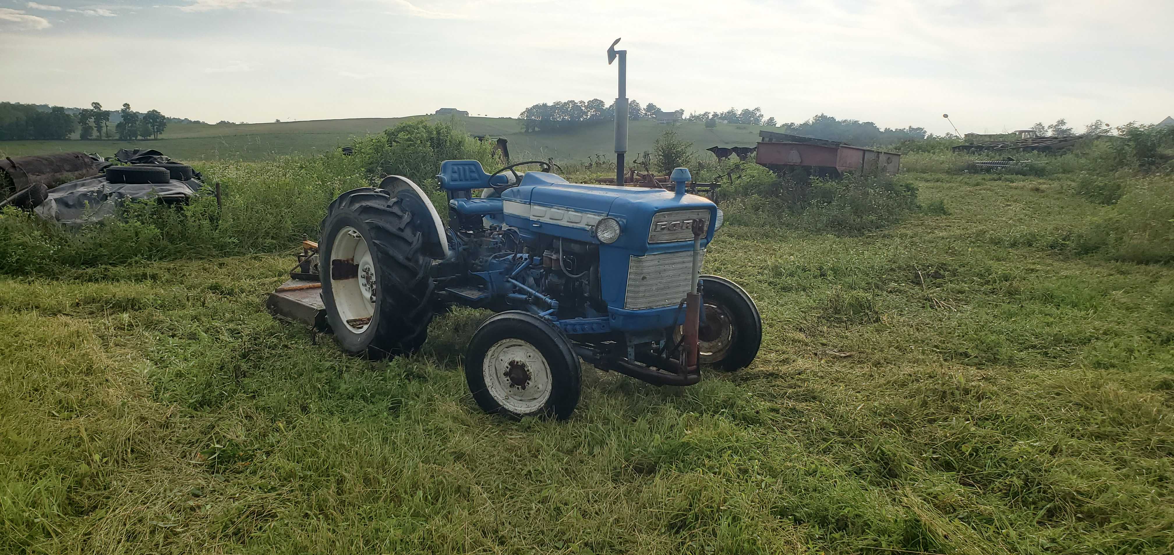

Was driving up around the scrap pile about 2 weeks ago and caught a cultivator wing laying in the grass with my UTV, so I decided then that the 3000 would be on bush hogging duty once it was ready.This little 5 footer was on the back of my brother's 655, and I was initially going to run it through all this, but 16 horsepower (and it being down on power on top of that) isn't really enough to cut grass this thick so it struggled. I ended up giving up after going maybe 100 yards in low with the engine nearly dying.
Sealed up the steering cylinder, which was a total pain because the plastic rod guide absolutely WOULD NOT come out. Ended up having to break it to remove it, and then the seal came right out afterward. Filled up the reservoir with the last of the oil I had, and it doesn't leak anymore luckily.
Bush hog went on, and I ran it for about an hour mowing around the scrap pile, and while doing that I noticed that the tractor HATES full throttle. When you start giving it throttle, it'll start blowing some black smoke and will slowly drop to about 1200 RPM unless you bring the throttle to idle and then throttle it back up. It also seems to run hard like the timing is off, almost like an injector is hanging up. Either way, 1200 RPM is about the most you can get out of it without having to constantly adjust the throttle lever.
It's going to need a fuel system cleaning and a good going through but as of now it's still usable, just a bit slow.

View attachment 156953Was driving up around the scrap pile about 2 weeks ago and caught a cultivator wing laying in the grass with my UTV, so I decided then that the 3000 would be on bush hogging duty once it was ready.This little 5 footer was on the back of my brother's 655, and I was initially going to run it through all this, but 16 horsepower (and it being down on power on top of that) isn't really enough to cut grass this thick so it struggled. I ended up giving up after going maybe 100 yards in low with the engine nearly dying.

After the previous post I made where I mowed around the scrap pile, the tractor refused to start. Wouldn't run at all and wouldn't even smoke when turning it over. Turned out that the inlet screen on the injection pump was clogged nearly solid, and was only letting the tiniest amount of fuel into the pump, just enough to run but not enough to run well or actually start up. It starts fine now but still needs the injection pump to be bled every single time it sits or else it won't start.
Mowed the scrap pile again the other day, and today I mowed around a super grown up part of the farm where we have a bunch of old school busses. It did a surprisingly good job, even though was struggling from how thick the brush was, but I'm sure the 655 would've needed 5 passes to mow it all.Going to hopefully be picking up a parts tractor here in a bit because the select-o-speed is rapidly falling apart and is acting stranger and stranger, the clutch pedal doesn't fully stop it anymore, it creeps forward in reverse, the PTO never fully stops spinning, and it seems to skip going downhill... Also, the stud that's supposed to hold the draft control linkage is missing which I think is causing my 3 point to never stay put, and it also leaks down like crazy.
