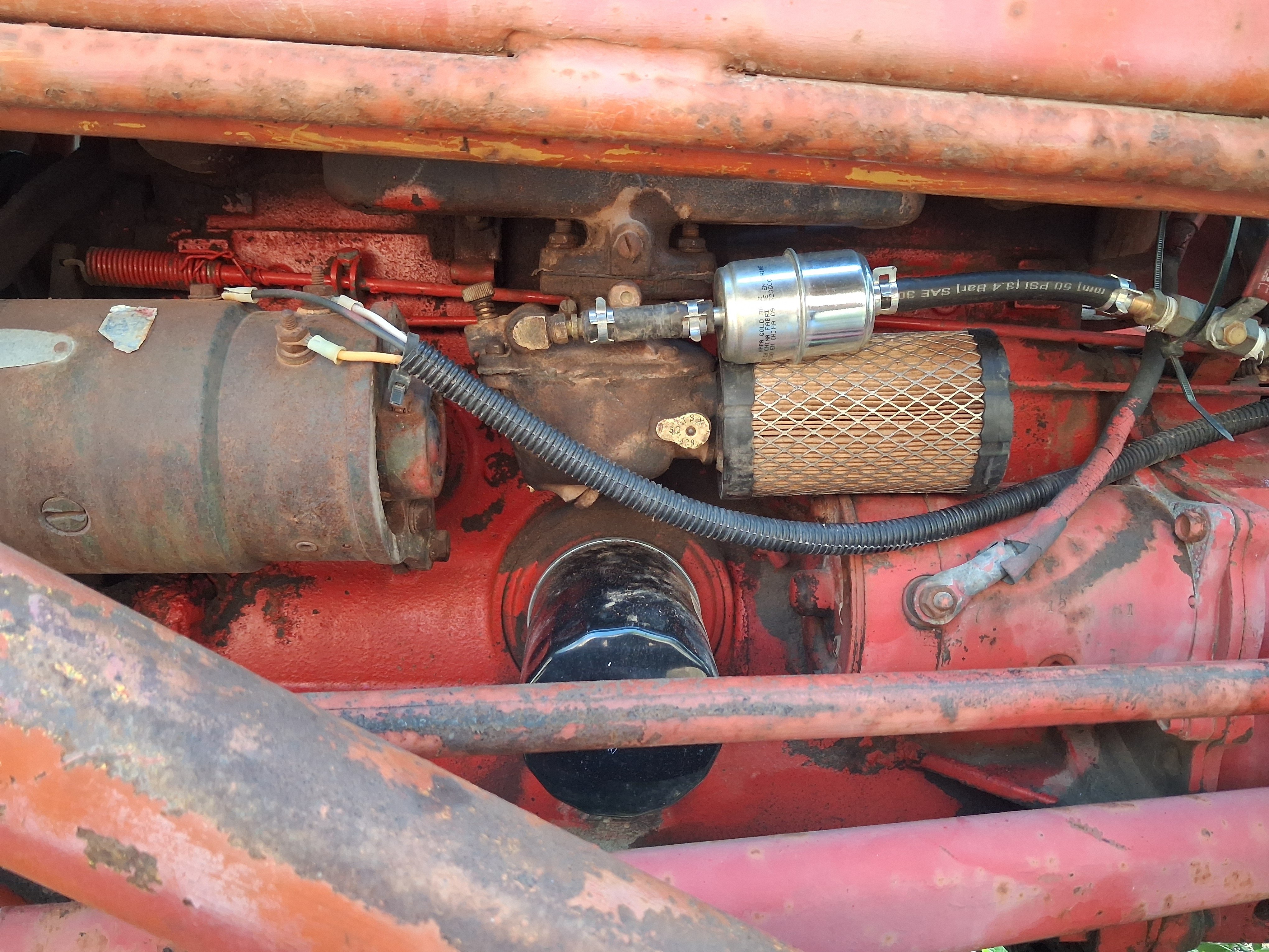

Sure it's possible as Sean says. When I bought my Ford 840 years ago someone had replaced the stock filter with a dry canister filter but I put it back to stock. I think I still have it but it might be rusted out by now because I left it outside. The simplest might be add a K&N cone filter, that would give your tractor the high performance look.Have the NAA. Is it possible to replace the oil-based air cleaner assembly with some sort of a dry air filter?
that is glorious.Probably not like this. But at least they put the fuel filter right above it, in case a signal fire is needed for a rescue.
IMO the oil bath air filters work more efficiently than any paper filter. K&N air filters have been tested many times, came up short in every test.i flirted with this, but went back to stock with oil cup. believe you me, i gave it good kanoodling but in the end i figured there prolly is some gomer air/fuel ratio that only works with the stock setup so after all that goober goobin i cleaned out the stock parts and put em back on.
ya thats the conclusion I came to as well, after throwing a bunch of coins at 'creative' solutions for tucking the paper k&n cone element under the dash etc with elbows, etc, I figured for what my ugly rig will do, its just better using the regular layout for this specific era of tractor.IMO the oil bath air filters work more efficiently than any paper filter. K&N air filters have been tested many times, came up short in every test.

ya thats the conclusion I came to as well, after throwing a bunch of coins at 'creative' solutions for tucking the paper k&n cone element under the dash etc with elbows, etc, I figured for what my ugly rig will do, its just better using the regular layout for this specific era of tractor.![]()
