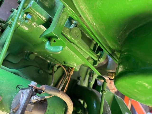

I've read a bit about the throttle adjustment on an AR. But I really don't understand how the throttle system works. I push the throttle forward to get full throttle, the engine speeds up, but here's where I lose it. I'm used to a throttle normally hitting a stop...that's it, no more. But on the AR, the spring set up baffles me.
When they say to increase the throttle to fast idle, I assume that means "full throttle? Then what is full throttle? When the engine speeds up, I can push the lever a loooong ways more which actually just bends the flat spring more.
I can't get full throttle without the spring pulling the throttle back and lowering the rpm. I don't see any way on mine to tighten the drag on the throttle lever itself. What am I missing here? I'm just not getting it!
Fast idle and full throttle to me means high speed no load. There is a cone on the lower end of the shaft that the throttle lever rotates. Downward pressure is applied to the cone by the spring under the throttle lever. This provides friction for the throttle linkage.
my 38' AR has a screw stop on the steering shaft support that limits the throttle handle travel. Don't quote me on this but your high RPM should be around 975, depending on year. you will probably need to get a rpm counter and put it on flywheel to adjust.
this is what ET is referring to. Not sure if you year is the same. I made the mistake of cleaning and lubricating the same on my 44' B and now the throttle is loose and will not stay at the desired speed. Guess i need to clean of lube and let is rust again! Maybe your spring is weak or broken.

Does your throttle handle move back and for very freely? There should be a fair amount of resistance to keep throttle where you want it. That spring should not pull back the throttle arm if the cone shaped friction area under throttle handle is under pressure of the spring that I showed in my previous post.

When your throttle is pushed full distance the rod to the carburetor should be a half hole short of going in the hole. In other words it should take a little effort to line it up. Ron MN

Finally found it A49deere! I had googled the adjustment before but hadn't used that exact wordage. That's probably the best explanation yet. Thank you everyone!
Just an update. Everything seems to be set right (as near as I can tell) so maybe it's in my throttle friction. Not going to mess with it now because my steering pedestal was broken at one time and I want to get a new one. The throttle handle was broken also so I want to replace that too. Altho everything works, I'd like to get rid of that bird droppings looking welding on the cast iron!
