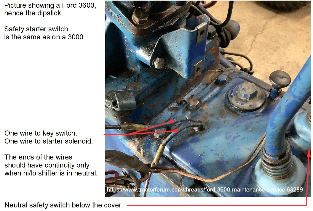

8. Connect one of your volt meter leads to the starter solenoid wire from the key switch, and the other to the starter solenoid wire at the starter. Ensure that the tractor is in neutral and check for continuity through the wire.
a. If there is no continuity, the neutral start switch has failed or is faulty. Try wiggling the shifters around to see if you can get continuity. Replace or bypass neutral start switch.​
b. If there is continuity, reassemble and attempt to start the tractor. If tractor starts, your neutral start switch may still be faulty but it managed to get into a good position for the test. Recommend replacing switch or bypassying anyway. If tractor still does not start and there is continuity, report findings and we will go from there.​

Thank you. Is there a schematic online that you're aware of? Also, I assume the neutral safety switch resides between the key and the solenoid? So you're suggesting bypassing the neutral safety switch directly to the solenoid?
Bypass it and if the tractor starts you need to replace the neutral safety switch.
