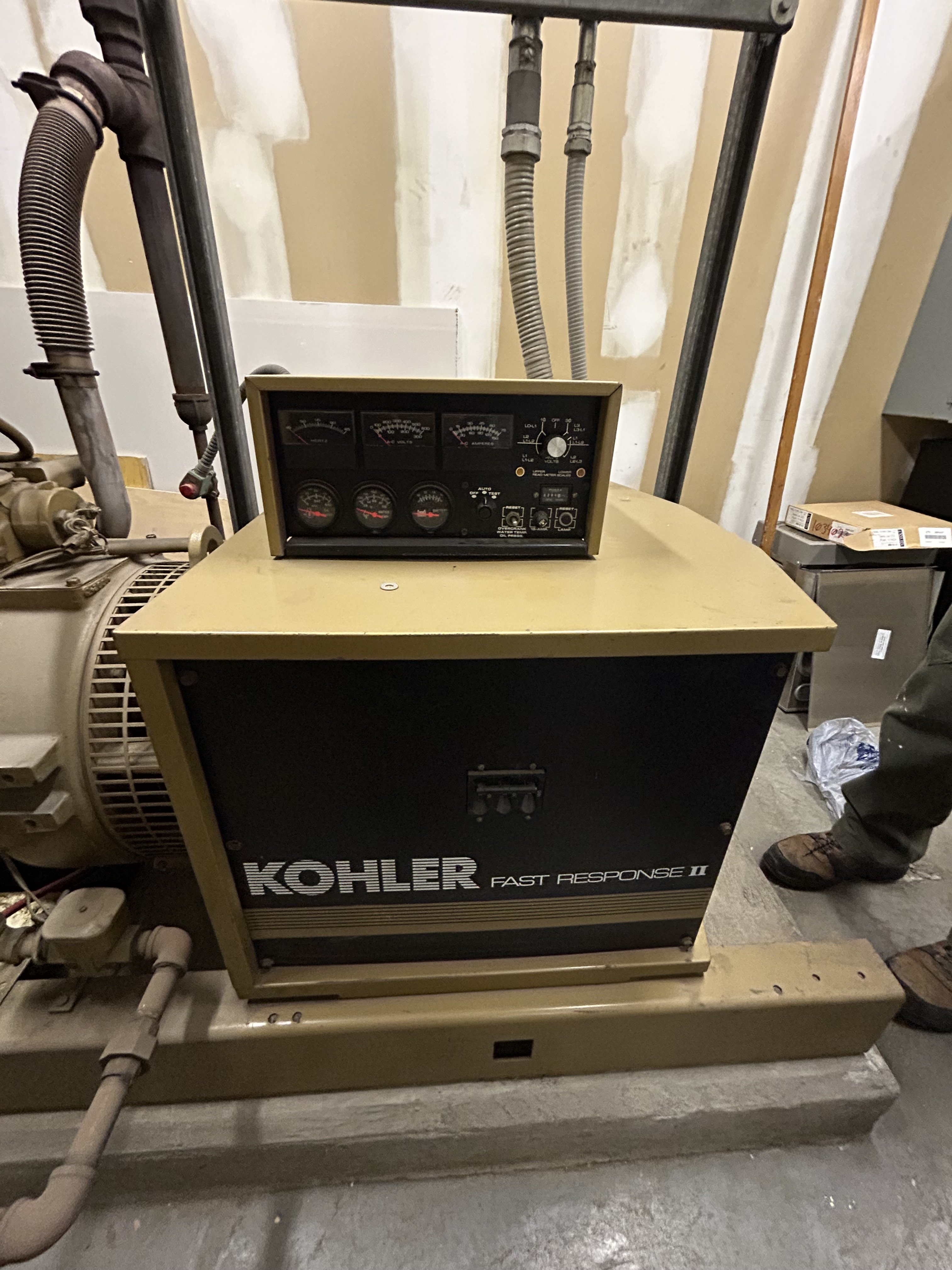

Hello Steeqr, welcome to YT! In addition I see an hour meter on the panel below the knob with the silver center. Knowing the tally shown on it would be helpful to give you an idea of how much it has been used. It is not quite clear enough to read when exploding the photo.If anyone knows anything about this setup please share.

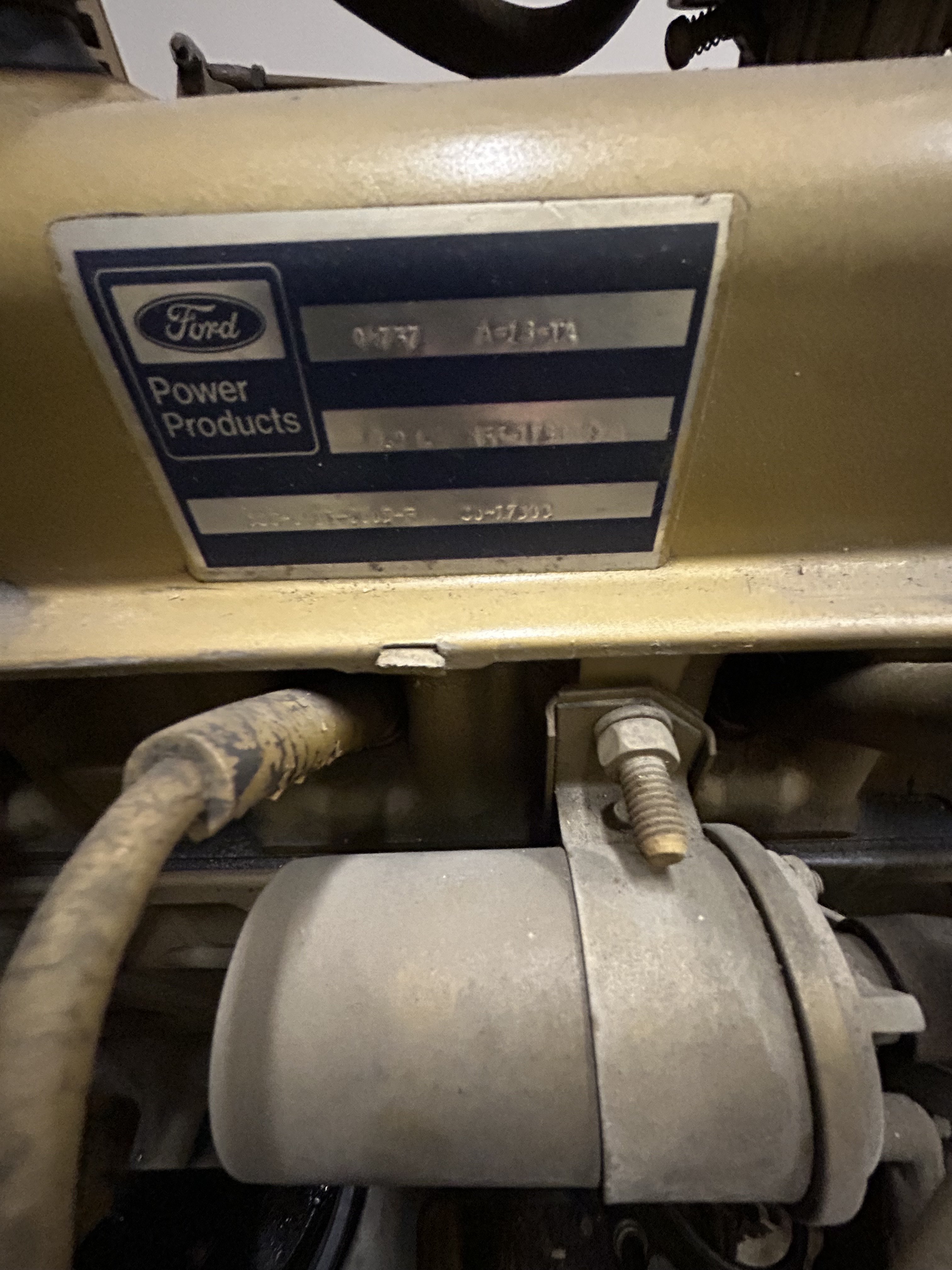

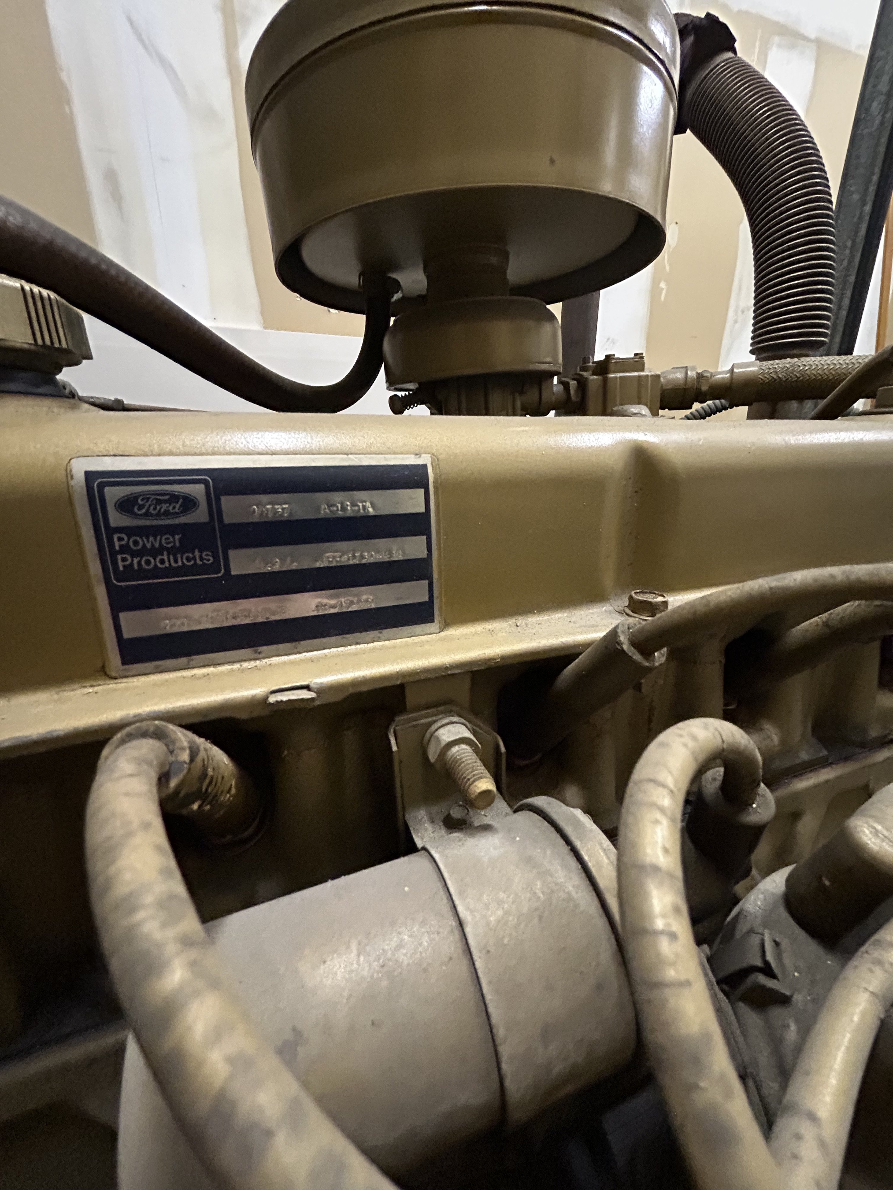

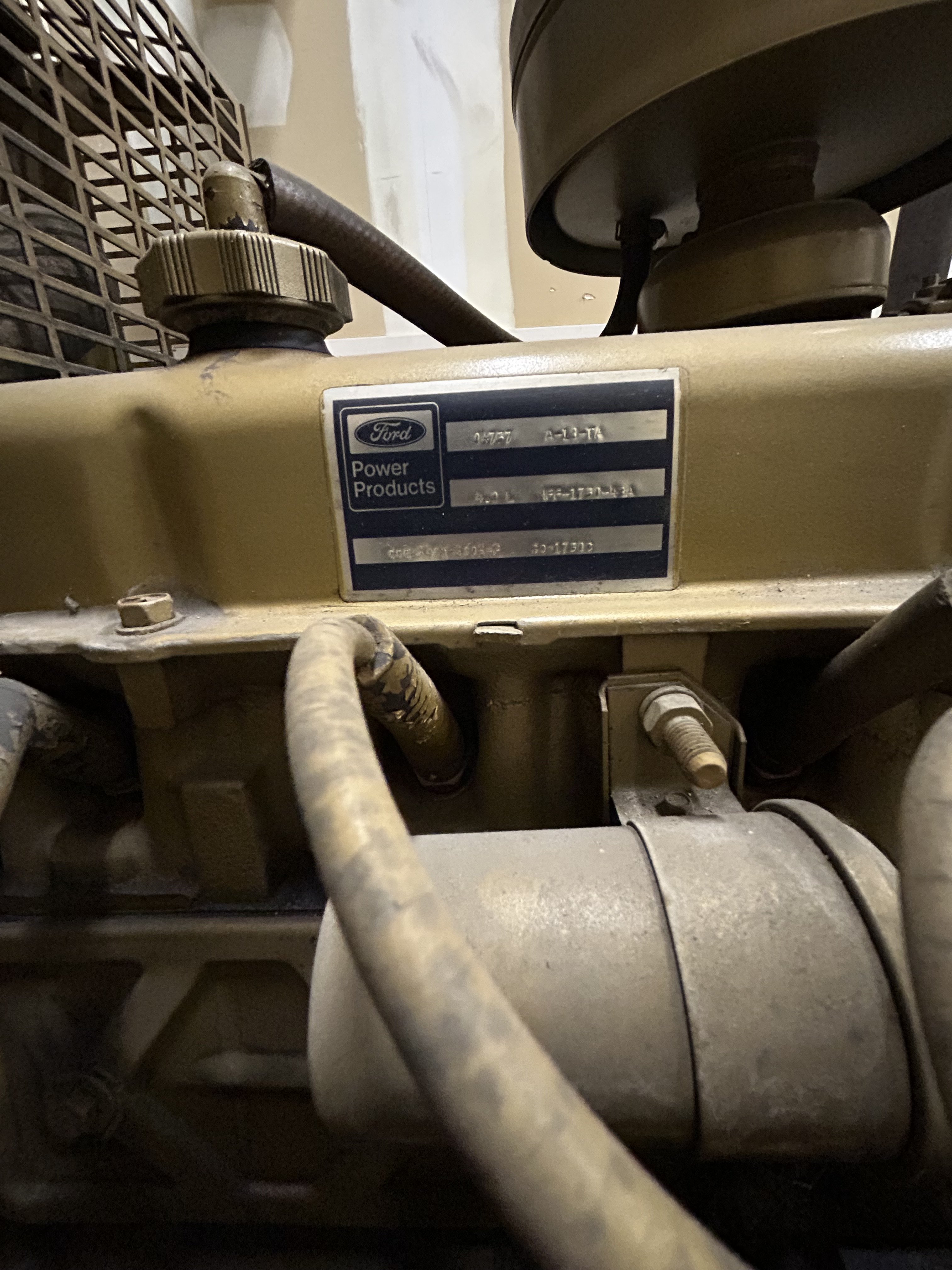

If you had pictures of the info tags for the generator it would tell what it produces for power.

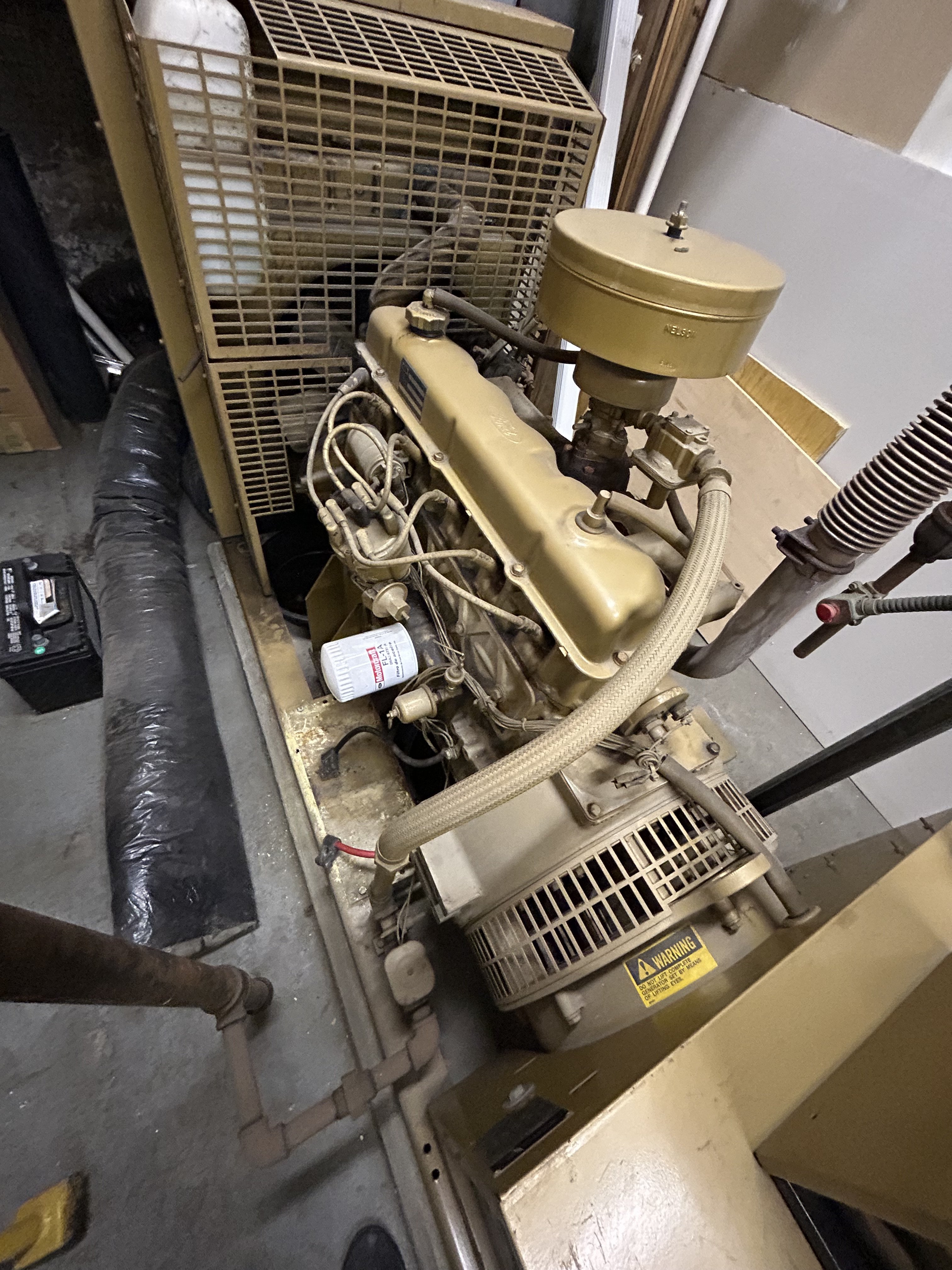

It appears to be a Ford 300 (4.9L) 6-cylinder engine fueled with either propane or natural gas, likely used as standby power.
Searching for Kohler Fast Response II with a Ford 6-cylinder engine turns up: 45 KW, 120/240V three phase, 167 amps. Again, the pictures of the generator tags would confirm that.
