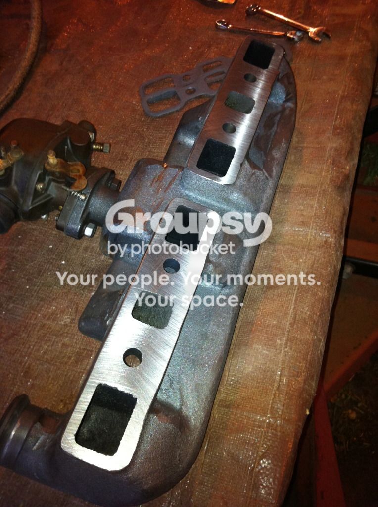

I just installed a new exhaust manifold on my 8n. Maybe it's just me, but it sounds louder than I would have expected. I can still hear detonation or what sounds like leaking at the manifold but it's bolted down tight with the applicable new gaskets in place.
Is that normal? Maybe it's just normal sounds?
Local expert who deals exclusively in N tractors and sells new and used parts says he is having a problem with the quality of the new manifolds. He was telling me that many of them are twisted and either had to be machined again or sent back. Said the surface mating to the block was not flat or straight. Might ck and see.

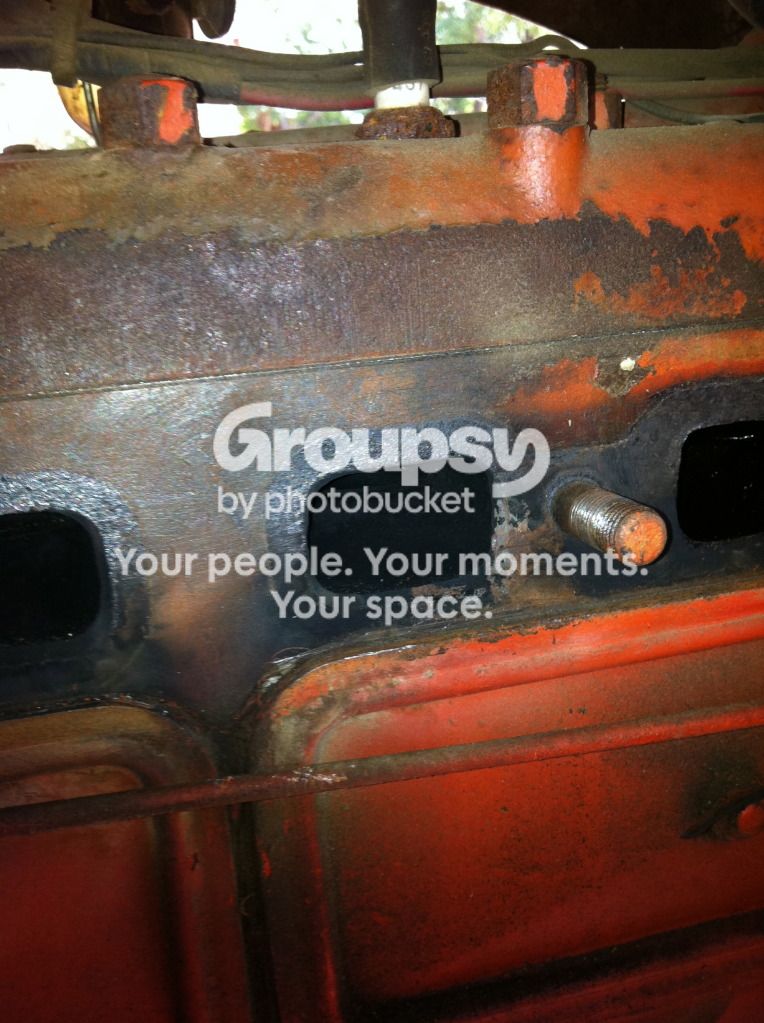

Well, I figured out what the problem was.....
The lower side of the manifold was actually resting on the top edge of the lower side block access plate rather than on the block itself. It was such that you couldn't see it when you looked. Everything looked normal.... It wasn't until I pulled the manifold off and looked closely that I could see new soot marks on the block, odd markings on the surface of the manifolds and, of course, the burned out section on the new exhaust exhaust gaskets.
We started comparing the two manifolds to see how that could have happened and found the lower casting on the new manifold to be thicker or wider than the original so no matter what we did, it would not clear the access plates. GADS!! Anyway, I took the manifold over to a local machine shop to have it planed again just to be sure it wasn't warped or otherwise not perfect and made the trek to Tractor Supply to get a new set of gaskets.
My buddy is grinding down the lower outer edge of he manifold to insure it clears the plates. I supposed I could have removed the plates, installed the manifold and then reinstalled the plates but I didn't really want break the seals on them. I'll be putting it back together either this evening or tomorrow and will let you know how it goes.

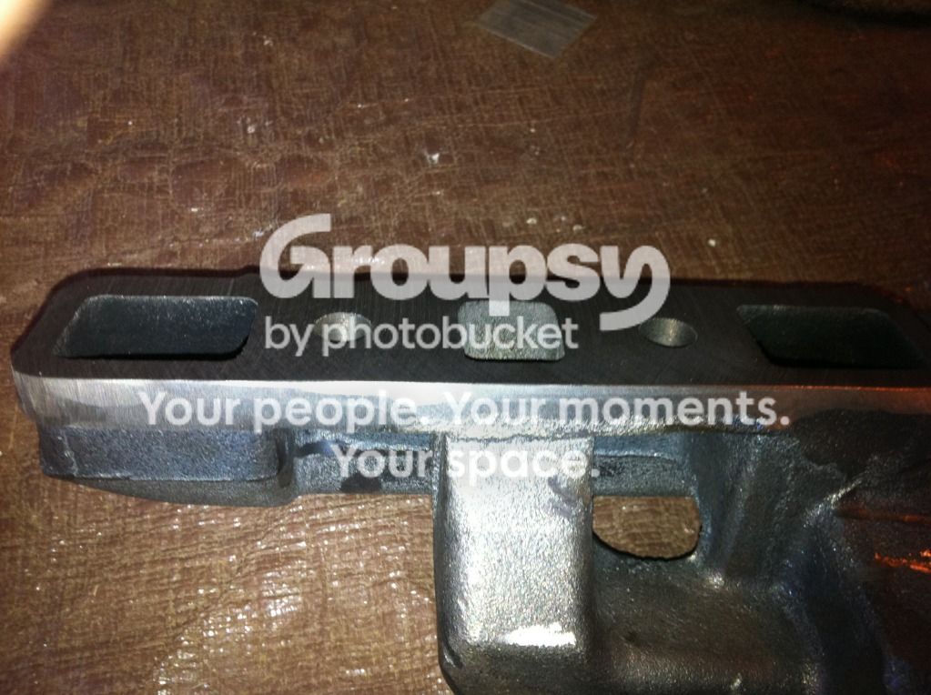

Since I had it tightened down while not flush to the block and then it was run for a while, it's entirely possible the extended exposure to high heat could have wracked it.....so rather than risk going through the whole exercise again, to order online or drive 25 miles for yet another set of exhaust gaskets, etc, etc, etc, I opted to err on the side of caution, to run it across a planer and KNOW that it's right and be done with it once and for all.....or until it needs it again, whichever comes first.
Pretty, eh?
UPDATE: My buddy took his grinder to the lower edge of the port openings to insure it would clear the side access plates (aka valve covers :wink: ).
I cleaned up the block surfaces and mounted the new manifold again, this time making double sure it cleared the valve cover plates. With everything put back together and tightened down, she started right up! She ran a whole lot smoother than before when it was sucking exhaust air. We fiddled with the carb settings until she was running optimal and quiet. She ran great at all speeds and sudden throttle adjustments.

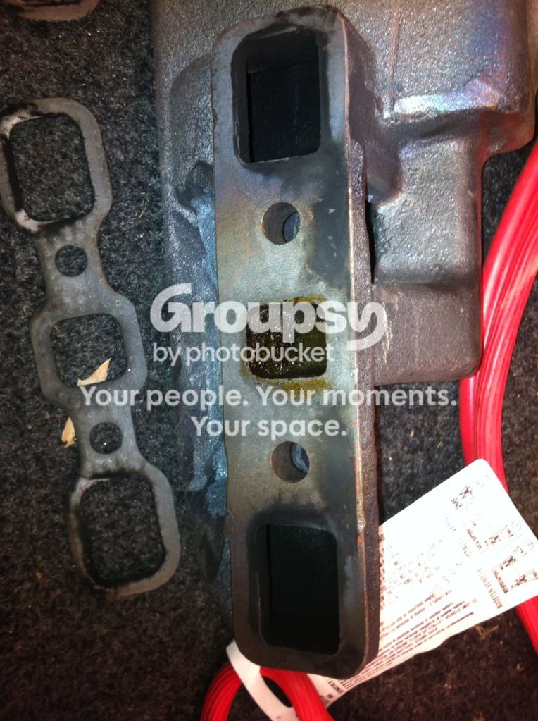

This shows where I had to grind. I had put the manifold on before the valve covers. then the covers would not go on. the studs were not bent and I don't think I could have bent them enough to work.
(quoted from post at 09:00:51 05/09/12)
Wow, yours was really off. Mine wasn't as obvious as yours. We did the same thing by laying the gasket out and grinding down to it. We also had to grind out two surface areas inside the bolt passages to get the socket head to clear.
