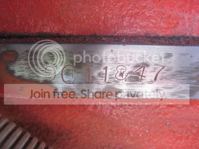

I looked for the serial number on the left side of the block and the following photo is what I found... Looks altered. It either says 9C11847 or 9011847.

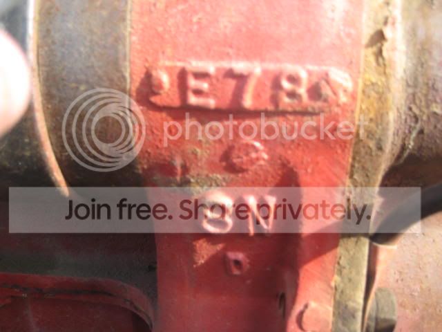

It also has this cast into the block:
My theory is maybe sometime in its life they swapped the engine with an 8n and then ground the old serial number off and transfered the tractors original one to the block but instead of putting an 'N' after the number 9 they put a 'C'? Any help would be great. So my long reaching assumption is that the serial number is 11847 and that it is a 1940 Ford 9n. What do you think? Thanks!
Jay
jbyrd.......congrats, you have the "braggin' rights" to re-numbered engine 11847. It was cast May 7, 1948. The ONLY thing you really need to worry about is whether the engine is 4-nipple frontmount dizzy or 5-nipple sidemount dizzy ...and... ALL 9N's have 3-speed trannys, 8N's have 4-speed trannys. Early 8N's have 4-nipple dizzys and 1950 8N's have 5-nipple sidemount dizzys. Otherwize, engine s/n's don't mean 'nuttin' unless yer being TAXED or the sheriff is lookin' fer stolen tractor. (it happens) .......Dell

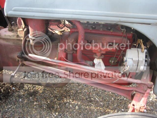

Dell - thanks for the info. The following picture is of the right side of the tractor that I took a few weeks ago before i bought it. Tractor is at work right now so I can go and look exactly where the distrubutor is. Don't see it sticking out on the rightside so it must be a front mount correct? What are the advantages/disadvantages of a front vs. a side mount?

The front mount distributor.I beam front axle supports, Clamp-on front spindles, all indicate a 9N, probably a 1940. The serial # appears to be altered and is not the original and is an early front mount distributor 8N. The governor appears to be a 9N governor and something has been done with the oil line from oil filter to governor (normal) to now the valve cover. all of this is just facial and has nothing to do with the performance of the tractor as all things are a common innerchange. The only thing to watch for is "What is it adverized as" There also seems to be an altered serial # and I think I see a hint of the old # that has been ground off.

It MAY have been sold as a rebuilt engine at one time. Engine rebuilders have been known to stamp their own "code" on a rebuilt engine to identify it as one of "their's" for warranty purposes and to identify it's assembly date and assembler.
