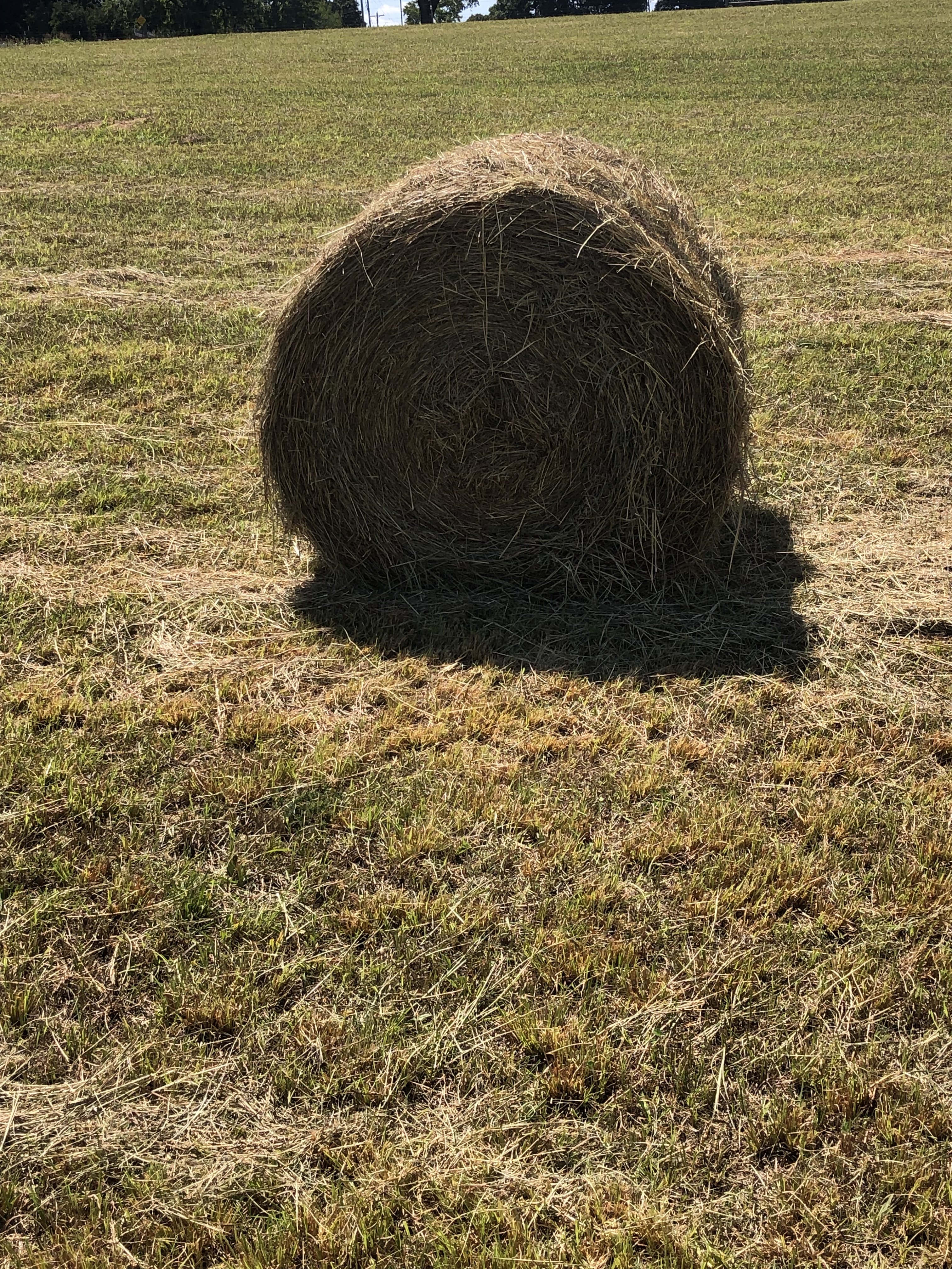

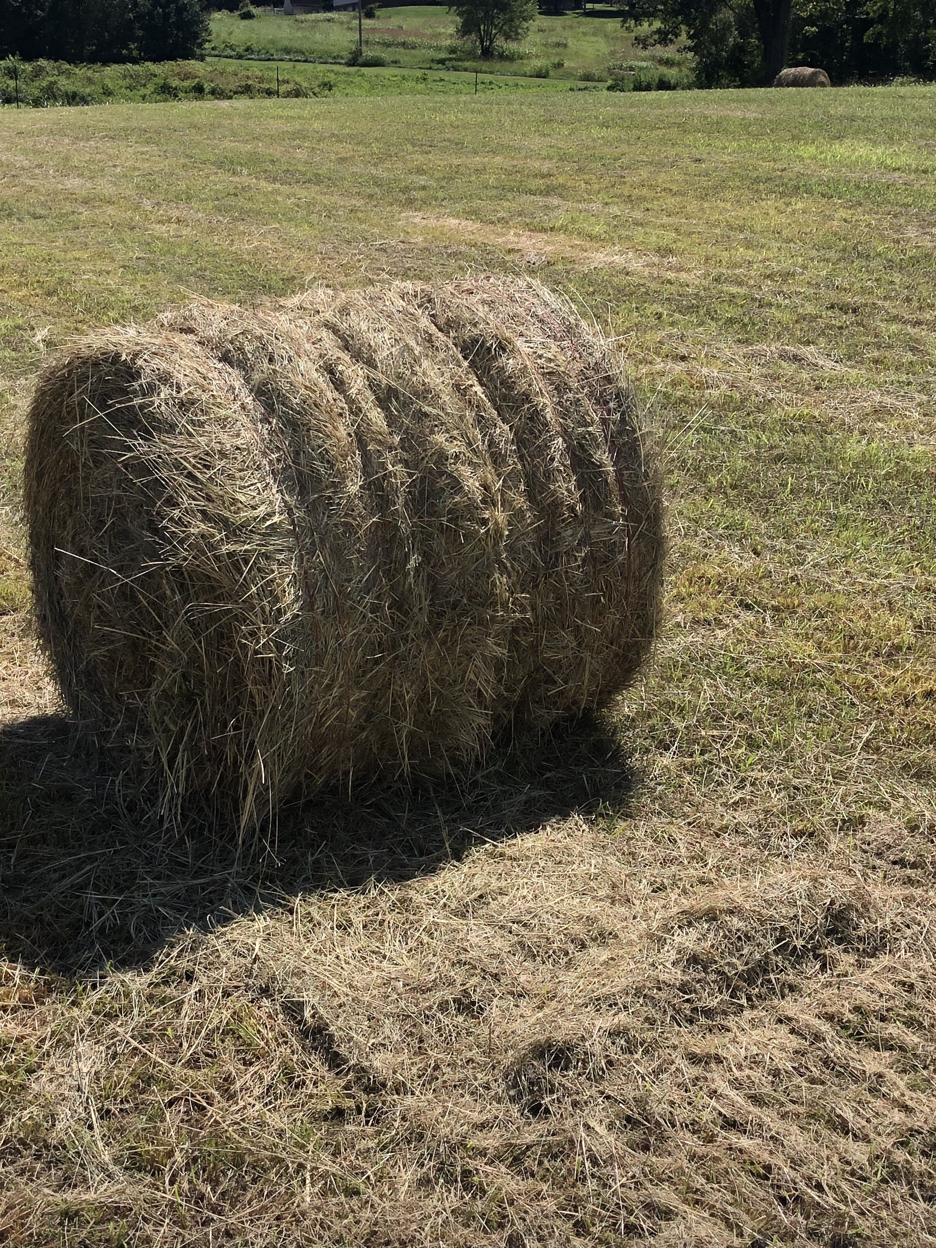

Bales are shaped pretty decent. Some are okay and some are shaggy looking. Wondering if speed or length of hay would make a difference.
Show us a picture of each, the good looking bales and the shaggy ones.

It is electric manual tie. Use same routine on each bale. Will get pictures when I bale tomorrow.

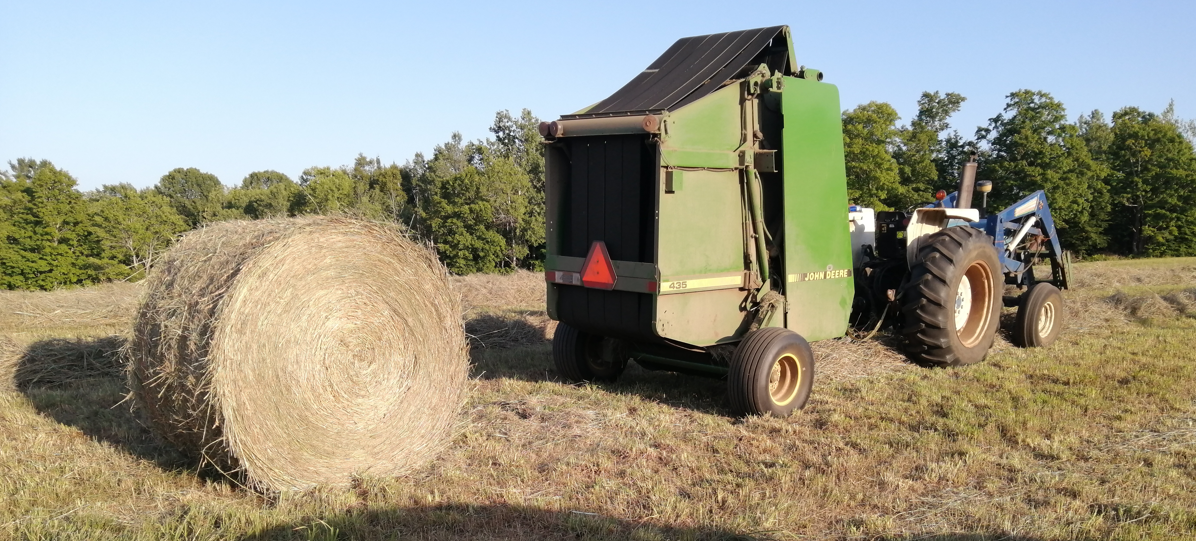

Further to my last reply: The last time I posted about that (and later when I posted that you can make a good bale out of a poorly-raked windrow) a lot of folks responded that they didn't agree, and even more people responded saying you need a perfectly-raked windrow to make good bales. I took this first picture to prove my point: This was baled with an early 80's Vermeer 504G at our Southern farm - no monitor, manual rope-pull tie. About as crude a baler as you can get. My father raked the hay. Although I'm always grateful for his help and I wouldn't have got it done in time without his help - his raking leaves a lot to be desired. Done with a single rotary rake, and windrow consistently varied from almost nothing to choking out the baler.

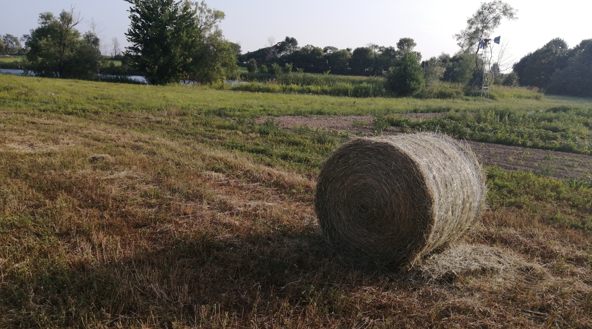

Second picture was baled with the Deere 435 at our Northern farm. The White 2-105 we usually bale with had broken down, so I put the baler on the 6600. My brother was all hot/bothered to tear apart the dash of the White to disconnect the monitor and move it over, and I told him I could make good bales just fine without a monitor (I took the picture in one of our most inconsistent fields to prove my point and rub in his face later). That would have been raked with a Deere 670 bar rake.
Bottom line: You don't need a fancy baler, nor a perfectly-raked windrow, nor great/consistent hay to make a good bale. Sticking to the edges and spending as little time in the centre as possible is the real key.
