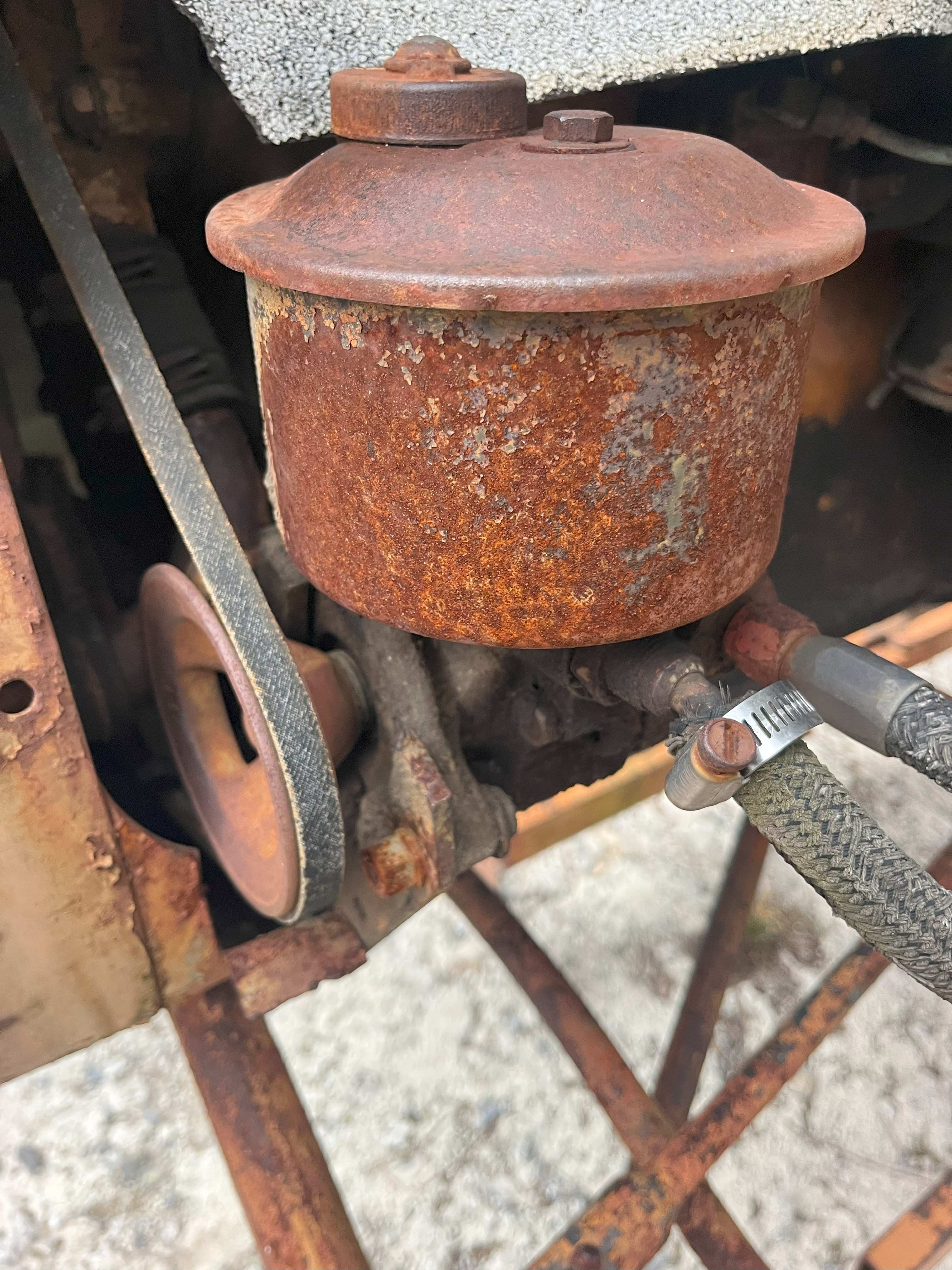

Show us a couple more pictures of that hydraulic valve and the pump. That valve looks unique and probably has some additional static weight for traction. Looks like it has some fairly decent tires on it. By your description I assume this was a fairly low budget purchase.

Price was $Free.99 plus I had to drive 50m to get it. Don't know if hydraulics were original and don't know if the valve is going to work. The lever won't budge at all. Pump still has oil in it and the hoses aren't too bad. Don't know if the cylinder is salvageable either. Just noticed yesterday there is a lub leak on the left axle and pto shaft. Anyway, I'm interested in getting started on it. I'll have to move things around so's I can get this one inside somewhere. Thanks for advise and for looking, Michael

That’s not the original style hydraulic valve or pump. The original were mounted under the seat and pto driven. Looks like a well thought out addition to the tractor though and probably handier than the original.
