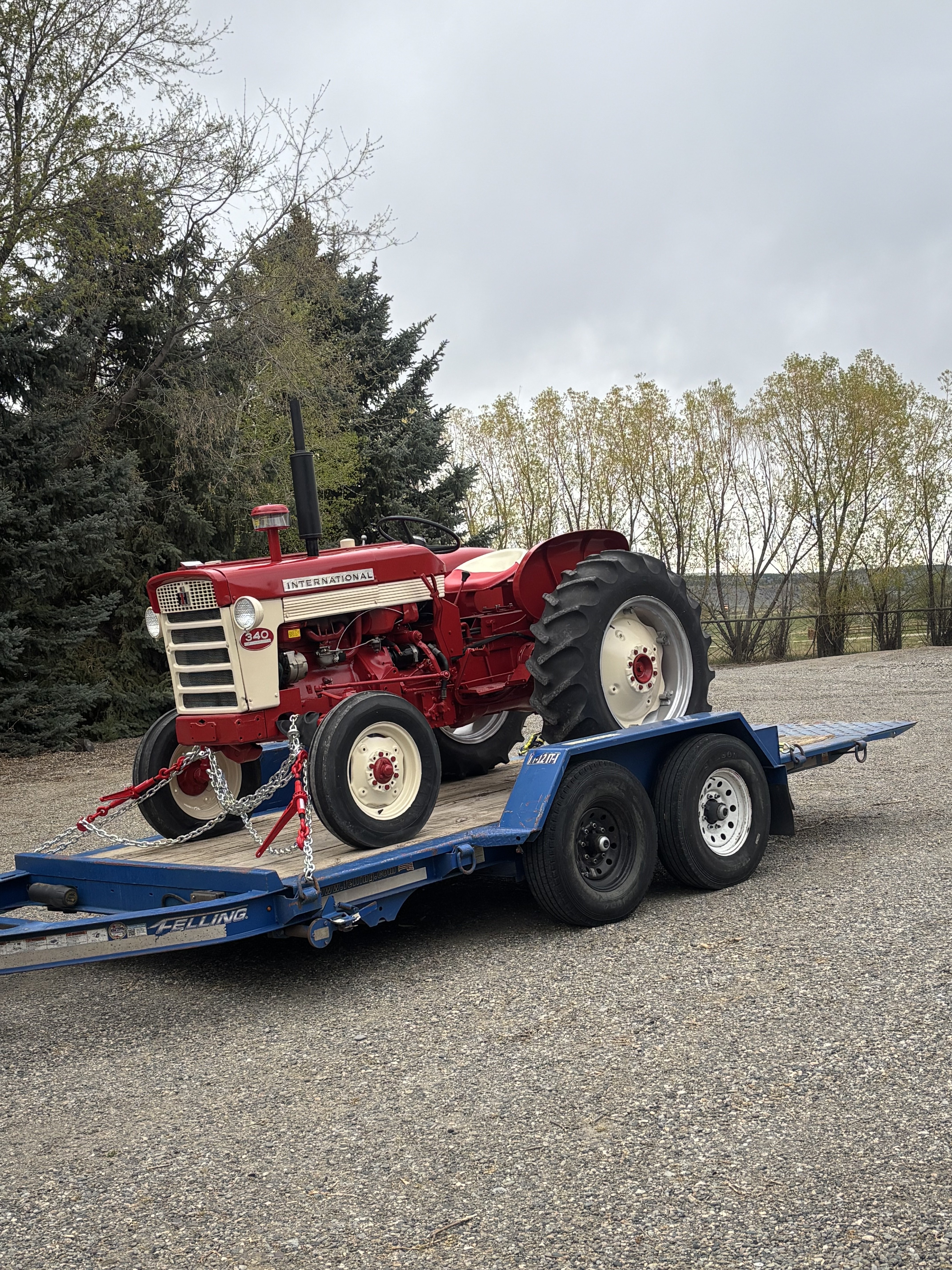

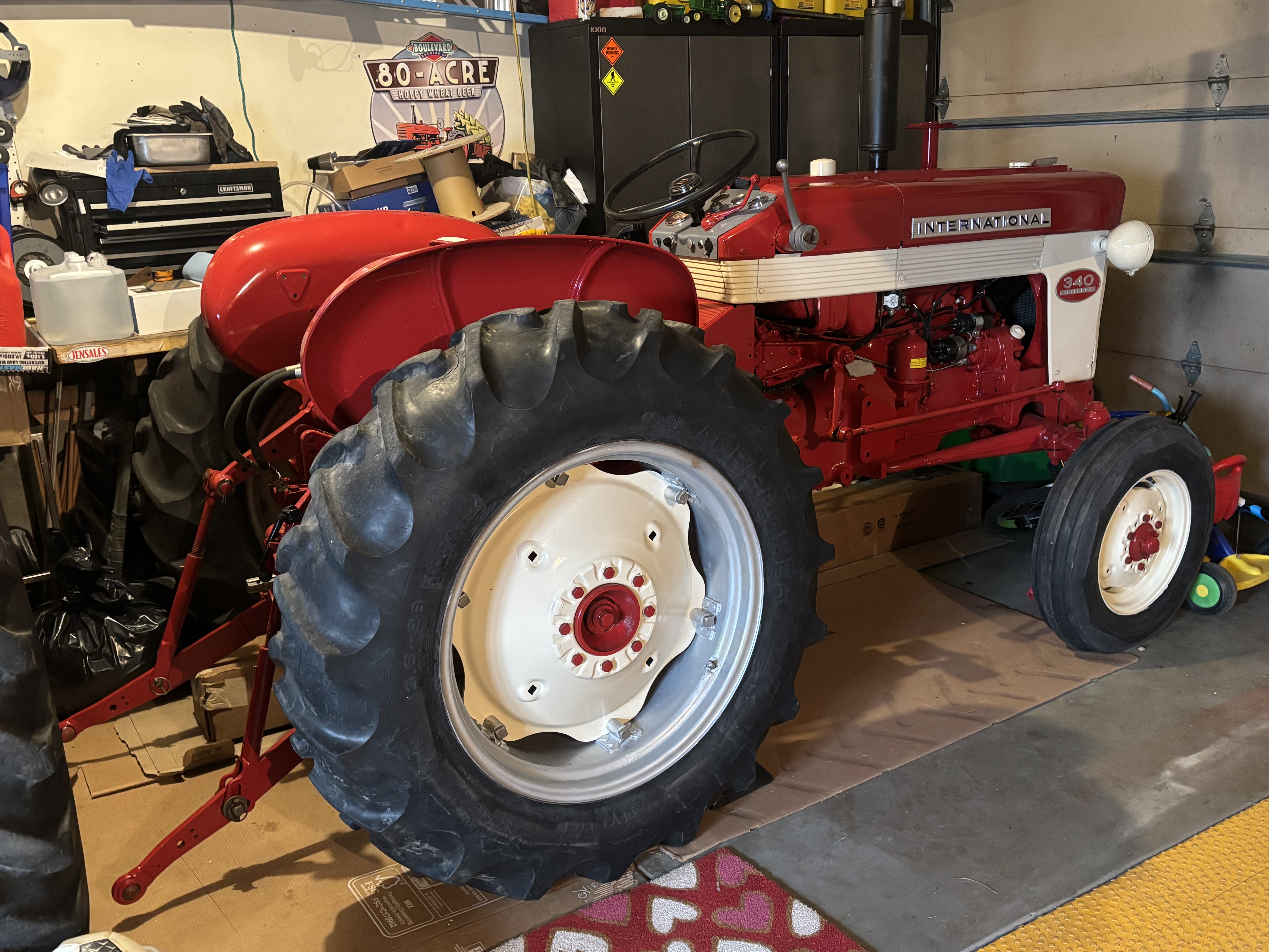

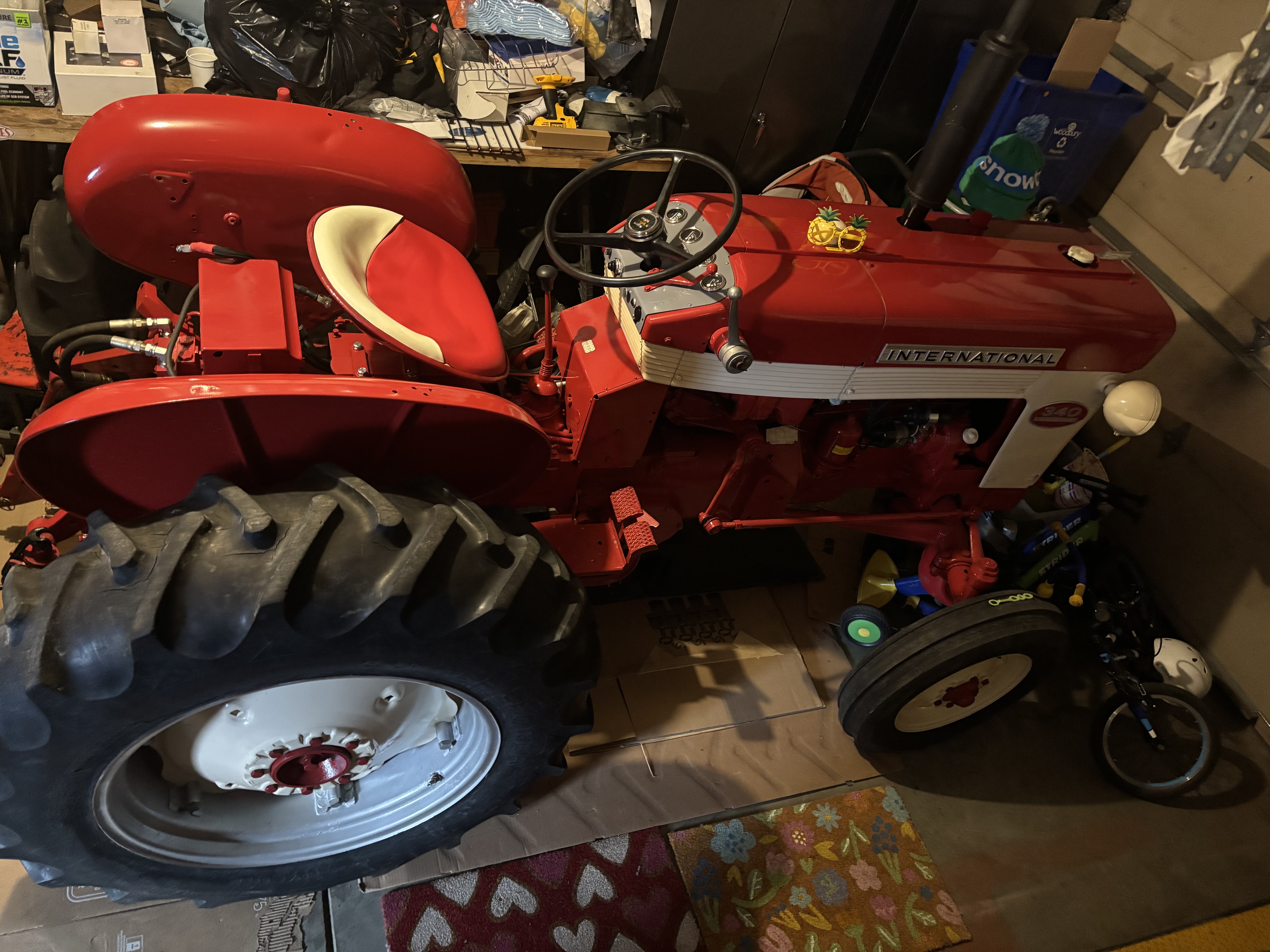

Thought I’d share a happy occurrence that is relevant to this forum. I only have space for utilities and brought an International into the family this weekend. Took a journey to grab it and drove back through snow and rain to get home. It is well cleaned up but needs mechanical attention to the hydraulic whine and poor running (rust chips in sediment bowl). I look forward to getting my hands dirty and solving the problems by following the steps I read on here while the necessary manuals are on the way.
Thanks all for posting help and general tractor talk for me to read and learn and in most cases smile
Hope a few pics show a bit of thanks. Nevermind the mess, it’s a work in progress I am sure most of you can appreciate

Nice haul. Don't know anything about this model but a whine in hydraulics usually means it's starving for oil, low level, plugged filter? Rust in tank, remove sediment bowl from tank, take a dog chain fastened to a stick and move it around the inside of the tank. Flush the tank out.

PO said he rebuilt pump and cleaned filter. Read the archives, found a bit about sucking air causing some whine, and there’s a leak around the system so I’ll go on the hunt soon.
Will try your method on the tank!
