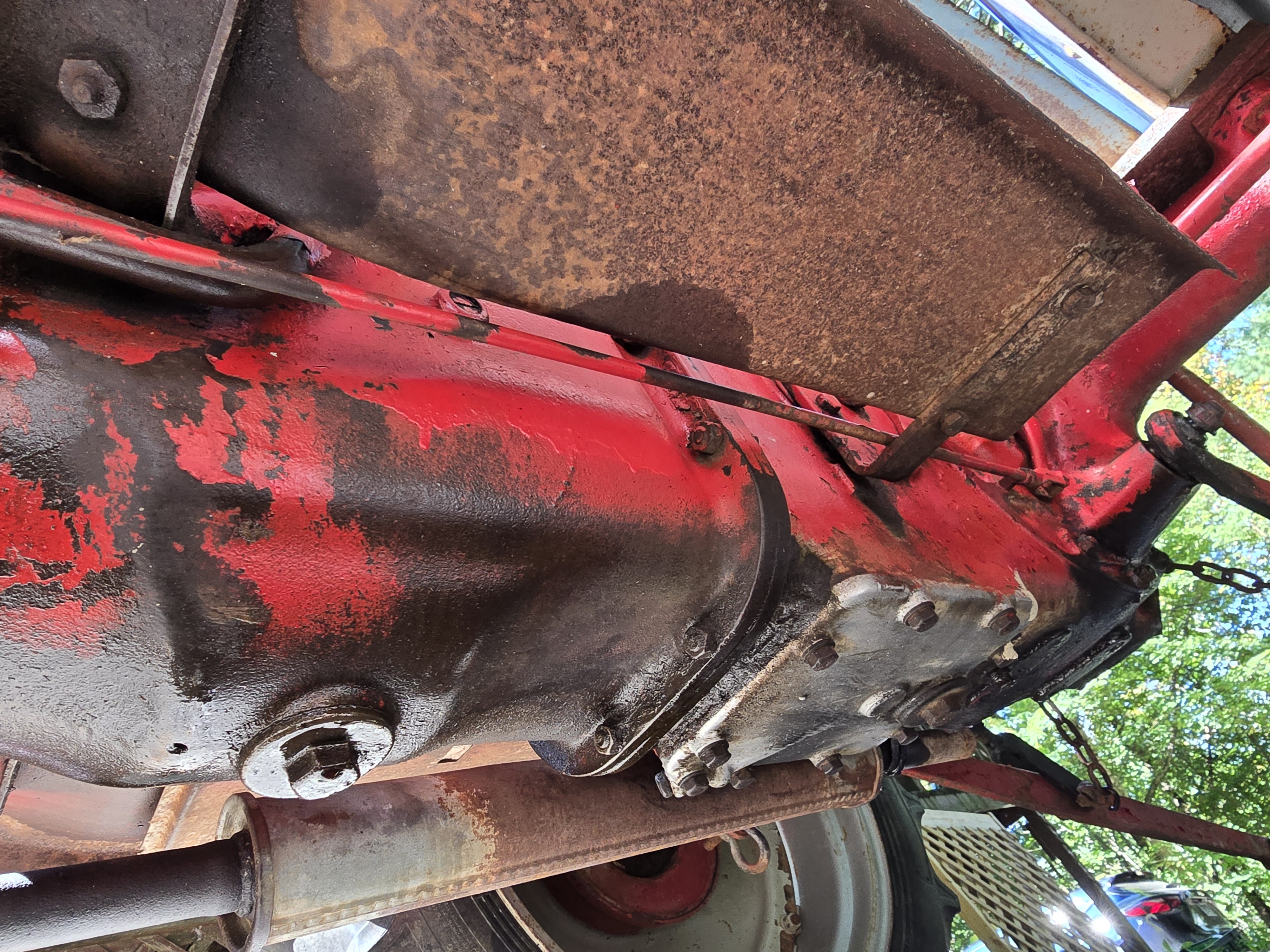

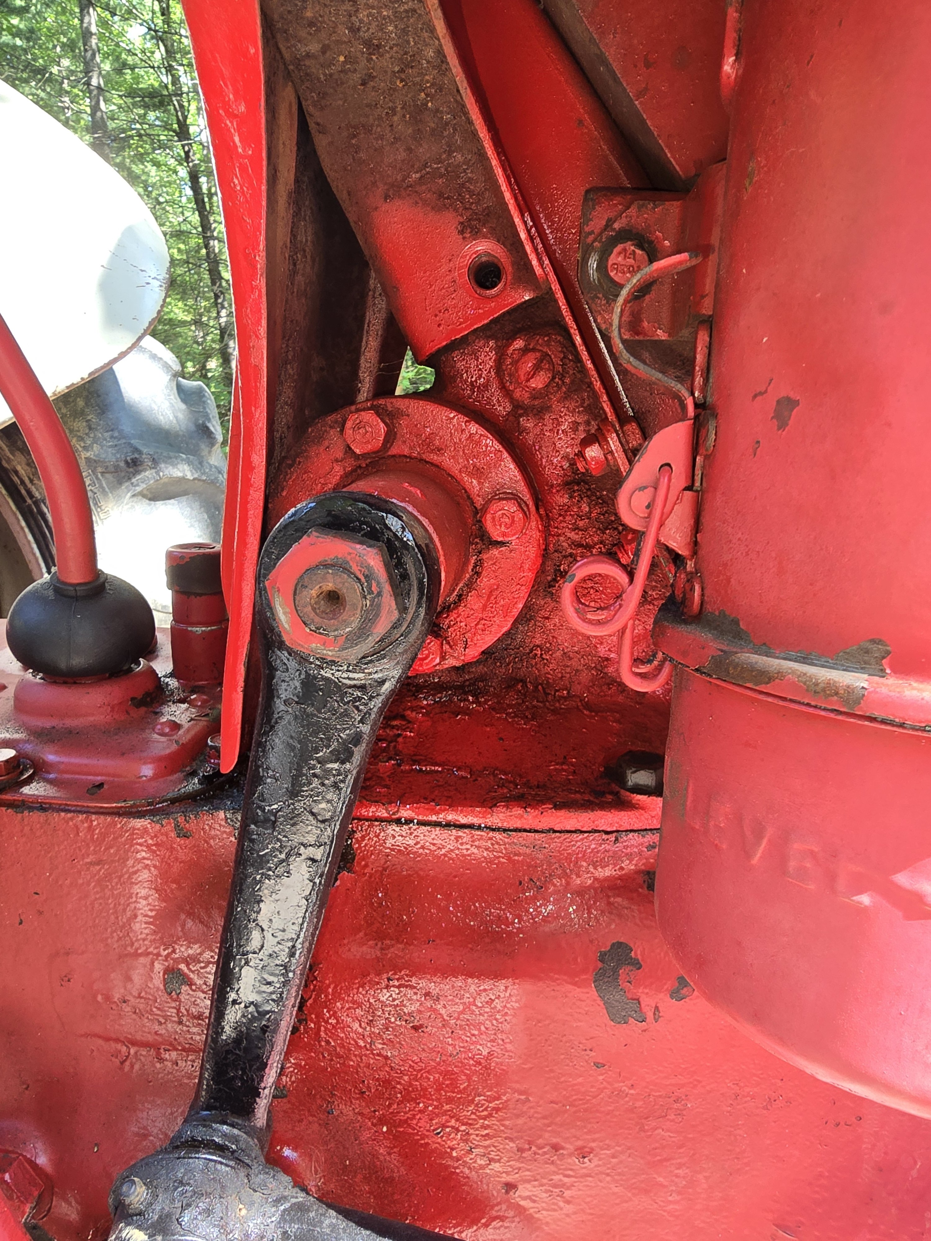

Hi, just acquired an 50-51 Ford 8N. It does need some love but does runs and drive. Are there any decent aftermarket parts for Brakes? Ive also got some leaks shown in the pics. Just wanna get stuff fixed before doin some grading.
Any help much appreciated.
I don't know what you expect from your brakes. I've owned several 8Ns and brakes are just so so even when new parts are in place. This site is a good source for brake and other parts.
As for the leaks, I place used carboard under my tractors to see where the source of the leaks are and if they are of great concern.

View attachment 164124View attachment 164125Any help much appreciated.
By the steering gear design you have a 1948 tractor.
If side distributor the engine has been replaced with later design.
Best insurance against bad brakes is a good front bumper, which I don't have...yet. Leaky axle seals are the biggest cause of poor braking. My '51 leaks around the transmission cover gasket. I have replaced it once and had to tighten the dog snot out of the bolts to keep it from leaking. Also the steering box still leaks because I neglected to replace the bushings when I rebuilt the steering box. When, excuse me, IF cooler weather arrives I have the parts to remedy the problem. Most parts can be purchased from this site. Nice tractor. I noticed yours has the older steering box.
Yeah, didnt realize it lol. Looks like its leaking from the cover gasket too, def from the steering area though. If its overfilled, would it leak out

Steering leak can be fixed by using corn head grease instead of gear oil, do the search and you'll find info on lubing box. My brakes only worked poorly when I had seals leaking and oil on shoes. I would go for the major leaks and go from there but see how the tractor performs first. Check all fluids and don't overfill the transmission/axle/hydraulics or you will lube the brakes.
