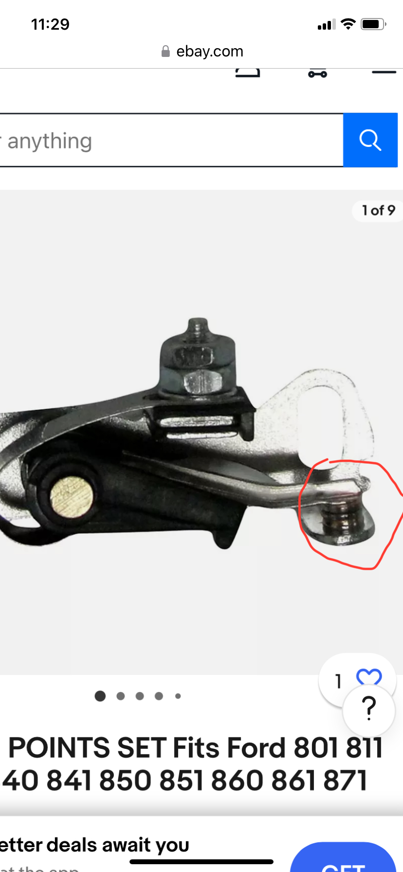

What am I looking for to see they are opening and closing?
Remove distributor cap, rotor, spring clip, dust cover to expose the points. When a high lobe on the distributor cam opens the points the gap should be .024 - .026", nominally .025. When cam is between high lobes the gap should close and you should have continuity to ground. Sometimes you might find the points welded closed. I bet you could find a YouTube video that explains all of this.
Circled in the picture.
