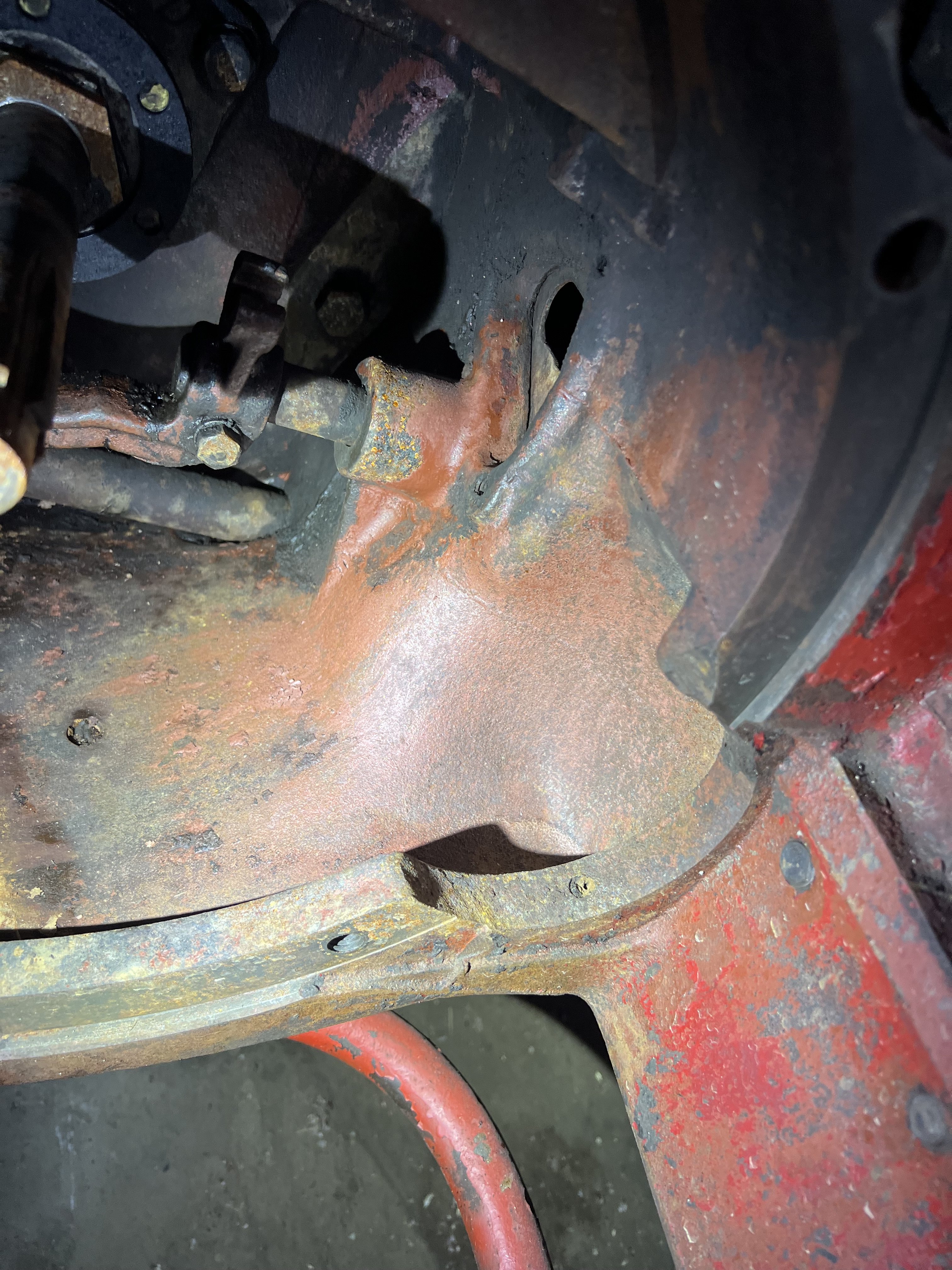

Working on an O-14 for a customer, rebuilding the engine and getting it running. One thing is, he is an older guy and doesn't really want to hand crank it if he doesn't have to. Does anyone have an idea on what starter we need? I've done some searching, and haven't found anything concrete, and the people haven't been on in years to message them. Also, would like to know where the battery box would have been originally, and how the generator was mounted if anyone knows. Thank you for any help you might be able to give. I should add, it already has the ring gear on the flywheel, so that isn't a problem there.
If it was born with electric start then the engine tub will have a bump out in it for a starter to fit. If it did not come factory with s atsrter then you have to get creative and build your own setup since theres no room to fit one between the engine and the tub

So to me it looks like it has the bump out on it. It’s not at my shop, so I had someone take a picture for me. Should only need a starter then… I might see how the Oliver starter will fit there.
