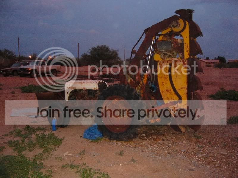

I had to use the "tinless man" to scrape down about 3 inches.
That go-kart gas tank sure came in handy. I may never put the tin back on :wink:

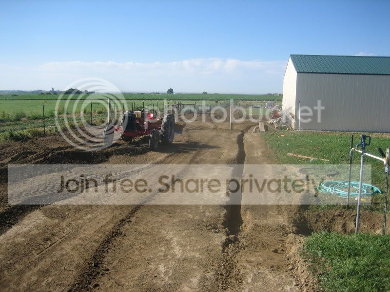

I have been reading on the internet that styrofoam blue board can be used to help insulate. They claim 1" is equivelant to one foot of dirt.
I am pretty worn out from digging some of it by hand. Hopefully next year it will all have grass on it like the pasture grass in the picture. I will have to keep the hay burners off that part for a year after the grass sprouts.
I will do some whinig at the rental center tomorrow since they told me it would do 36" (BS)...
Joe
80' of it was for the water line to the barn.
The oppisite direction I went 12" deep for 90' to run a sprinkler line while I was at is.
I also ran a trench across my driveway (recycled asphalt) so I could drain water from the north pasture to the south when they run the ditch water too high. I pumped 750,000 (yes thousand) gallons of water off my pasture last year. That is why I have so much green in the picture. It creates a lake 16" deep and 40' across. It keeps filling when they run the water so I have to pump it.
Water out here is $40,000 a share and they waste it like it was free. That is good for me though :-)
