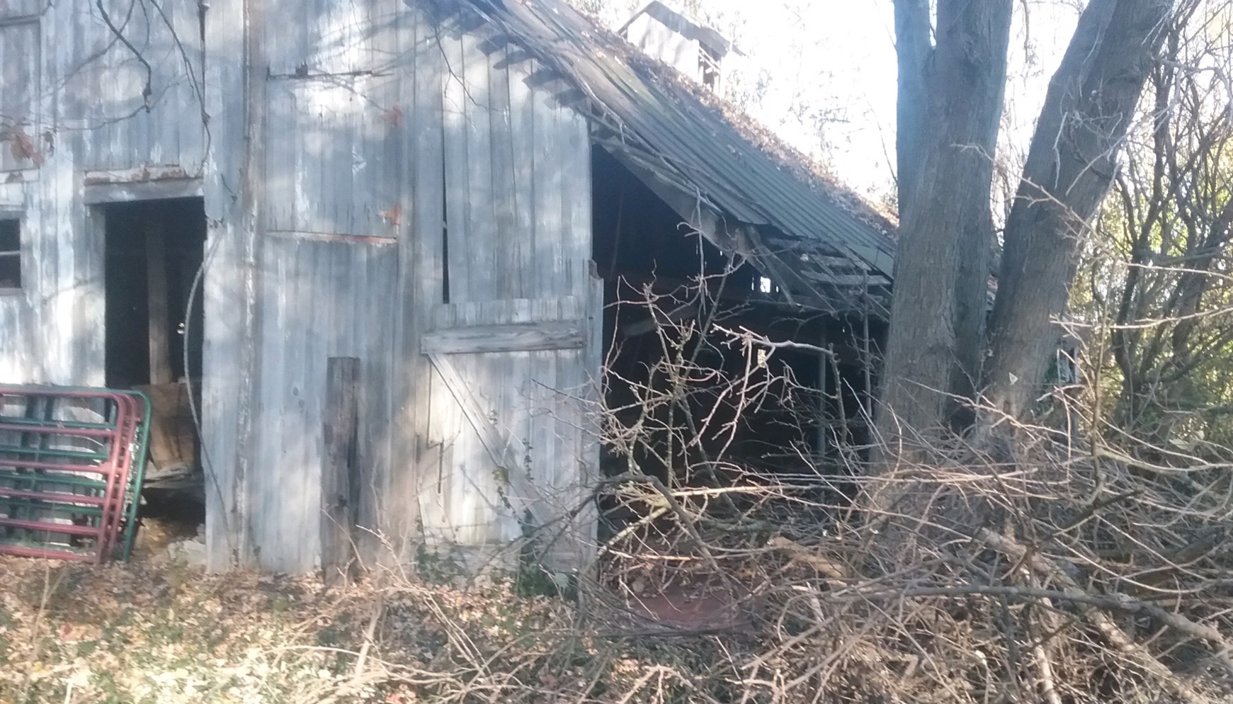

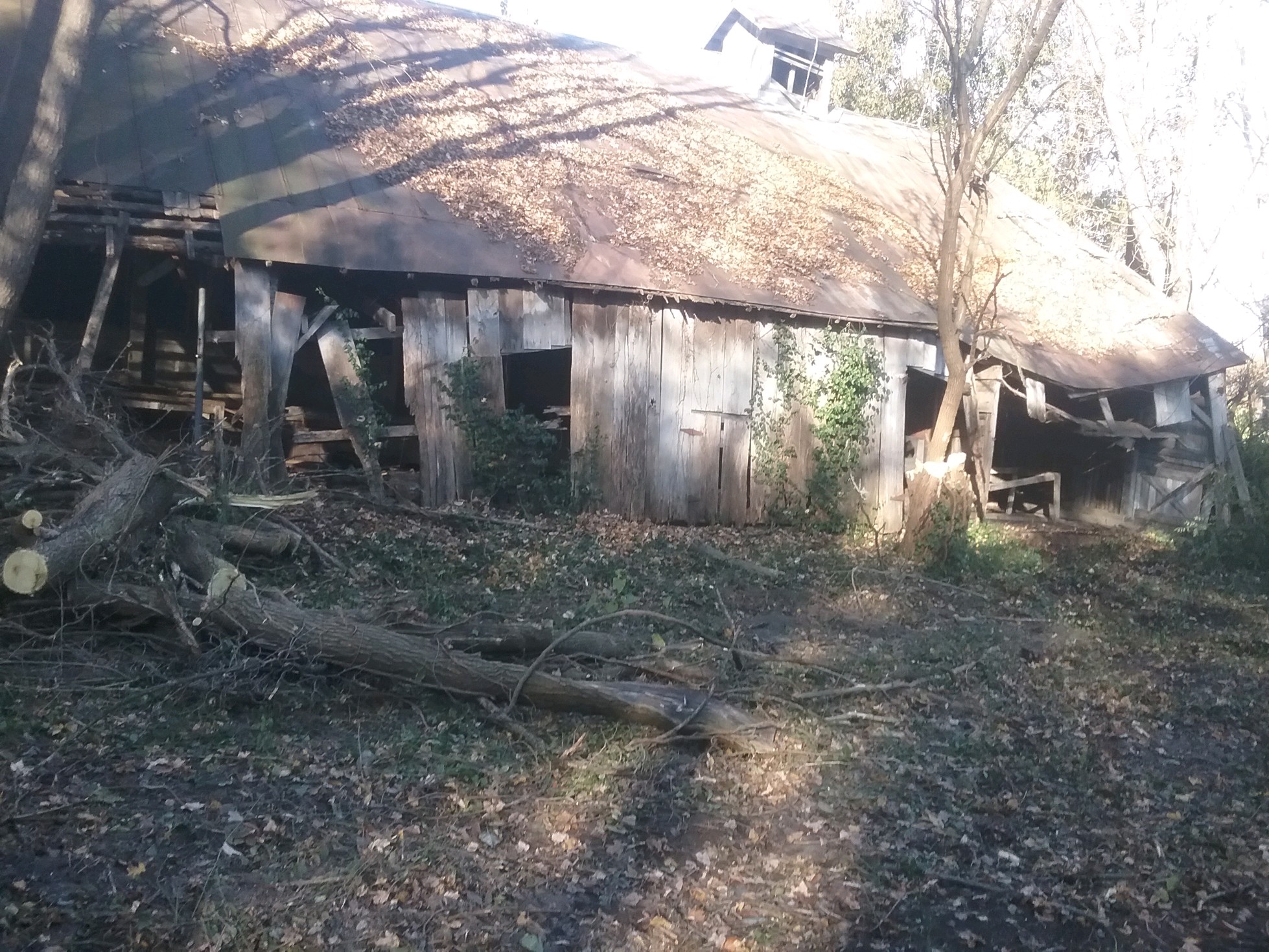

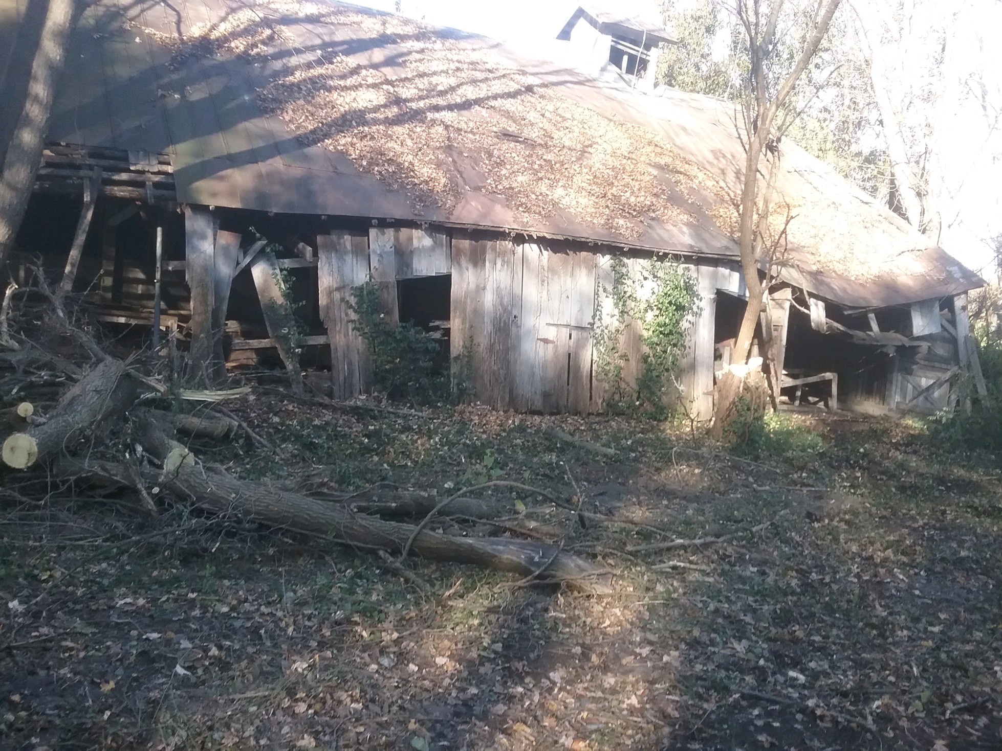

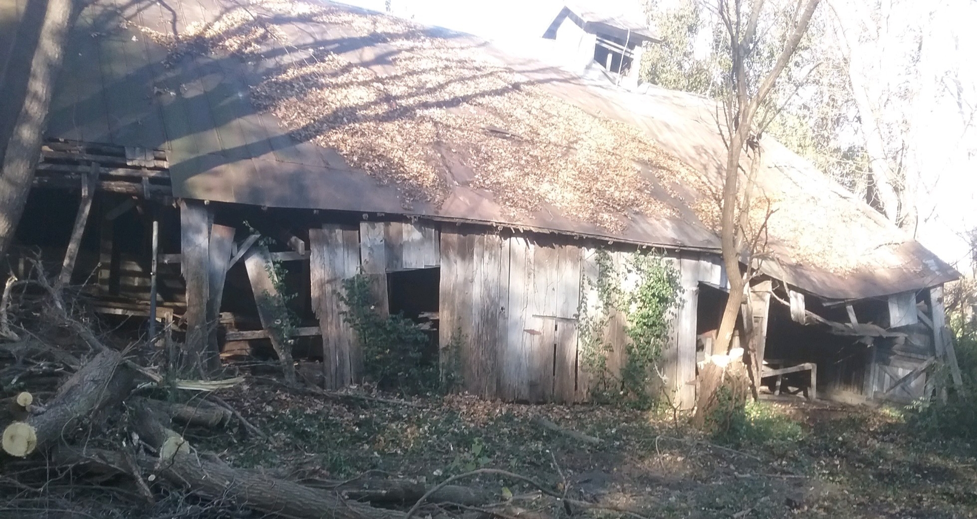

Hello guys. Have the old barn foundation that has shifted years ago. It was a poured stem wall between 1' to 2' deep that has broke and shifted years ago. Dry rot, wet rot, and termites have taken care of part of stud wall.
Whenever I get the backhoe going my plan is to pour a new stem wall along the outside below frost depth with a footing below to reinforce and rebuild the barn wall and level the barn. Or just take the old one out and put in a new one below.
Right now I want to move some hay in where the sliding door is and then temporarily put up some plywood to seal the opening for the winter. Then later put in some hinged doors when the foundation work is done.
Pics are below. Opening is 7'4" wide. First problem is trying to figure out how to lay a treated sill plate about 12' long and seal it against the irregular surface of the shifted foundation. It is high in the middle and the corners have sunk low.
I appreciate any ideas on a temporary door seal and a permanent repair. Thanks.
Put a treated sill plate along level, anchor it with shims under it and tapcon's into the high spots. Then fill with expanding foam underneath, to seal it up. When you get to the point of new concrete work, pull the tapcons, and the sill plate. You may have to hammer and chisel some of the existing concrete to make a good flat run and reduce the big open spaces. steve
Could you use a hammer drill, small jack hammer to take the high spots down? Could you form up and put a cement cap on the old cement leveling it out? I have had to do both on old buildings.
I would cut the entire bottom off of the existing door just at the bottom of the lower girt. This would eliminate a patchy bottom edge. next I would rent a demo concrete saw and use a laser level to make a line across the hump in the existing concrete. Then demo saw in notches down to that line at 1 inch intervals. I would then break out the standing fingers to level the threshold as much as desired. Then build a bottom for the door from 3/4 CDX (or better) and put a glued and screwed overlapping plywood along the joint to hold the new bottom in place. That would be about 5 inches wide to lap both the existing door bottom and the new repair plywood. Jim
I have been doing this sort of work on both my 1867 house and barn. Your situation looks a whole lot easier. I wouldn't worry much about temporary if I were going to go at the permanent next year. I would jack one long wall up by 16 inches or so. From just the two pictures it is impossible to tell exactly where to jack, but you have it easy having ground on both sides of the wall. So put together your support timbers in pairs inside and out with bearing points to place jacks, at least four, then jack it up. You will crib up to bearing points, leaving access to dig out the old foundation, and install new. With one side done you lower the wall onto the new level sill, then go over to the other side and repeat.
Thanks. Got to look at it some more after moving some hay in. I got some more ideas here. Basically I don't think that foundation has moved much in the 40 plus years I've been around there. Maybe it doesn't need to be replaced but pour in some support pillars. I think it can be smoothed down as suggested with the gaps filled in. Once I get a smooth surface with a grinder and a saw then I can get a decent sill plate in. Then I can cut some new studs in to length to get the wall back to level and sister them in under the floor joists for the loft. When they built it they didn't put up a first floor stud wall to put the floor on. Basically balloon framed all the way up the side with the loft floor joists nailed into the side of the studs. I'll probably go back with 2x6" studs to support the loft floor. I guess I want to move that doorway down to the end. Just needs to be wide enough to get a 6' loader bucket in there to move in a 6' round bale for feeding.

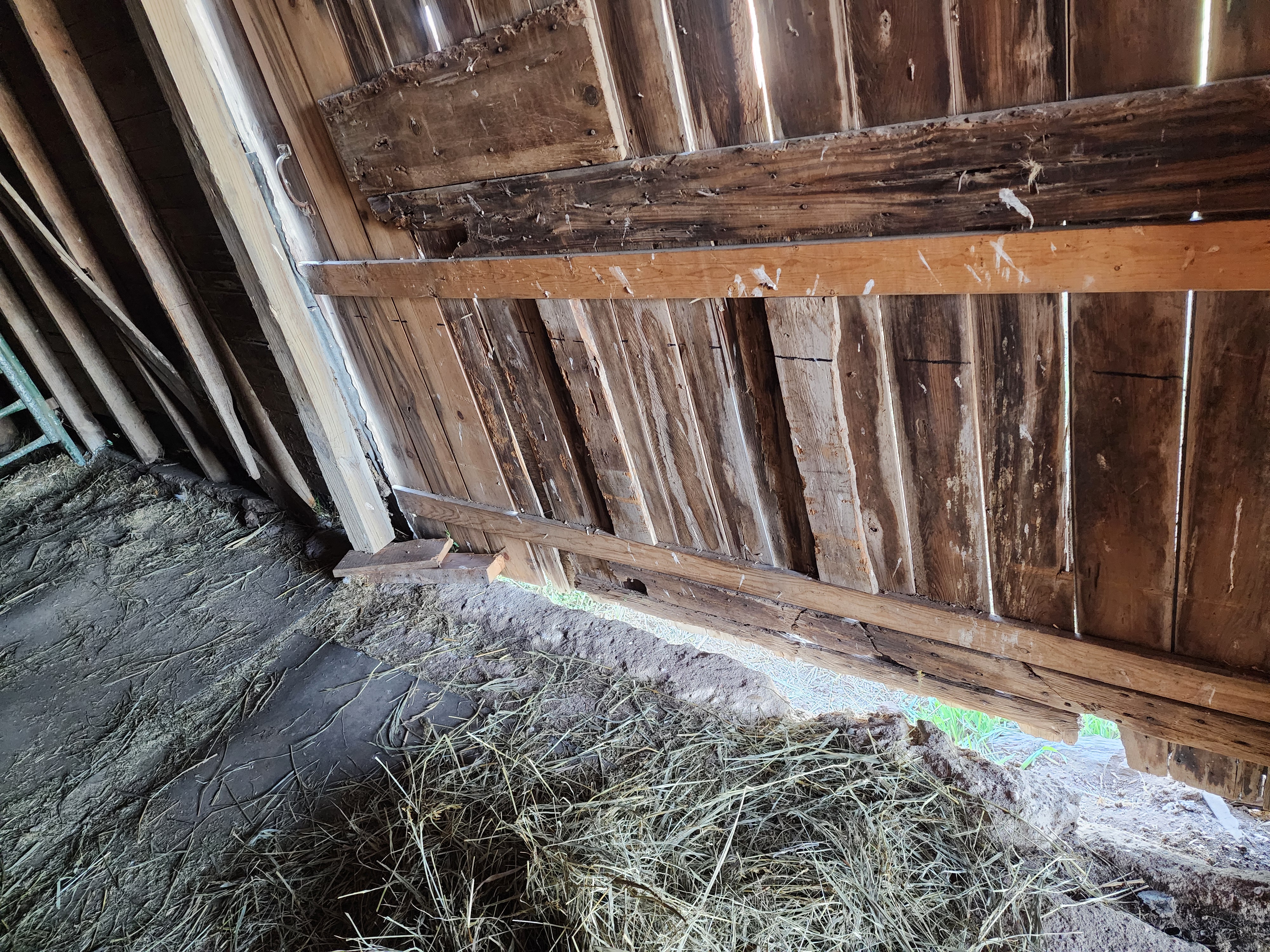

Had a couple nights of above freezing temperatures so I got phase one done which was level 7 feet of foundation on the south side next to the southeast corner where it was low. Formed up on the inside set with a 3 way laser level using 3 bags of low slump quikcrete and a floating board on the outside. 4th bag was mixed wetter with a higher slump to finish off the last inch on the top.
The foundation there and on the east kinda rolled out and dropped down. Had to get the southeast corner up to the same grade as the middle part one the east where the sliding door is as shown in the photos in the previous post. Had to add concrete on the inside because the old foundation and wall rolled outward.
Plan for this weekend when we have a night above freezing is to do the same for two thirds of the east wall. Where the gap in the foundation is also a low spot so it will get a 4" drain pipe and some rebar reinforcement.
The 3 way laser with plumb Bob works well for getting a straight line foundation and brings the wall back into a straight line and plumb up and down.
Once I get a new sill plate in, then I can jack up the wall to the right height and cut new studs to fit.
I'd use some 6x6 or 8x8 for the verticals. they will be less wiggly than 2x nailed together for a vertical. Also will hold the top timber better. 25x tends to bow when weight is added to the top ends. Timbers don't the reason for the 6 or 8 x .
It looks like the lower part of your mix may be tto dry for it to hold up well. When placing 'crete over old like that you want to wet the old down well just prior to placing your new, so that it doesn't pull moisture out of the new

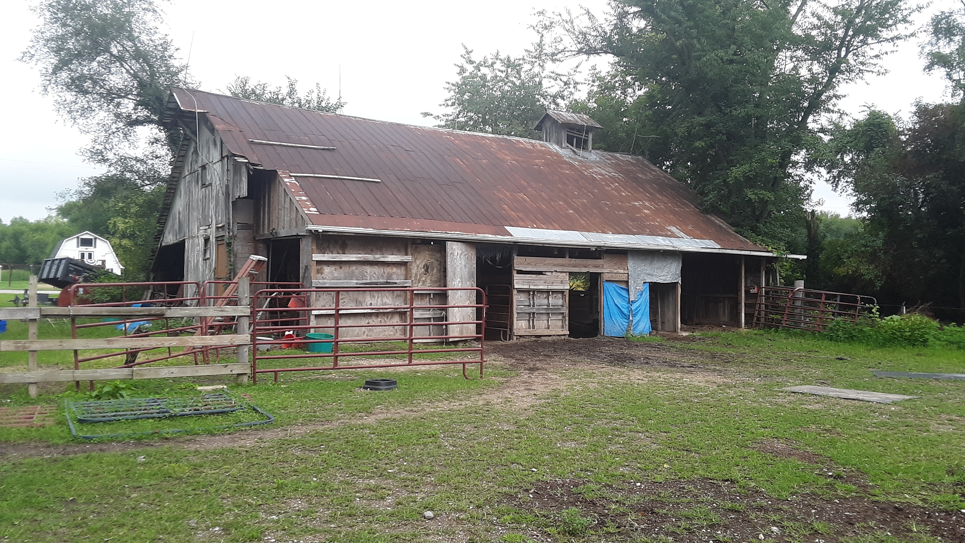

About 10 years ago my friend bought this barn built in 1911. The east side of this barn was falling down.The foundation was crap and the wood was eaten by power post Beatles. We jacked up the 70 ft long east side. Braced it. We did away with the failing foundation. Dug holes for new 4x4 support posts. I brought a load of sand and gravel in my dump trailer. I put my cement mixer in the trailer. We
Filled the holes with concrete. The 4x4 were hanging with 6 inches of clearance for the concrete to get under the posts. We saved the barn from setting any more.I would use a backhoe and remove your foundation Your problem may be water related. No rain gutters on your barn. The wet ground gave away and now you end up with a failing foundation and decaying wood.
