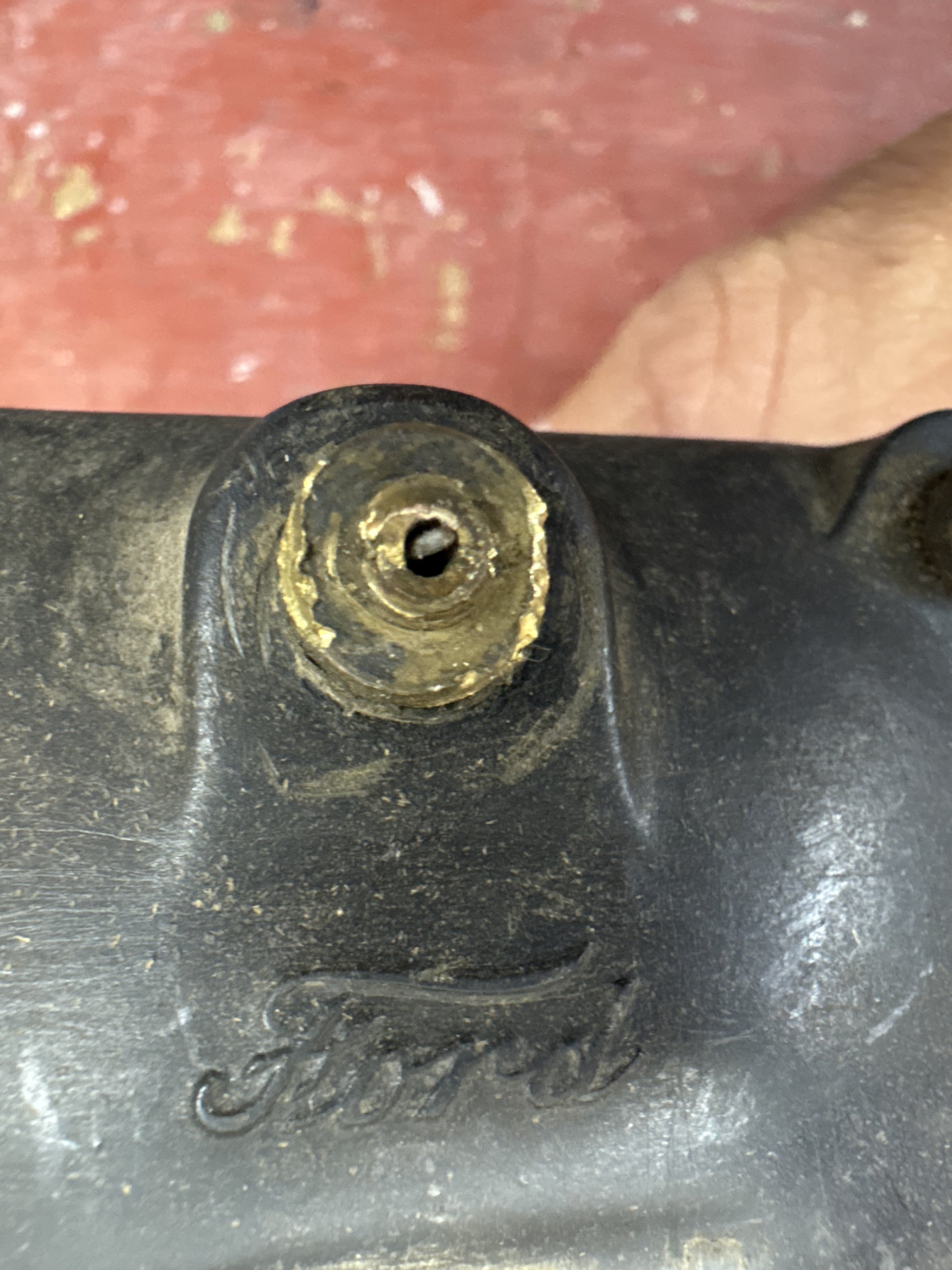

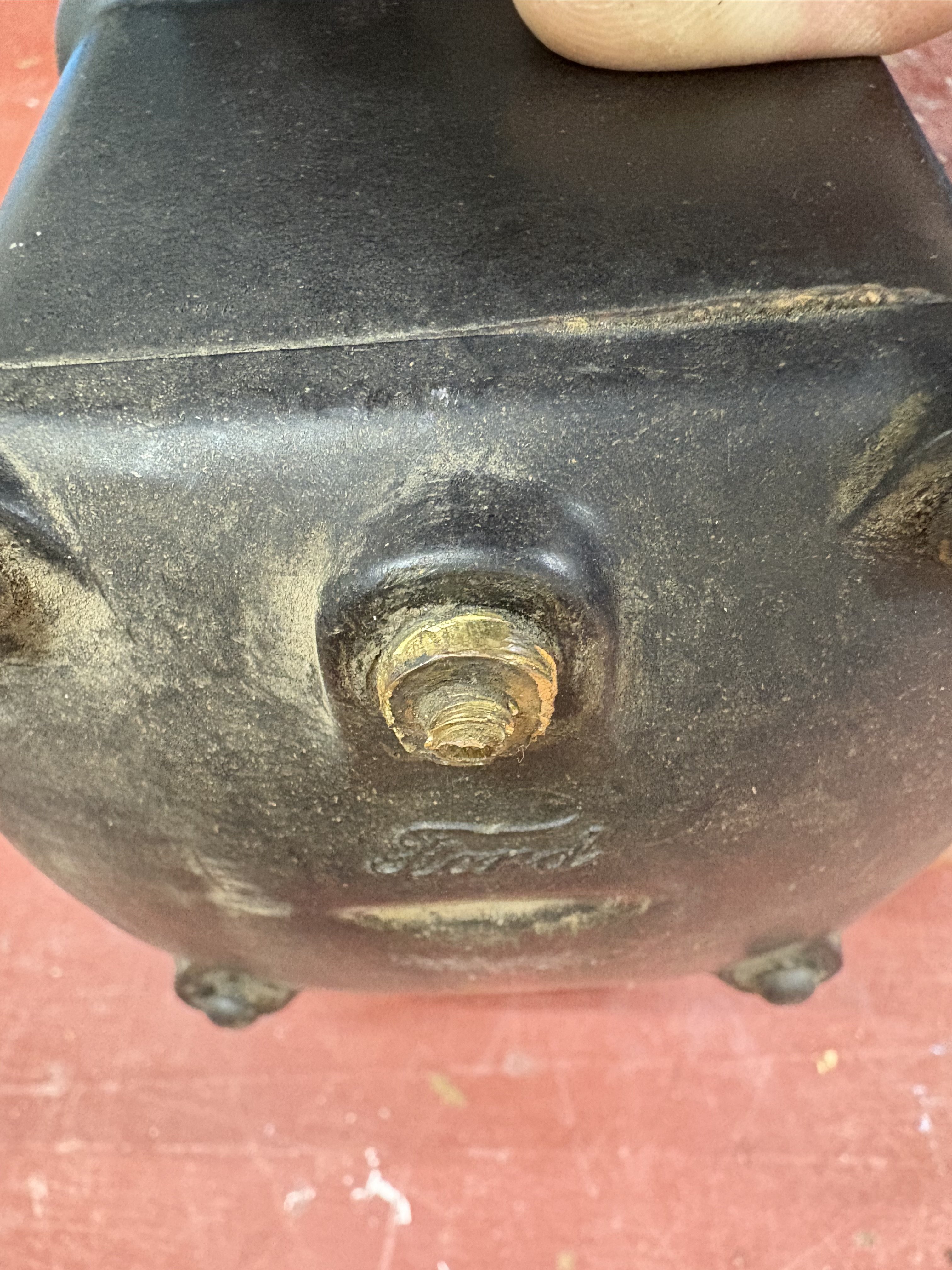

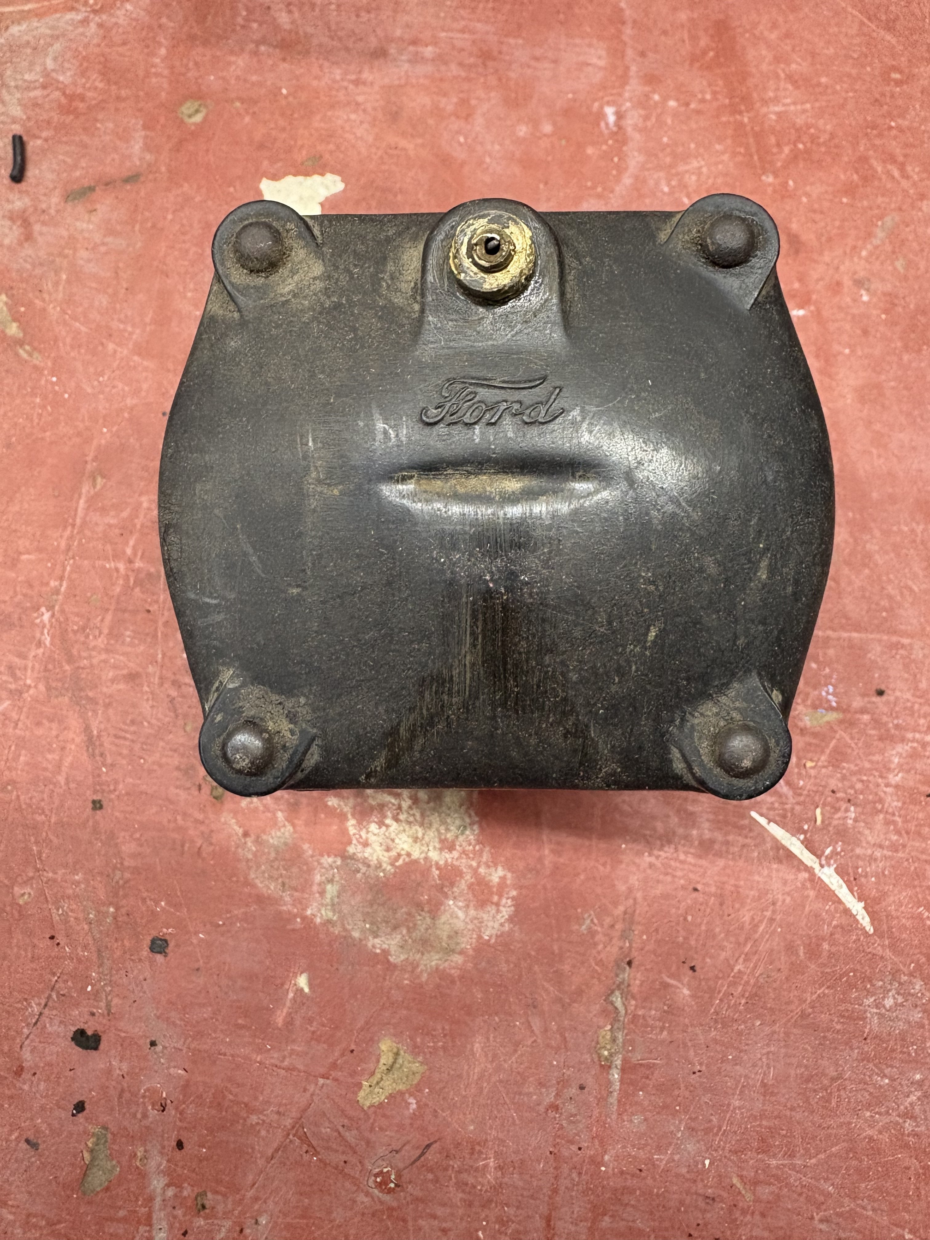

I have this front mount coil, which I assume is an original 6 volt coil. It’s actually marked “Ford” which is cool. It measures in at 1.5 ohms if I recall correctly, so it seems to be good. Only problem is the brass stud on the top is broken and there’s not enough thread to reuse it.
Is there a decent way to fix it up to use it? I was thinking of drilling out the stud but then I saw what looks like a wire lead sticking out so I don’t think I want to risk drilling it. If nothing else I could probably gut it and use it for a side mount coil conversion but I’d rather not take a perfectly good coil apart if I can repair it.

Work the 4 pins pins out are pry around the top of the cap till you can grab the pins they are twist in pins twist to the left to get out. I quit gutting them as it does not resolve the other issues of a square coil. This is the only photo I could find it looks like I used a putty knife to work the top off. I must have already cut the wire off. This is a newer coil epoxy filled.

It might be possible to solder the ignition power wire to the post assuming continuity was measured to the post and not the wire sticking up. You should have some previous soldering skills. Clean the connection to bright brass color. Use 63/37 or 60/40 ROSIN core solder. Use a moderately high wattage soldering iron or gun (no torch) that can heat a small area quickly and try to do it as quickly as possible to avoid damaging the plastic. No guarantee of success as the plastic might crack or melt.
What olddavid said. Go to hardware store and get a male spade connector that has a stud hole on the other end. Won't be original but will save the coil.
Why didn’t I think of soldering…great idea, thanks!
