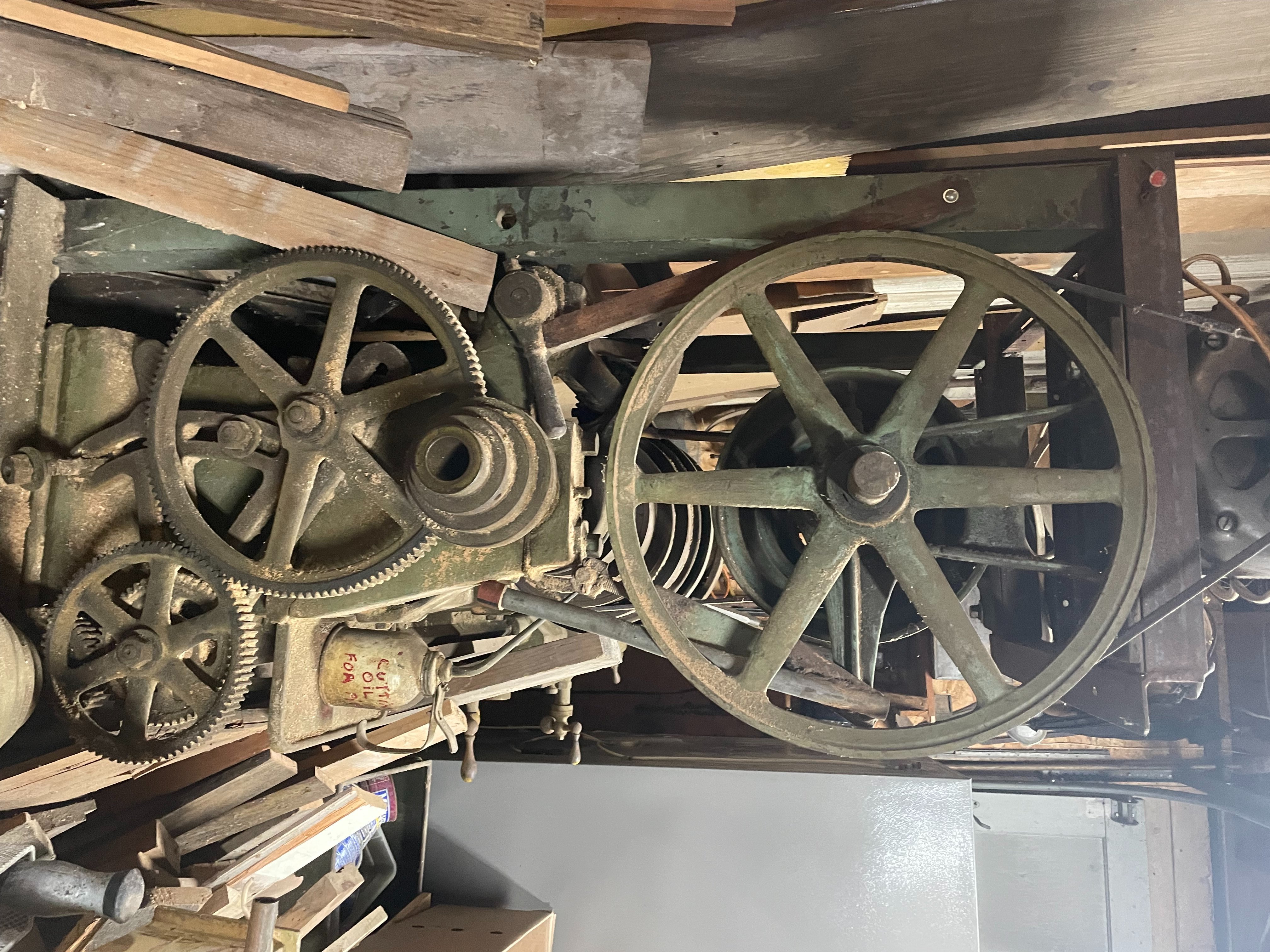

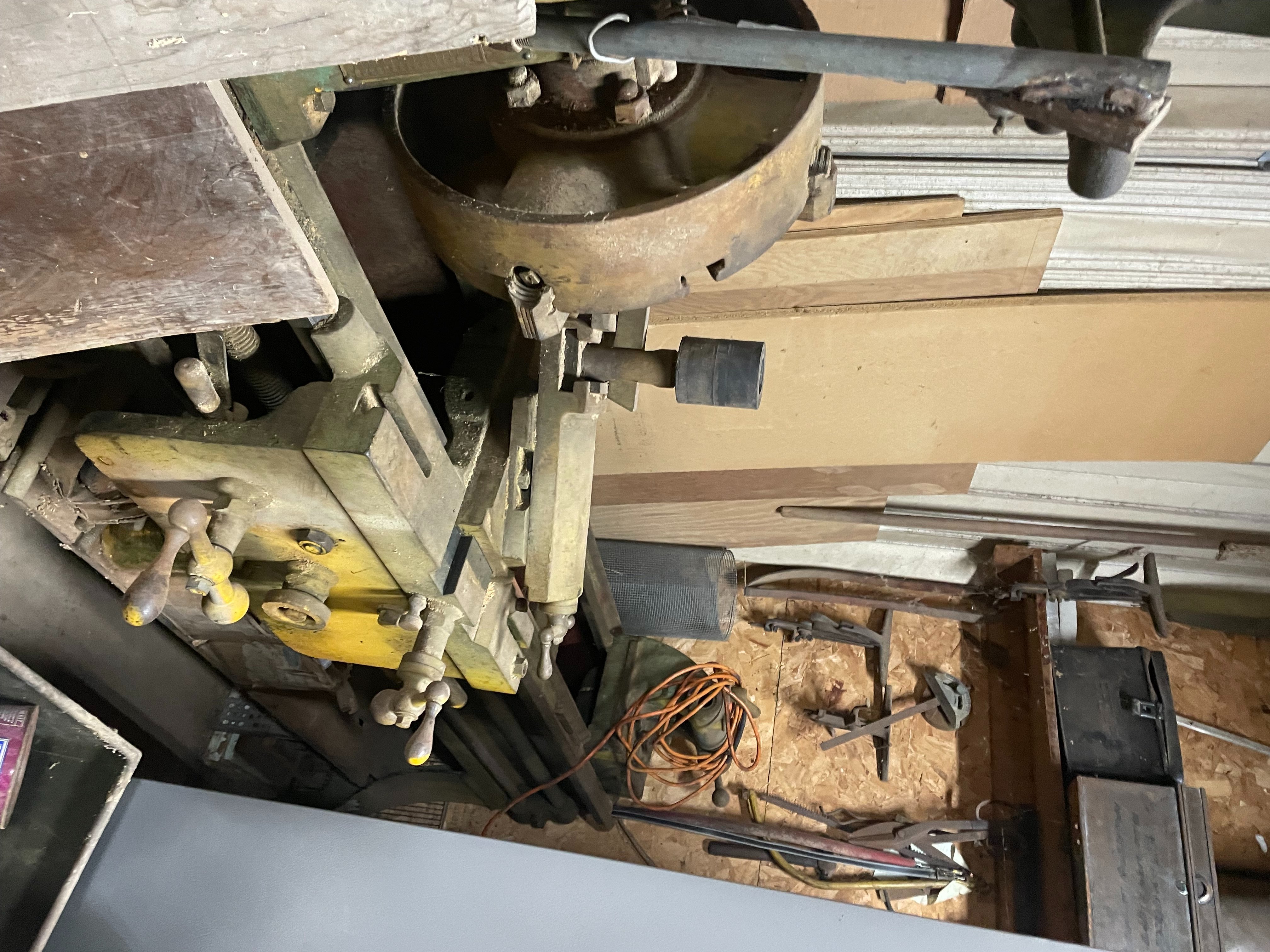

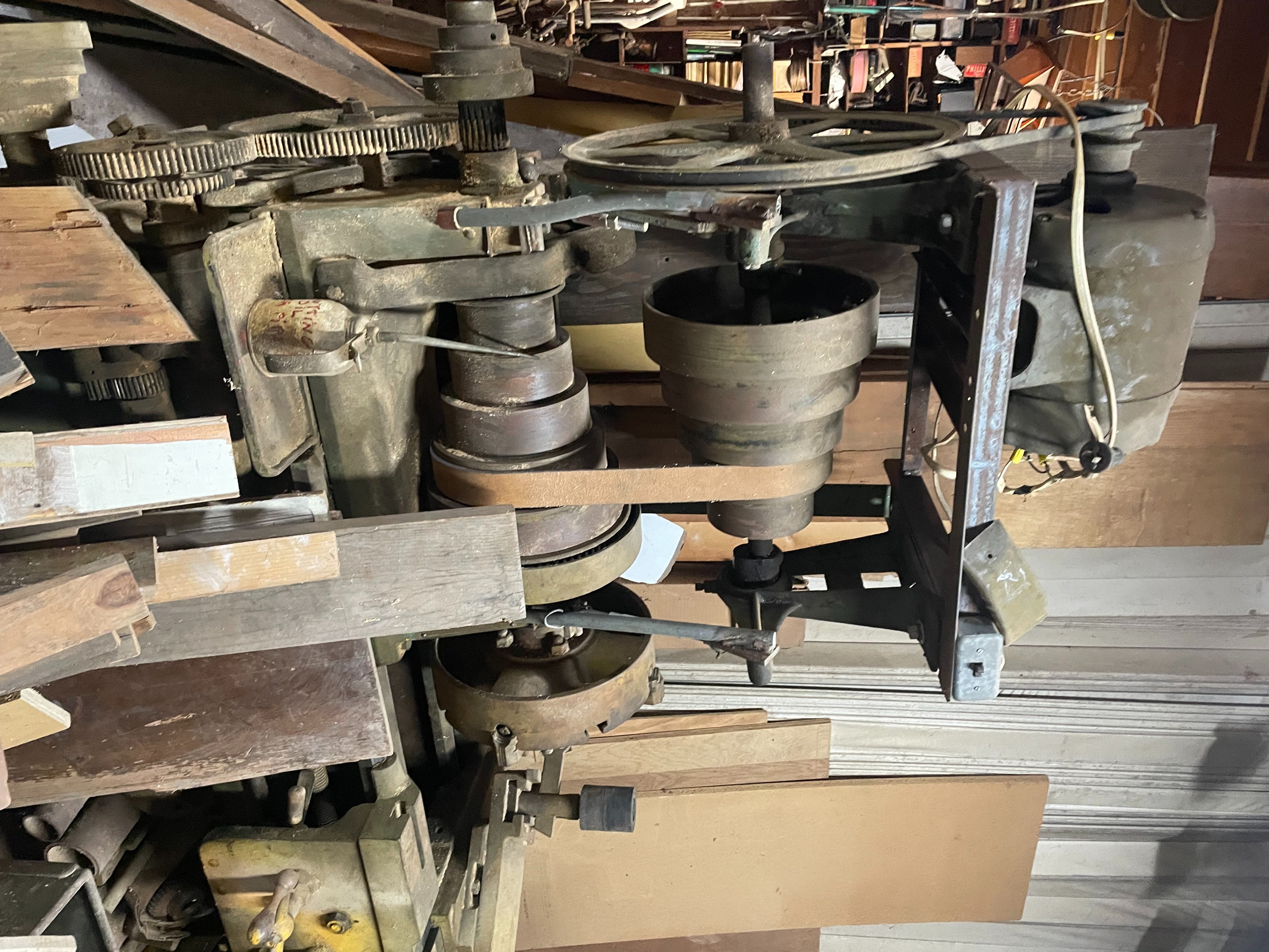

We have had an old Metal Lathe in our shop for as long as I can remember. My Grandfather picked it up from somewhere and it's been stored in the corner collecting dust ever since. Now after 40 some years we have decided it no longer belongs on the farm. I have some pictures attached, it's in great shape and literally just moved it outdoors under cover this morning. It is a "The Rahn-Carpenter Co." Cincinnati O. U.S.A. We have a bunch of tools, bits, chucks, and accessories that have sat with it. It's been retro fitted with a Delco Dayton Ohio electric motor. We are looking to sell it, but we really don't have an idea of what it is worth, or where to post it. I figured here was a good spot, at least to get a conversation going. So please hit me up, i'd love to have a discussion on this relic of the past.

That's a solid-looking lathe. But unfortunately they don't seem to bring much around here. And yours doesn't have a self-centering chuck (unless there's one on the shelf I'm not seeing), nor steady rest, nor thread dial, and it has the lantern-style toolpost. Although that lathe would work just dandy as-is, most folks buying any lathe will want to have those changed out. And most folks buying old lathes shy away from heads on babbitt and flat belts (even though they'd do just fine for them).
I bought a 1950's McGourlay lathe sitting at a local yacht club not that long ago. About the same size, a little newer (double V-belt drive), but it also had the original lantern toolpost and only a four-jaw chuck. But it did have a dandy steady rest and a lot of good tooling to go with it. I got it for $200. I think that was a good, but not a 'sensational' deal. It probably would only have fetched $500 at the very most if the seller really held out for a higher price. And I've seen others at auctions go for scrap price (or less).
It's unfortunate, because that lathe would probably work dandy for many decades to come. But most folks wanting a home small-scale shop lathe will pickup on of the many Craftex/Busy-Bee style ones that are everywhere and have with forward/reverse/multi-speed, self-centering chucks, and modern toolposts. Loads of new and used ones are available cheap, and (rather unfortunately) those cheap lathes do just dandy for most folks at their home/farm shops.
I'd suggest listing it for $500, but being very flexible on price. Make sure you clean up, show and describe the ways as being in good condition (assuming they are), as that's a key thing folks are going to look at. A good place to post for sale and find out other thoughts on value (and history) would be vintagemachinery.org. Lots of info about the Rahn company on there. And folks on that site are obsessed with this kind of thing.
Not worth a great deal. Depends largely on the condition of the ways and the chuck(s). Doesn't appear to have provision for change gears for threading.
If the motor runs, the ways have no major dings or pitting, the chuck(s) are usable after disassembly/cleaning/lubrication, the saddle and crossfeed work and the compound is tight, perhaps $300-$500 to someone looking to get into metal lathe work cheaply.

Those old belt-driven lathes weren't much good for cutting accurate threads due to inherent belt-slippage. That appears to be made in the early 1900's. Unless he finds a collector it isn't worth much today.
They don't use the belt for threading... that's why it has a brass tag with a threading chart to select the appropriate change-gears for the desired thread pitch.
