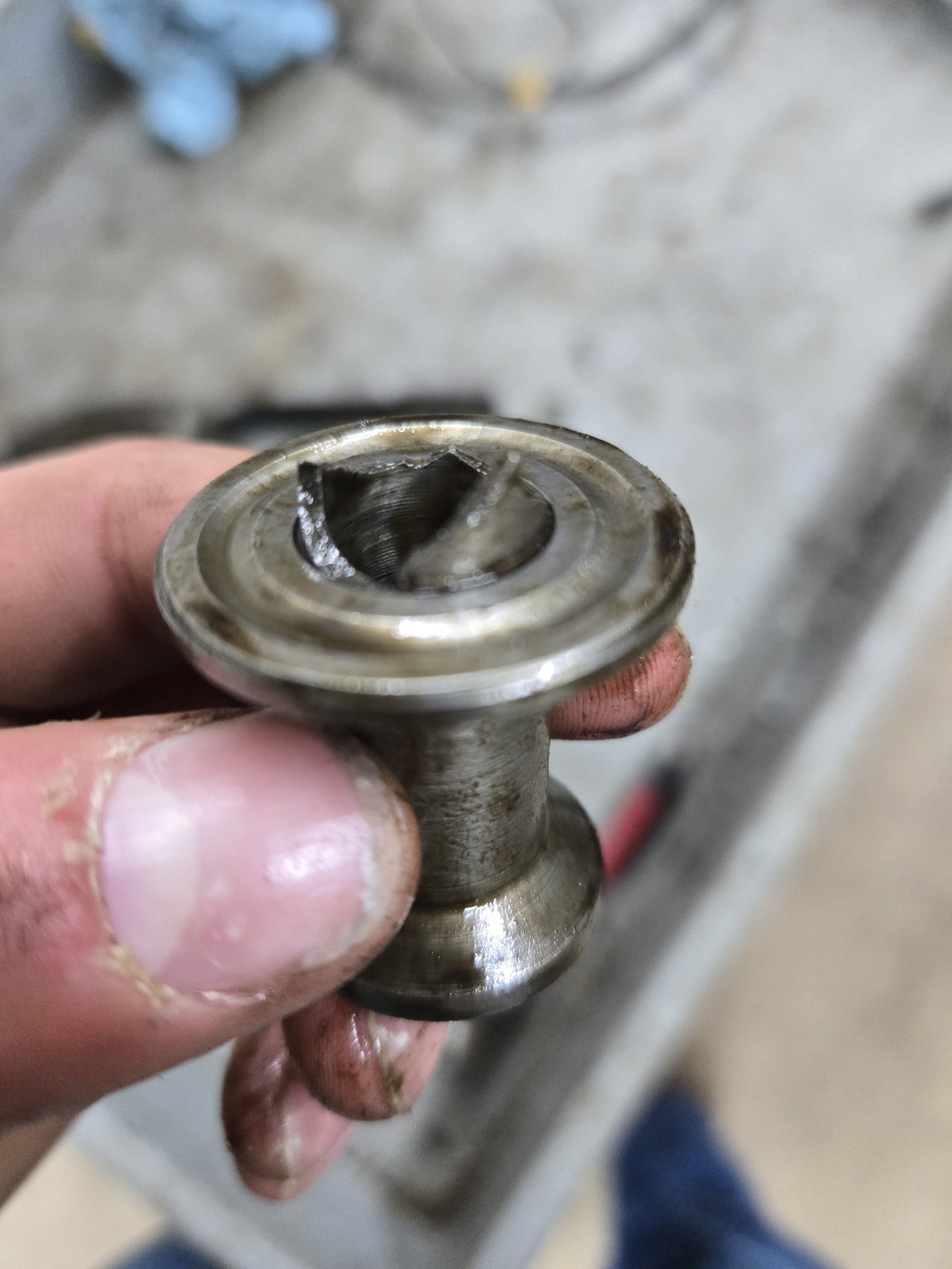

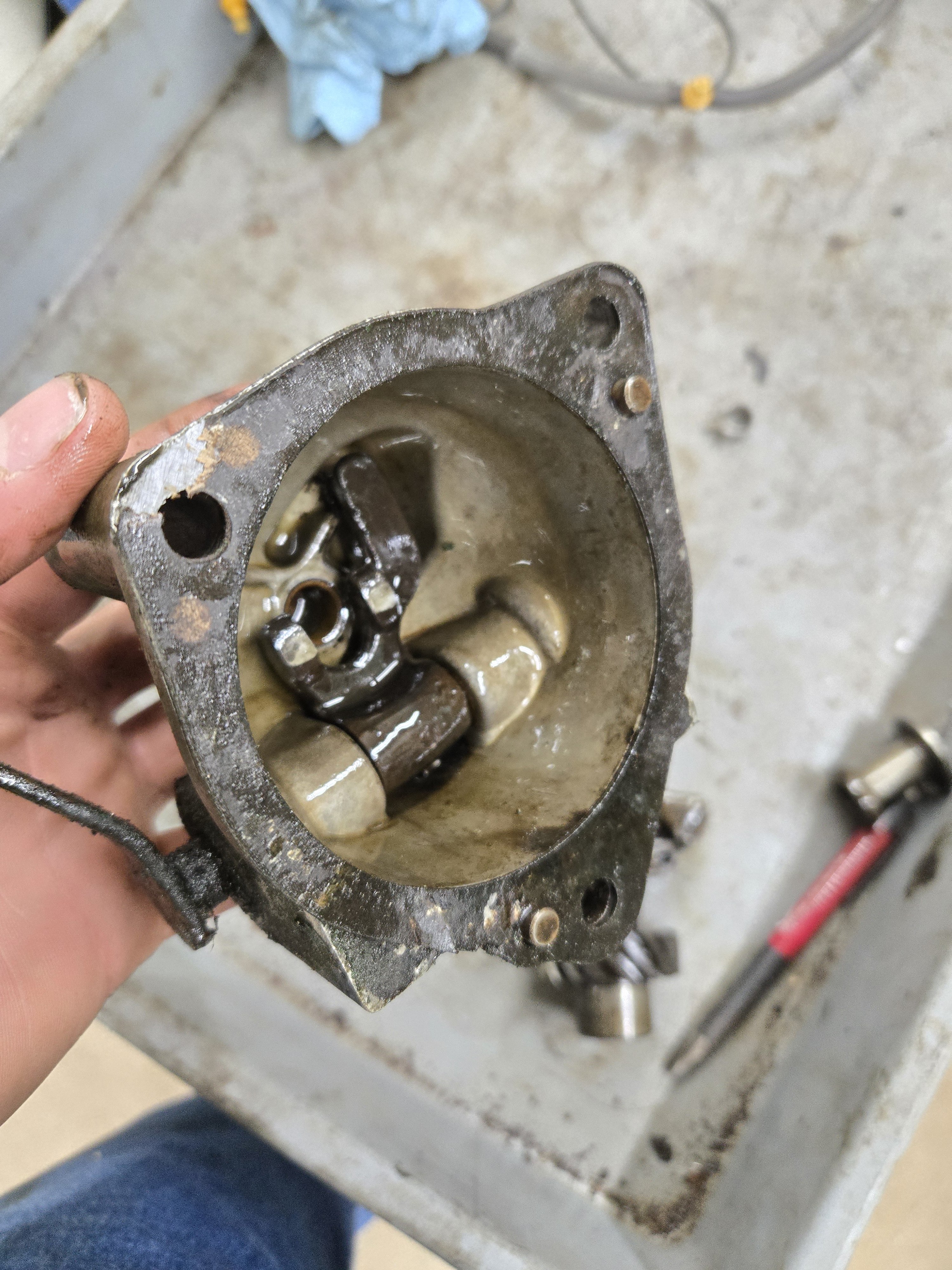

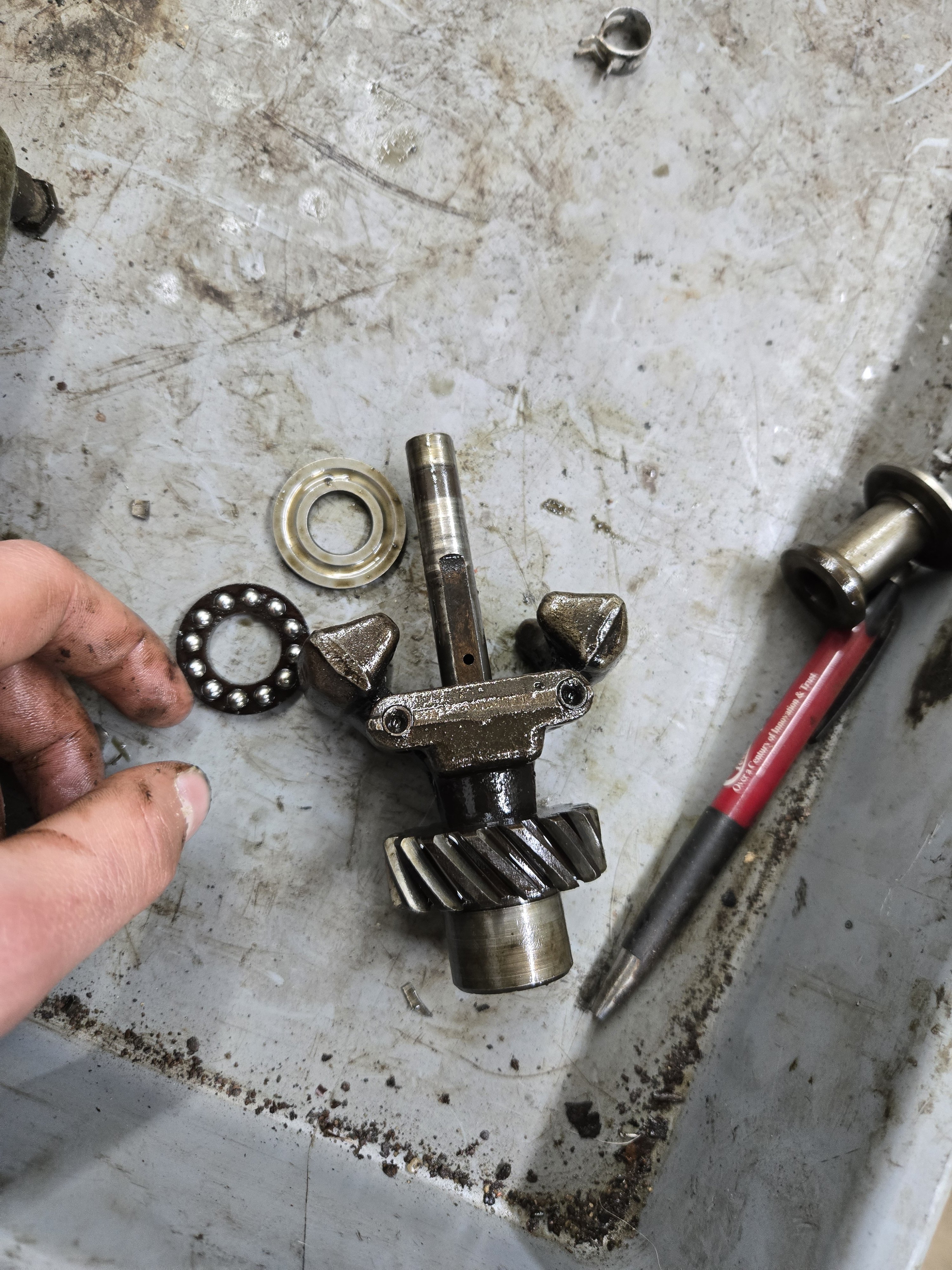

2. While at a stand still and even while driving the throttle is all whack, on the first three notches on the throttle lever it's at idle, but if I move any farther than that is revs way up, it almost like an on off switch, all or nothing. I'm new to these Oliver's and I have no clue how the governors work on these, maybe it has something to do with the governor?
The sputtering when you take off thing might just be that you need to choke it a little until it warms up good. It's not automatic. There could be a few things with the governor. You might have to take off the air cleaner to get in there and find the problem. Is the linkage binding between the carb and governor anywhere? There are two things inside the governor that can cause the problem you're having. There's a brass washer that goes on the back of the drive gear, between the gear and the engine block. I've seen those worn out and gone and the gear worn right away in to a big groove on the back. Be careful if you pull it out, to be sure the washer doesn't stick to the block and fall down inside. The other thing is the bearing in the front of it. I went through this on my 1600 a few months ago. You can search for the post. They use the same governor set up. None of us have had any success finding the actual bearing anymore, but my son and I got creative and made a bushing on the lathe and used what we could find to make one work. Details are in that post.

I figured out my governor problem, there was a broken piece, now i just gave to find where i can get this piece at.
