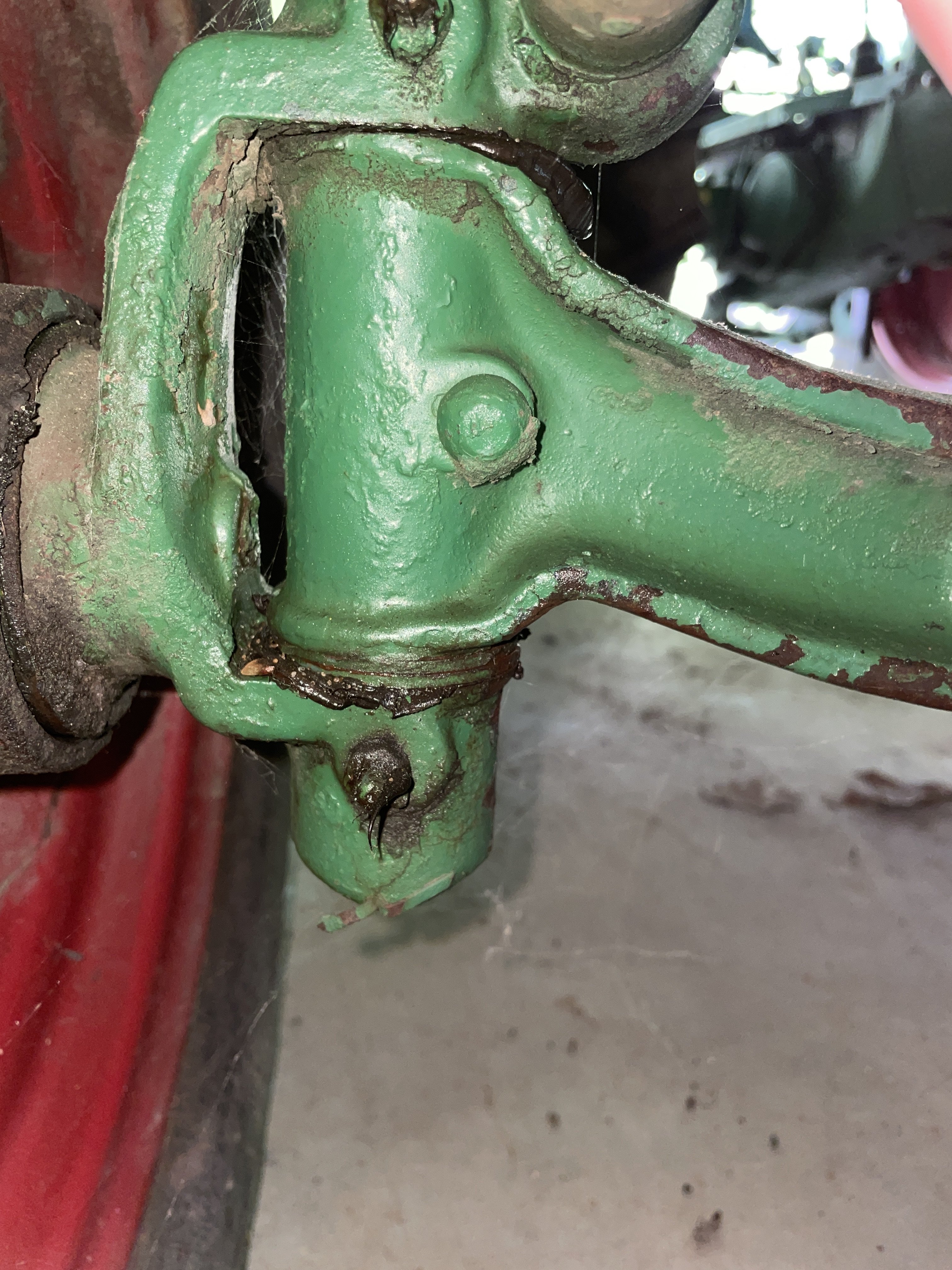

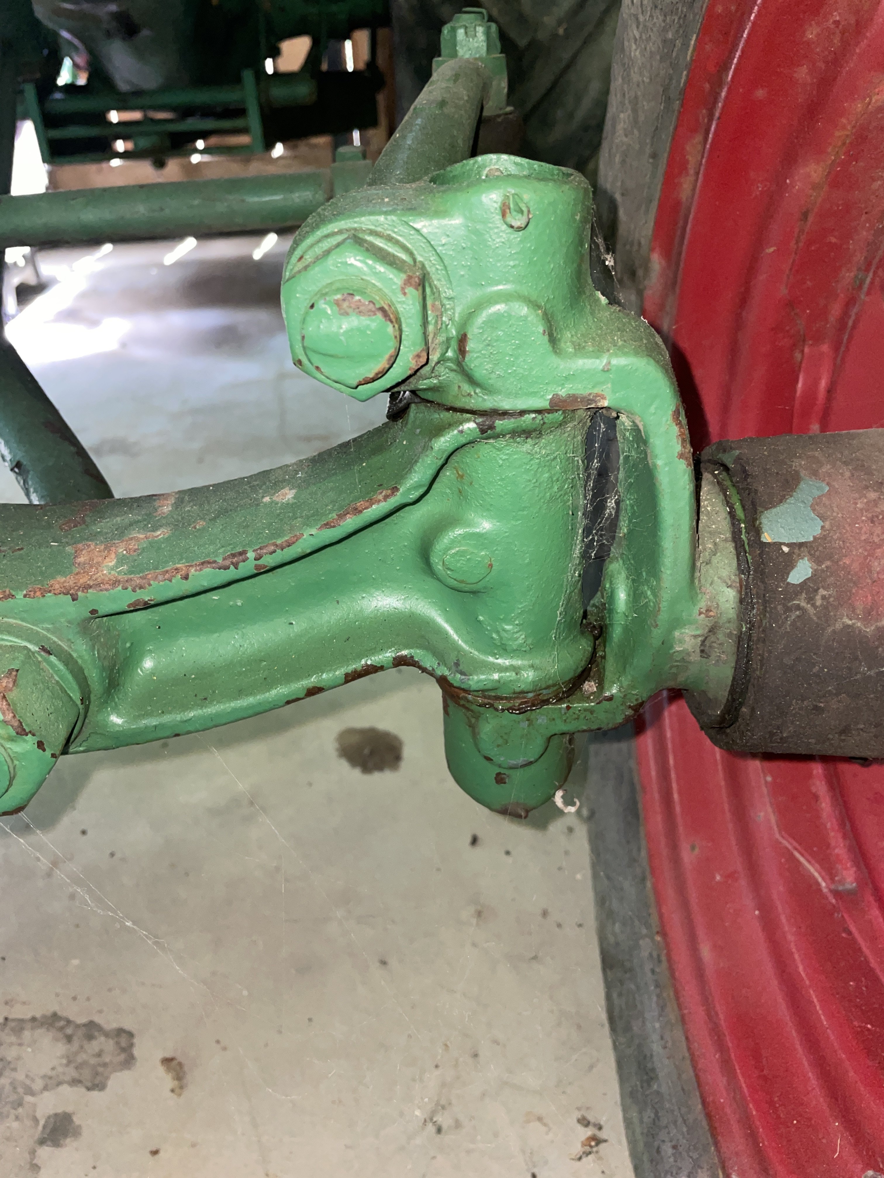

Working on replacing the spindle bushings on my 77. Several internet searches have not yielded any information!
I was able to get the welch plugs out, but to remove the spindle pins, there is a rivet driven into a blind hold that engages a relief cut in the pin. How in the He** do you get that rivet out? Anyone have experience with this - I see pics of restored Standards, so what's the trick?

Hmm on my 66 orchard the pins go through and are peened over. One side it looks flush and it’s hard to see.
