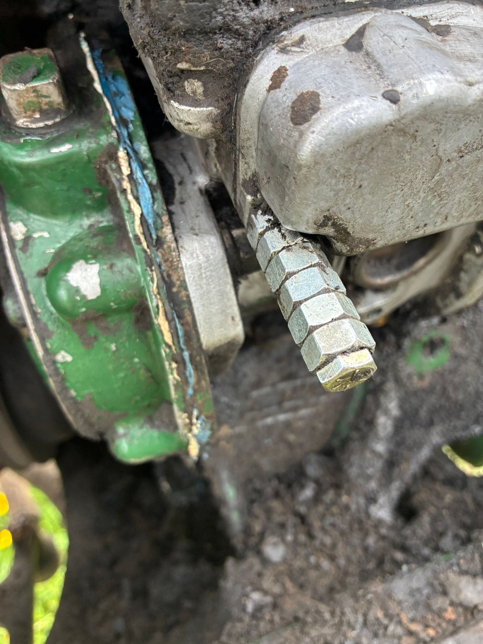

I recently purchased my first tractor, which is an Oliver 88 Diesel. It does not run, and I think that it has issues with the injection pump because no fuel comes out after the pump. One thing that I noticed that is odd on the pump is a bolt loaded with a bunch of nuts (SEE IMAGE). Any ideas why this would be or next steps for trouble shooting?

I hope you did your homework on those Bosch PSB pumps prior to purchasing it. I don't know what that array of nuts is, but if that tractor didn't run for a long time and someone tried to start it, chances are good the plunger was stuck and it's now broken and the pump is a paperweight. If complete heads are available they're generally $800+ dollars. The plungers are machined to the head. If you didn't know about this beforehand, don't feel too bad, many people don't and end up in your (hopefully not) shoes. But maybe you got lucky. You could try disassembling the pump yourself or take it to someone you trust.

Looks like someone put a bolt in there that is way too long and used nuts as spacers? These pumps are not too hard to take apart. There are other older threads on here about timing and removal. Could you give a little more detail about what you mean by no fuel coming out after the pump?

You are probably right, maybe they lost the bolt and that's all that they had on hand.
I can crack the line going into the pump and see fuel coming out, but nothing after the pump head. Fuel doesn't leave the pump.
