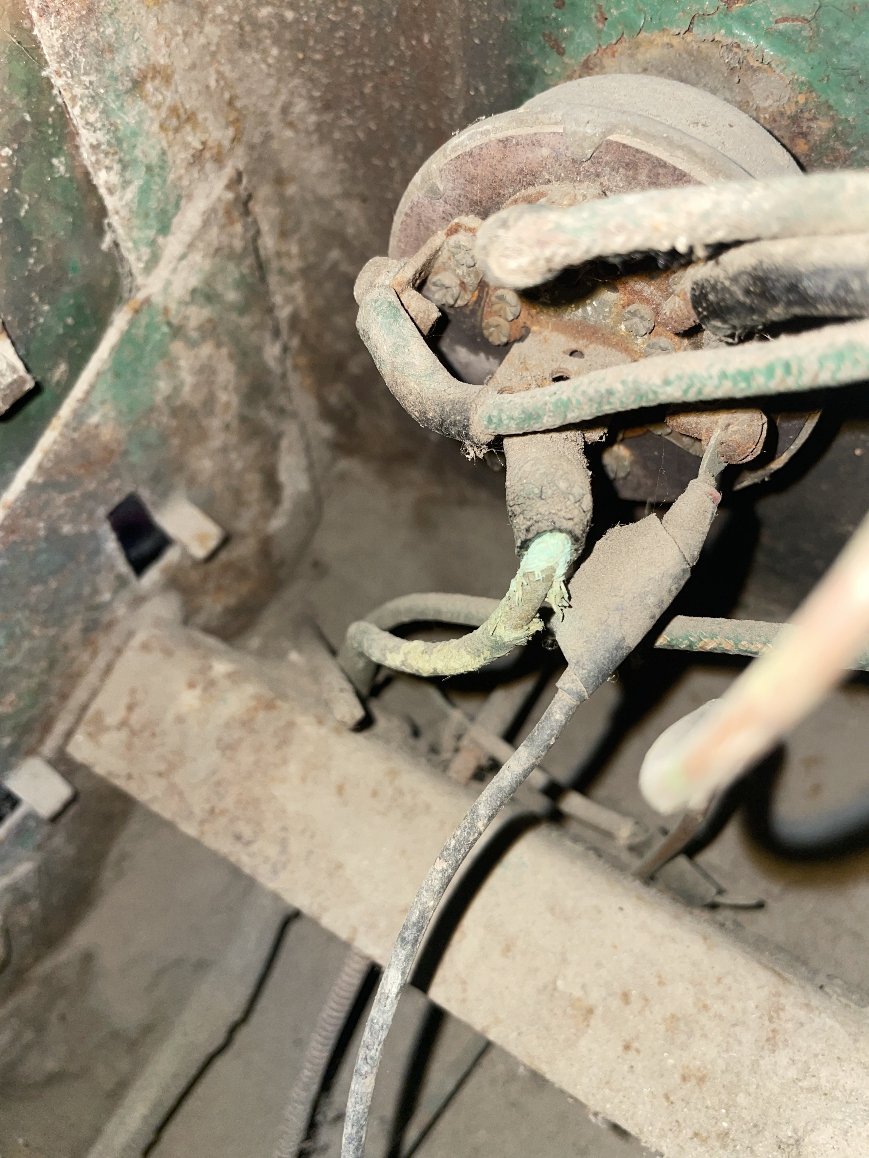

My Oliver 88’s distributor doesn’t get spark and the coil is working. My guess is the ignition wiring. Would this be the issue and how do I fix it? See picture attached. Thanks!
Could be, but my 66 did that recently and it was a bad connection where the wire from the switch hooks to the amp gauge. I loosened the nut on the gauge, wiggled the wire, tightened it back up and had power to the coil.

I used a multimeter to test the coil (ohm mode). I don’t have a service manual laying around so I don’t know the exact range of ohms that it is supposed to be at.
I will have to take off the common and ignition wire and clean them up. The rest of the wires don’t really matter as all of the lights have been removed.
yes. 0v is what I got. So it has to be either some corroded connections or faulty wiring.
Ok with this information; try a jumper wire from the non-ground (you have not said if this is positive or negative ground) battery terminal to the ignition side terminal on the coil and see if it starts, or you at least get spark.
Your coil may have checked out ok by ohms, but without power it cannot work.
Do you have full voltage supplying the switch? If you try the jumper wire before doing the other things it will confirm the problem is likely between the switch and coil.
That is exactly what I plan to do. It is negative ground with a 12v conversion. Used a freshly charged battery when testing.

Tell us if you see a small spark when you touch the jumper wire to the coil terminal. You can unhook the wire to the distributor from the coil while diagnosing if the coil is getting power, if you do that it eliminates closed points for the initial check.
Ok. Thanks for all the help! I will clean things up and test them now that I know what is going on. How do I test the common wire that feeds into the switch? That one is in worse shape than the other wires.
Use your test light or voltmeter to see that there is power at the battery terminal of the ignition switch. If there is not, I expect that wire comes from the starter solenoid battery terminal. I don't have a wiring diagram so can't see for certain that is the source, but it is the common source.
From the looks of your switch picture, you certainly have potential for corrosion and high resistance connection issues, to the point of the wires not conduction power enough to operate the system.
Would cleaning the wires with emery cloth or something similar help remove the corrosion? I understand the corrosion may be not just on the outside of the wire.
