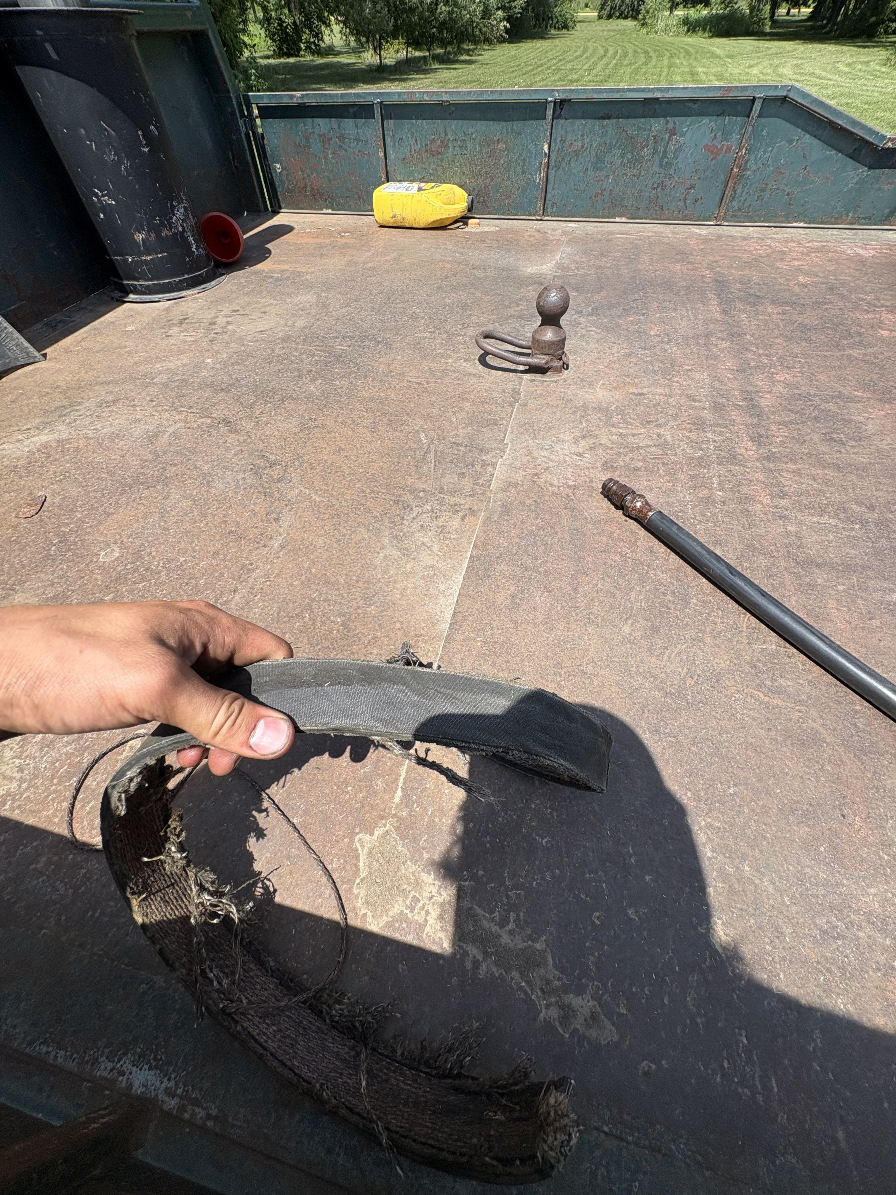

Hey guys I haven’t posted in a while but I tried combining my oats today and it works flawless once I got it sit right but unfortunately I went to make my third pass POP and then the cylinder drive belt exploded into 6 pieces. So my question today is does anyone have a Oliver 18 combine that would pop the cylinder drive belt off and be able to measure it for me or if anybody know what number that belt is I’d be able to get a new one. Thanks everyone hope you enjoy the pics

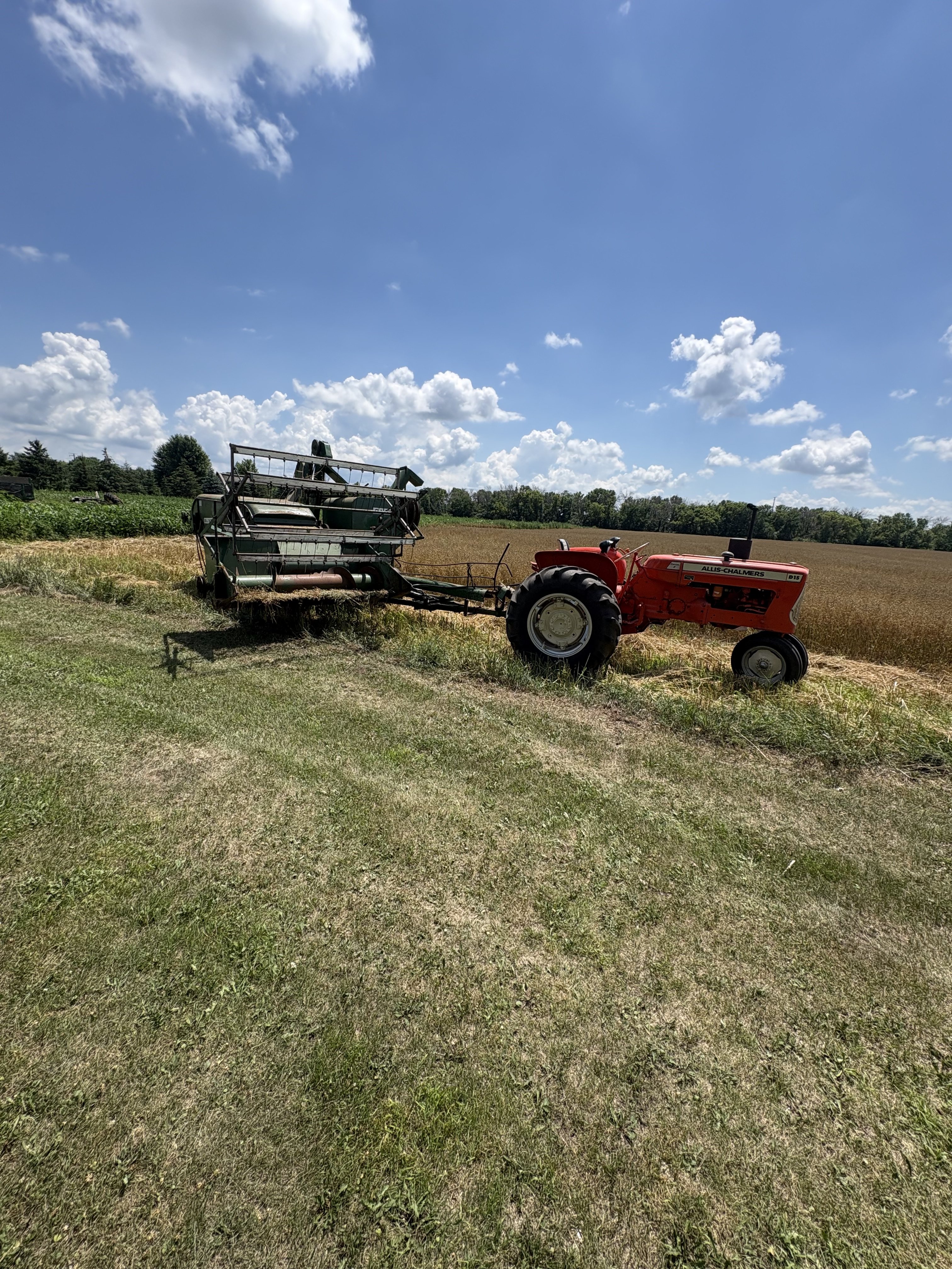

That’s a good looking D-15 Series II.

Sorry I didnt see your post sooner. If I were you I would post questions about your 18 on the Oliver Forum in the future. Here is the belts page out of parts book. I ordered one a few years ago thru Gates.
