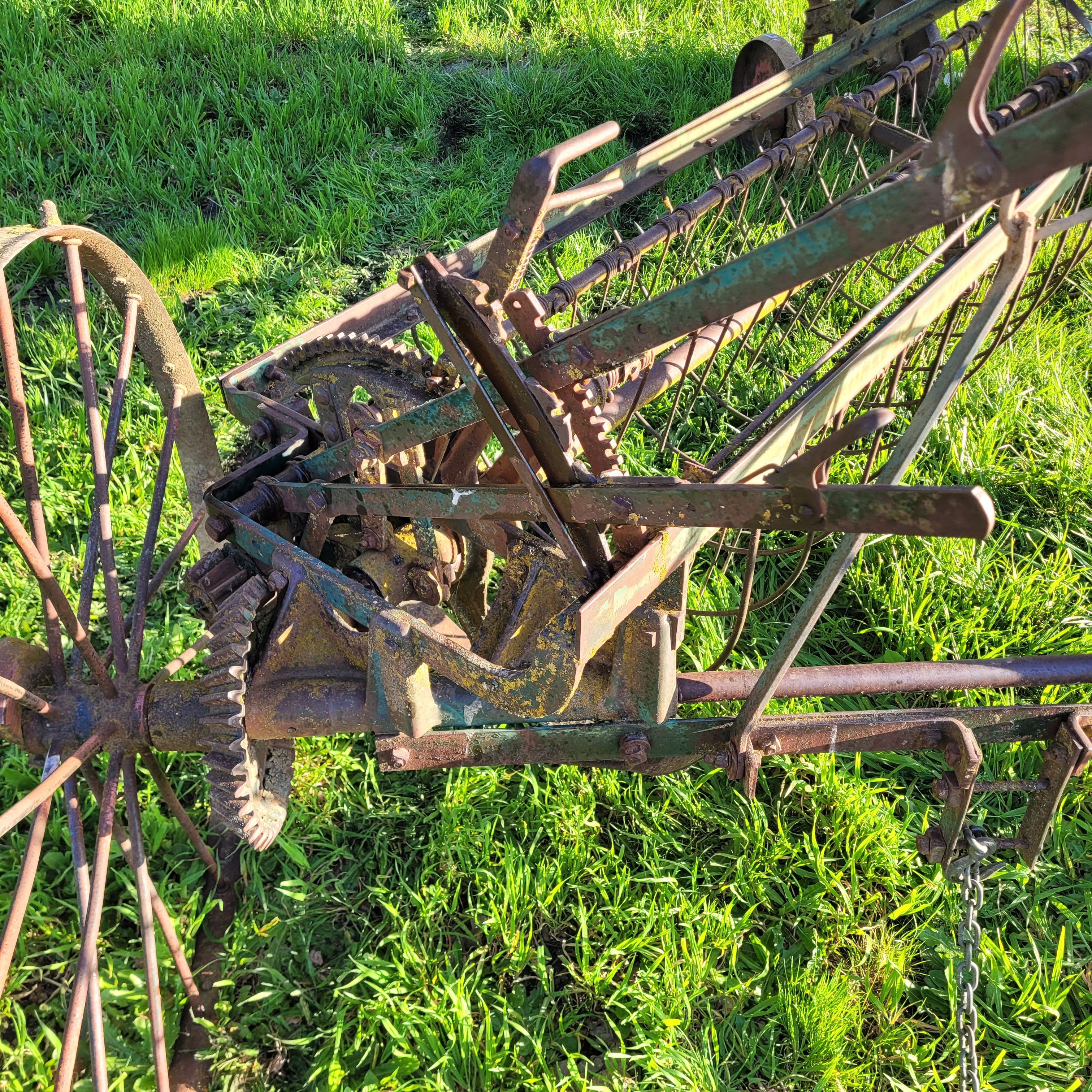

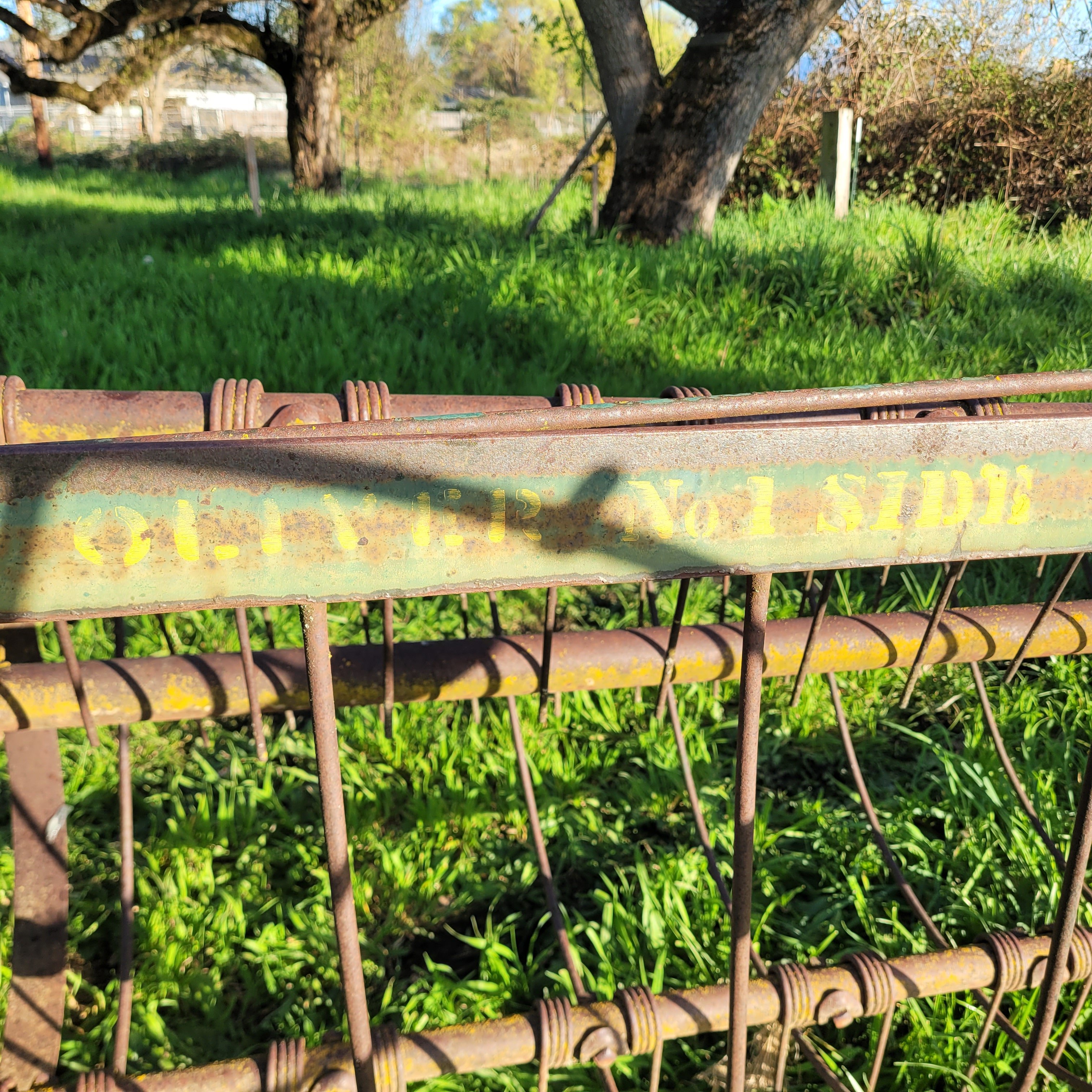

Never seen one before. That is a really cool find! Going to fix it up?Well here yall go. Not sure if it's actually another brand or an Oliver. It says Oliver No.1 in I believe 3 places.
that is a nice looking one!Oliver had a No. 2 hay rake, which is a low wheel design as Leroy stated.
After that it would have been a 107 , 207, etc. They would have been a little bigger than the one pictured.

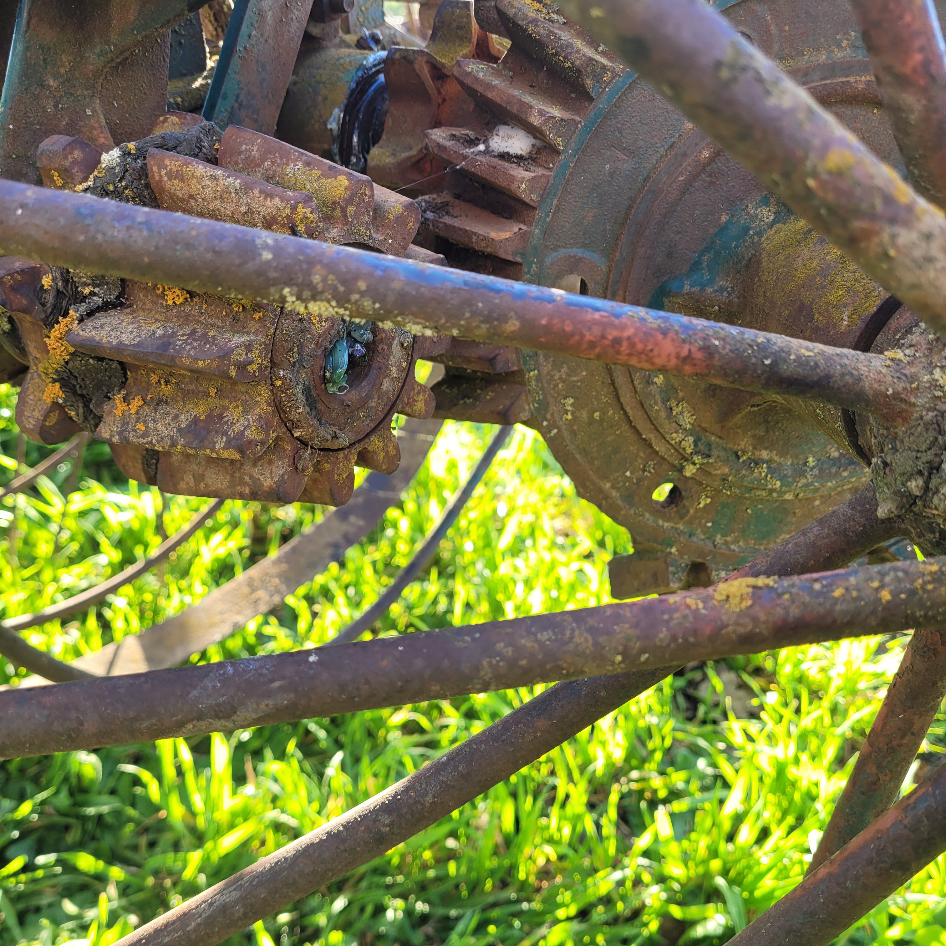

Also I need some steel detachable chain for it. I don't have the original chain. What do I measure to determine chain size?
Yeah, I did seem some online but I guess they have different sizes?I think I have a book/pamphlet on the #2 rake. If you are talking about that square link chain its still available at many farm or industrial supply places.
A guess from here would be either a No. 52, No 55 or No 62 link. You'll have to measure center to center between the teeth & the width of the sprocket at the base of the tooth. Add maybe a 1/4" or more to either side. Check on the Farm Chains site, under "Steel Detachable Chain" & look through the measurements under the different sizes.Yeah, I did seem some online but I guess they have different sizes?
