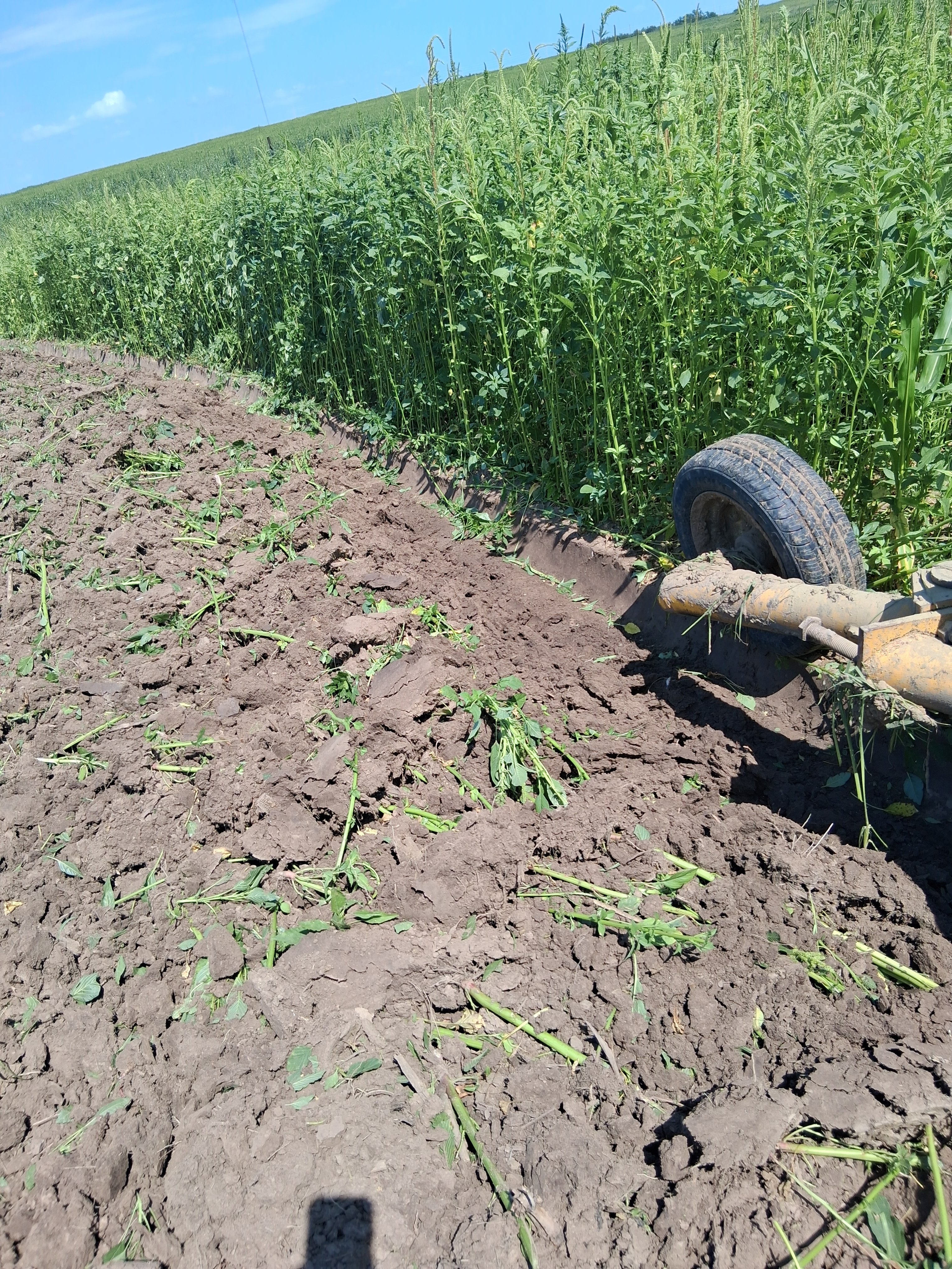

I've done 500 acres with the schaffer worked great
