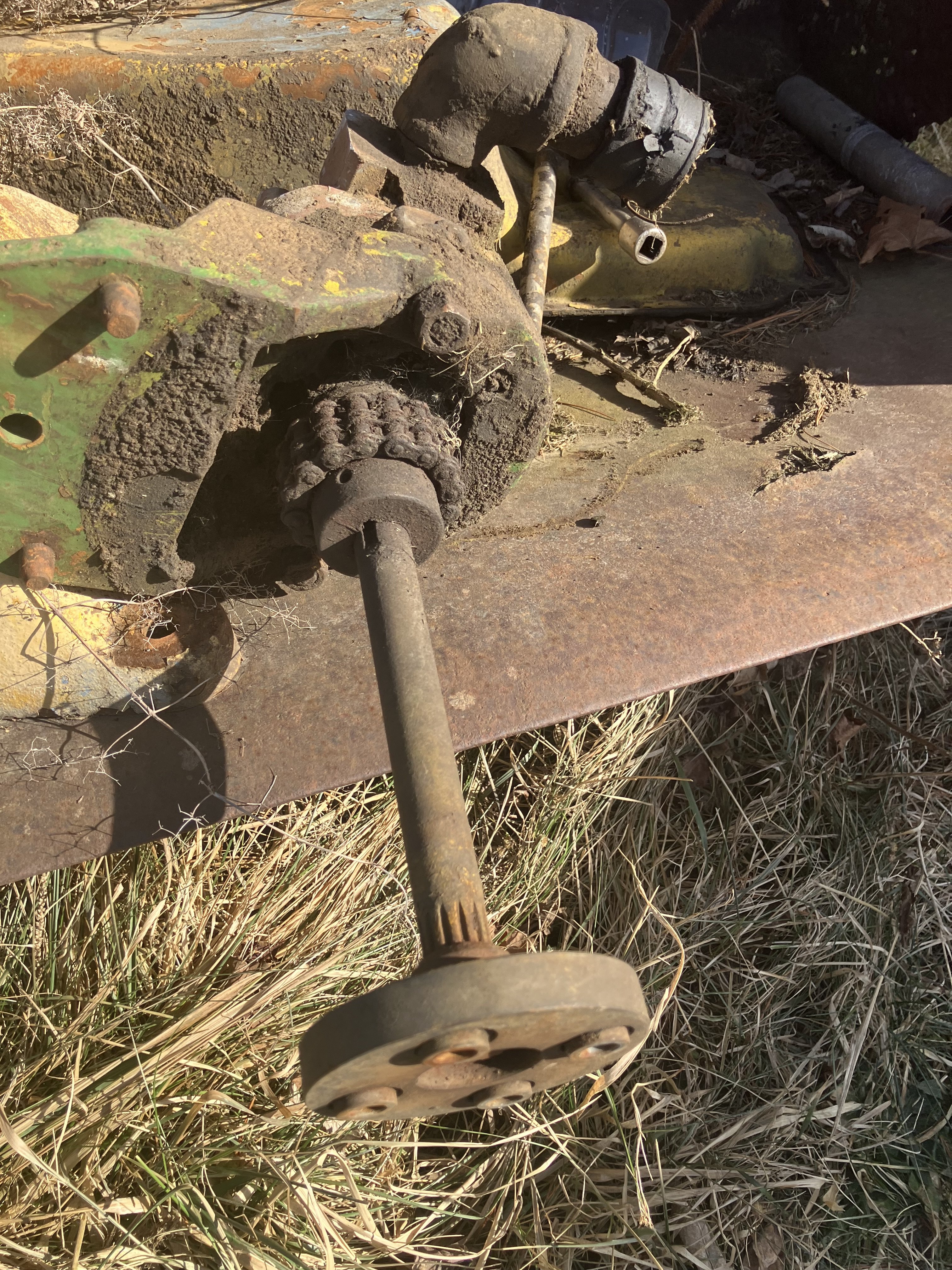

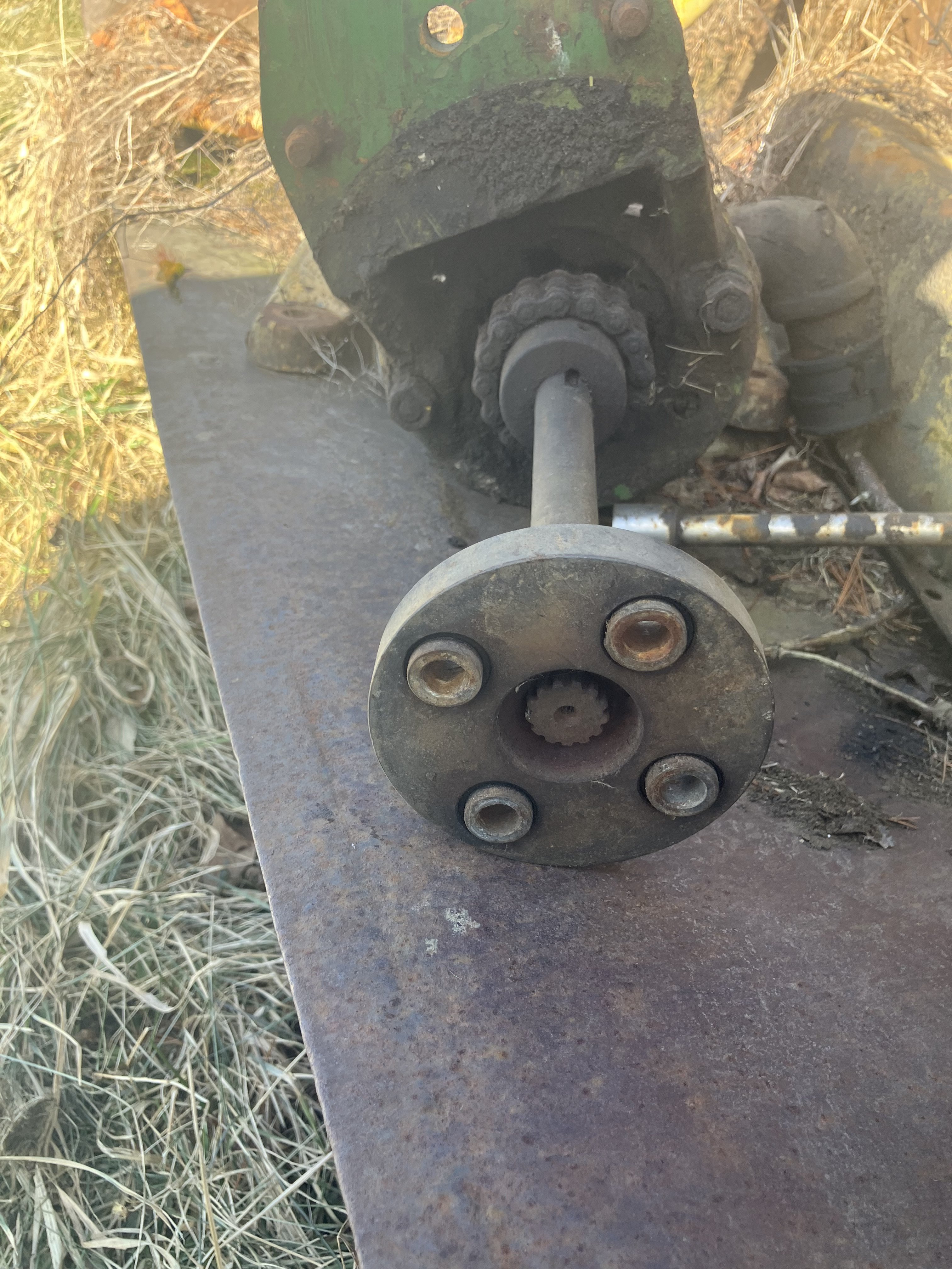

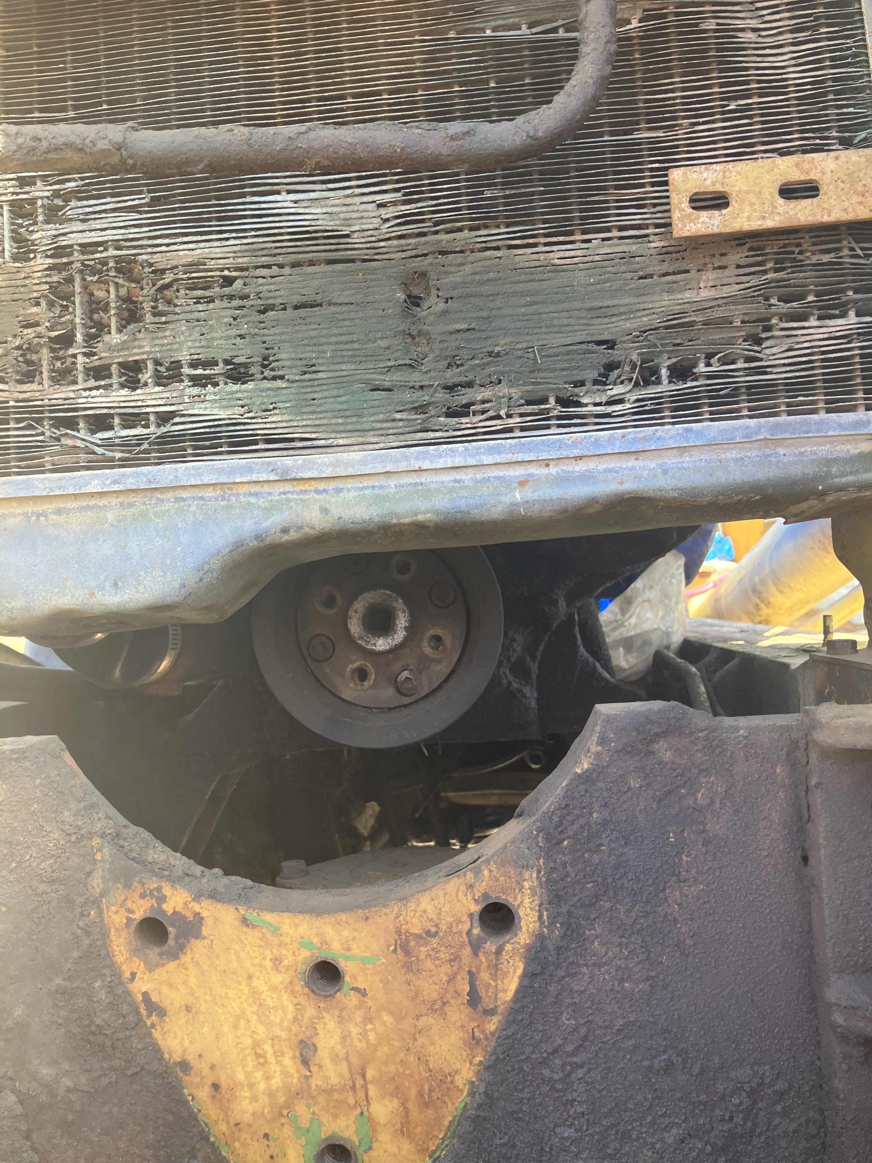

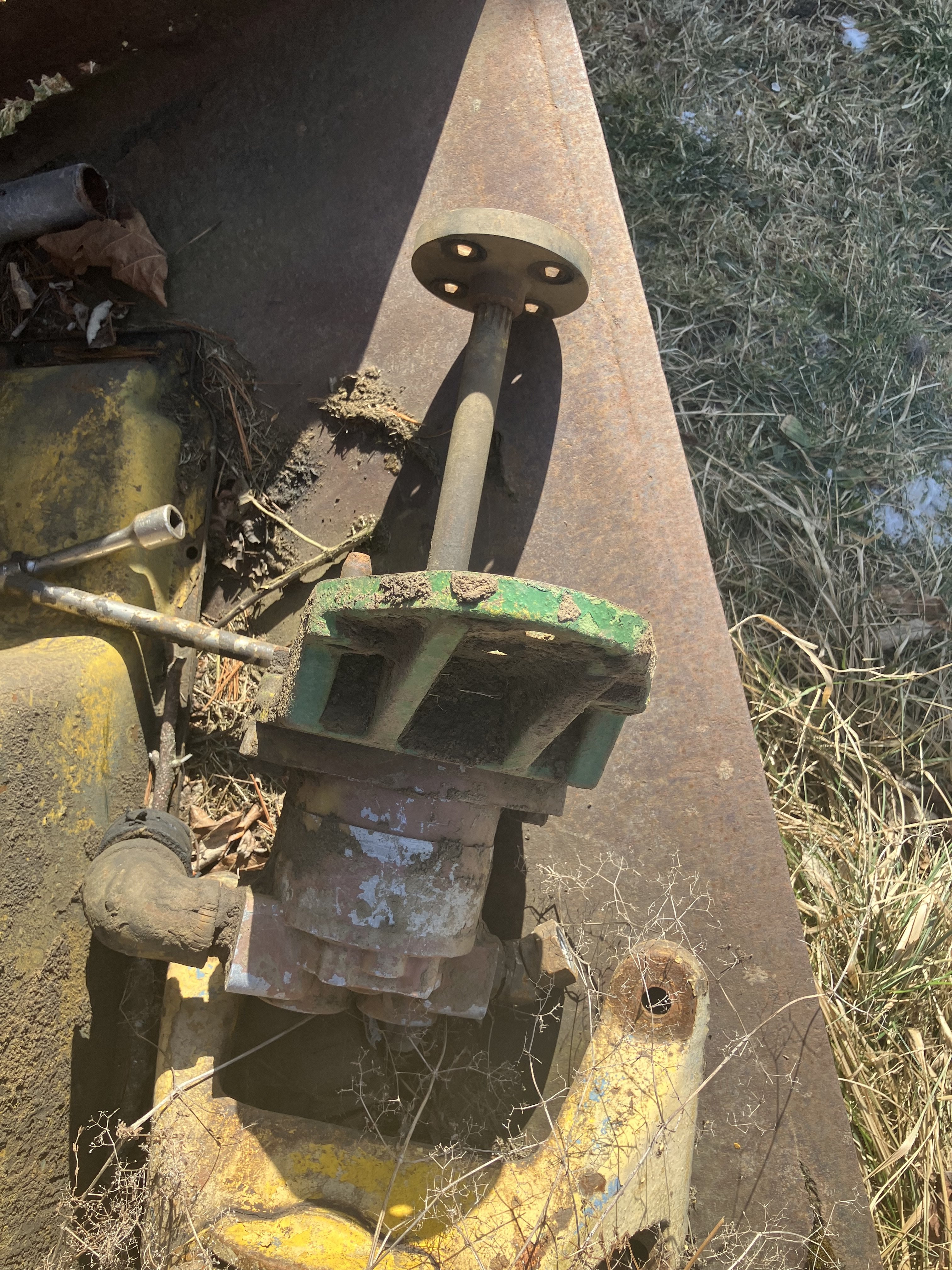

Don't know about Olivers', but on our Ford backhoe you had to remove the pump. When we did it, we tied a second belt in place for future failures. You can also cut the old one to remove and install an Adjustable Link V Belt.
On mine there are four bolts that hold a drive hub to the front crankshaft pulley. I just take out the bolts and slide the hub forward enough to get the belts on.
