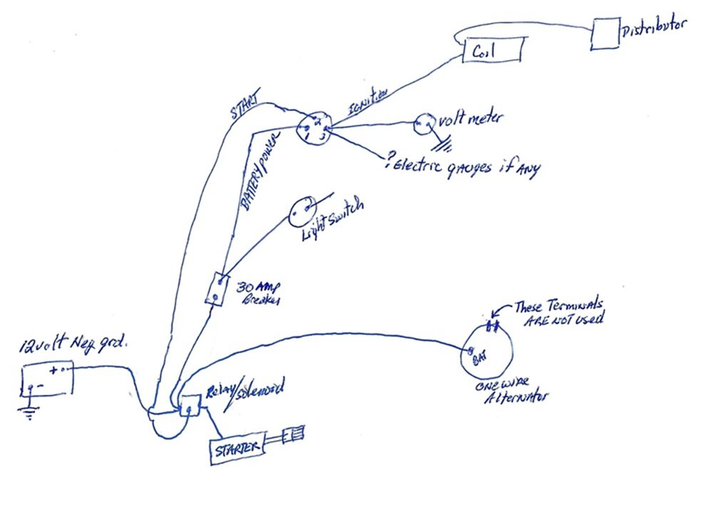

Is this the same Oliver 500 you were having wiring issues with, in the spring of 2015? If this is the same tractor, from that thread and with the issues in this thread, swapping to an alternator and doing a full rewiring would look like a good path forward. I mentioned modifying the original wiring diagram for you, however reading through 2015 thread it already has had several modifications (such as it now uses a key switch and solenoid for the starter and gauges have been replaced) that need to be confirmed to make a diagram for you. It looks to me like just scabbing in an alternator is not a long-term cure of the electrical problems. Here is a link to a thread you had about it back then.
April 2015 Oliver 500 thread

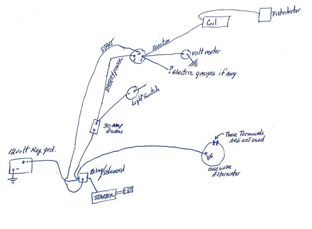

It would seem like this sketch would get you going with a one wire alternator. I would remove all the old wiring (outside of maybe the lights) and install new wires. 10 or 12 gauge between the solenoid and alternator and 10 or 12 gauge between the solenoid and breaker. For everything else 14 gauge will be fine.

Long term or short term, if you want it dependable the fix is the same as far as I see it.

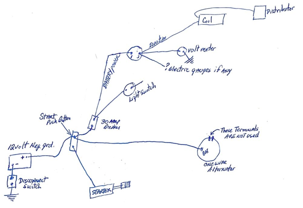

Strip the old wiring off, install the alternator, install new wiring and a battery disconnect switch on the negative battery cable. Turn the battery disconnect off when it is setting to eliminate the chance of stray discharge and fire from a short.
Here is my sketch with the push button switch instead of a solenoid for the starter.
