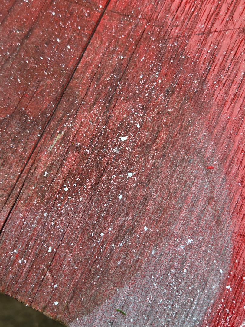

i have a 1 gallon galvanized gas can that i bought new around 1969. it has been stored for a looonnng time. no rust inside but when i shine a light in it it has some white dust & flakes in it . it looks to be galvanized on the inside as well. what would clean out this residue. i had an old outboard gas tank that had some rust on the bottom. i put 2 tubes of daisy bb's in it & let it ride in my truck bed for a month. cleaned it right up but that won't work in this case. here's what i shook out of the can.

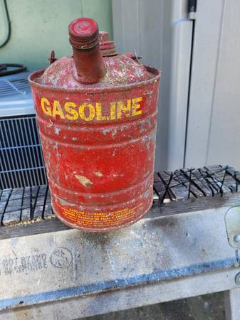

photo is of a similar can.

I would rinse can out with gas several times and then use it but monitor for flakes using a strainer till confident , problem solved.

The white specks look to be the remains of ethanol gas left in the can. If it were mine i would clean the outside of the can and put it on the shelf never to be used again. Then go get myself a new plastic can. Problem solved.
this can was used well before ethanol was even thought about. if there's any fuel residue it's lead.

i around 2 cups of 1/8" to 1/4" pea gravel into this can & shook it. made a game of it & let 2 great grandkids shke awhile too. rinsed it with water most loose flakes were gone. then i got the proverbial wild hair & put a product called evapo-rust in in.. didn't have enough to fill it so let it sit a few hours, laid it on it's side & rotated it it whenever i remembered to until all of the inside was covered. rinsed it with water, let it dry, & it came out super clean. super clean. i'll still use a funnel with a filter but i'm glad to have resurrected this old can.
