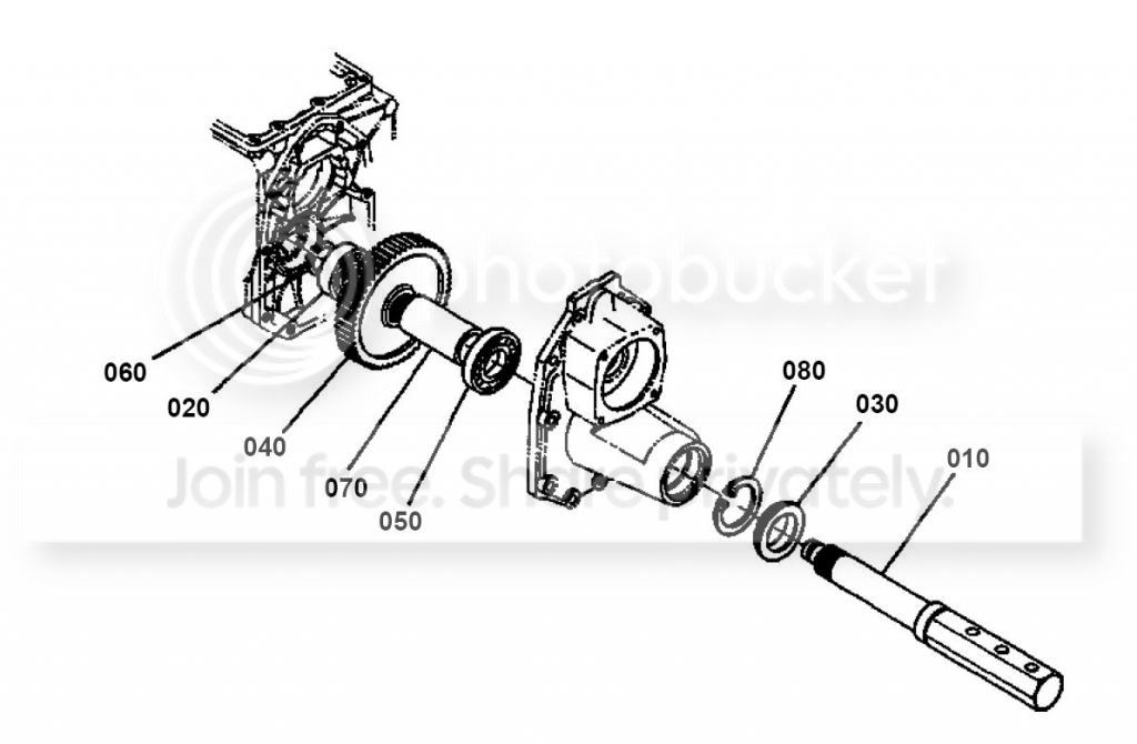

"My B7200 does have spur reduction gears on the rear axles."
Does that give extra ground clearance? I was looking for something that could straddle a single row of vegetables.
I sold the 6000s back in the eightys. the tranys were noisy when new, and yours looks almost new. dont worry, be happy. ccw pto, we sold them with woods mowers made for them.
(quoted from post at 18:47:17 08/14/13) "My B7200 does have spur reduction gears on the rear axles."
Nope - it's a pretty common design on modern tractors and is just a way to further reduce the ring and pinion ratio. Here is a parts diagram of the outer axle. The large spur gear (40) is mounted to the the outer axle (10). An inner axle and smaller spur gear (not shown) comes off the differential via the the openings above the outer axle shaft and drives the larger gear producing something on the order of a 2:1 speed reduction with an attendant increase in torque.
TOH

TOH,
I may be hearing the spur gears you show above. I
jacked up the rear end of the tractor and rotated
the tires by hand. I heard some noise, but it
didn't seem like anything to be concerned about.
I'm going to take 47fivewindow's advice to drive
it and be happy :) :)
